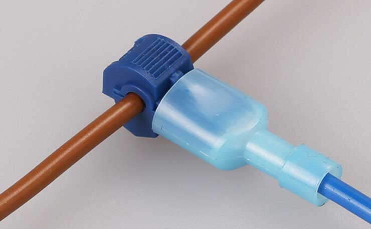

  5. Quick update guys! I have finished the installation, routing the cable and drilling holes was easy as well as removing the rear bumper. But the hard part for me is connecting to the fuse box. Just to be sure, you only connect one cable to the fuse box? Not two? ( One positive and one negative) And you have to tape it on an existing cable (if you don't want to add a fuse) . Since I have no extra fuse, I have connected my harness to the black/grey câble position 30 like indicated on the installation manual. Now that everything is connected, I have tried to configure with vcds (easy part for me..) But my controler is not responding. I think my câbles are not properly connected. How Can I check that everything is good? Any suggestions @wirer? Thanks guys.

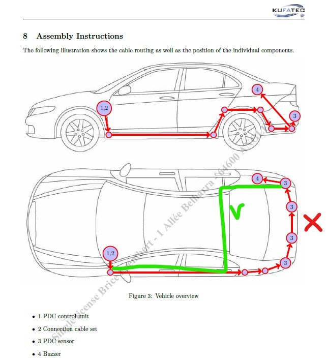

  6. Hi Guys, Anybody here has the bad luck to have a Fabia Mk3 without rear PDC? I need to have at least rear PDC for this car and i'm looking to retrofit them. So far, I have looked all over the internet and have reunited a list of links and articles that talk about it, and I've come with a parts list and an installation procedure to do this retrofit and most of the informations I need, however since there is no complete guide and I think I won't be the only one looking to do this retrofit, I've decided to write my own and share it to the community. I would need help from those who has already done this, or have it from factory in their car. If possible Especially with the VCDS coding. Following this parts' list: https://skoda.7zap.com/en/cz/fabia/fab/2016-797/9/919-919055/#18 I should have everything I need (except the central harness, which I've found on kufatec and other websites). So far, I have ordered some parts on eBay, others on skoda-parts and few on aliexpress. Please let me know if I'm wrong somewhere! - 5Q0 919 283 F - control unit PDC (only rear sensors, cheaper and enough for me, I don't want front PDC capablity) - I've found the "F" version on eBay at a very cheap price so I took this one instead of the "D" is it a problem? - 6V6 971 065 - cable to connect sensors into the rear bumper and under the back seat 10x - 3D0 971 838 L - cable tie with terminal socket (to fix the rear bumper cable in place) - Internal harness custom (3 sensors for Fabia Mk3 on Kufatec: Cable set PDC control unit - central electrics - only rear for Audi, VW, Seat, Skoda MQB, Version 3 : item number 39658-8) https://www.kufatec.com/en/assist-park/park-assist/cable-set-pdc-control-unit-central-electrics-only-rear-for-audi-vw-seat-skoda-mqb-39658-1?number=39658-8 3x - 5Q0 919 2753 - rear sensors 3x - 5Q0 919 133 9B9 - O ring sealing joints for sensors - 6V9 919 485 - Rear Left sensor holder - 6V9 919 485 A - Rear Center sensor holder - 6V9 919 486 - Rear Right sensor holder - 5Q0 919 279 - rear speaker 2x - N 038 501 2 - Plastic Rivet A6x12 I've found a PDF doc that explain the whole process here: http://skoda-zubehoershop.de/media/pdf/e8/3d/3e/6V0054630.pdf (I've attached it to this post in case the link goes down...) Now I'm waiting to receive all the parts I've ordered During this waiting time, anything you may think please do not hesitate to share it! Any help would be apreciated since this is the first time i'm trying to do such a big modification Thanks for reading 6V0054630 rear parking sensor wiring_compressed.pdf
