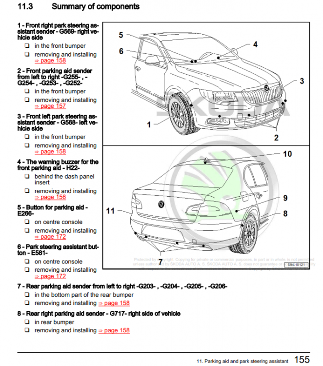

  1. If anyone else has problems with this - here`s where you can find it:
