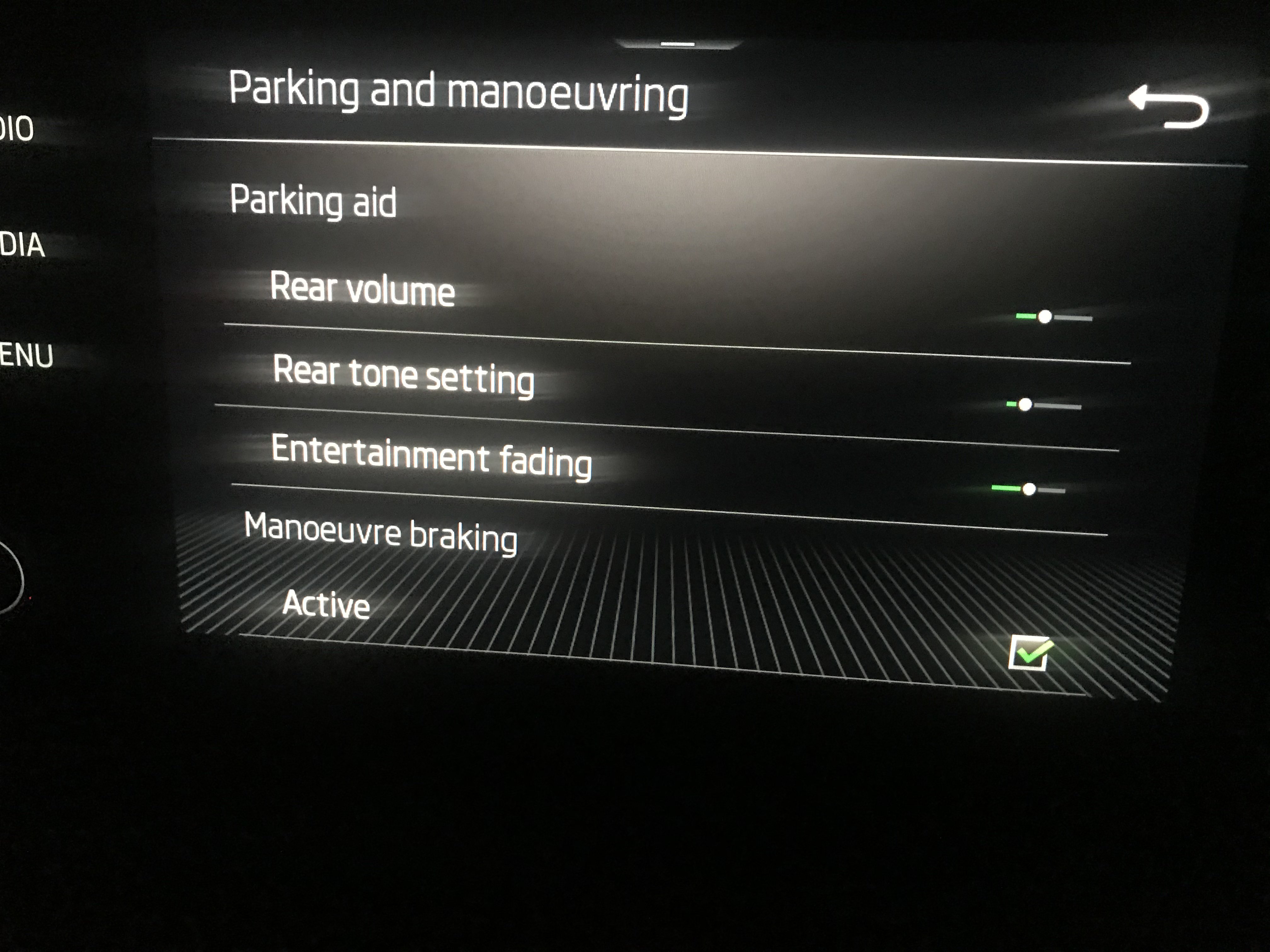

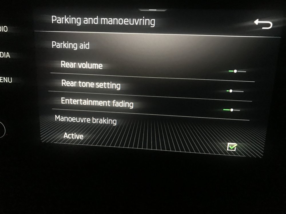

  7. Thanks for your replies. This is the option in the menu and you can then also turn it on/off when the park distance is displayed in reverse gear. Managed to get the WLAN on again, but only lasted a short while and it turned itself off and won’t turn on again.
  8. I'll take a photo later of the settings and display, maybe it is something which should not be active on my car but is in the menu anyway.
  9. According to the manual and menu options, it has something called manoeuvre braking ?. You can turn it on and off in the settings menu, is this something different ?
