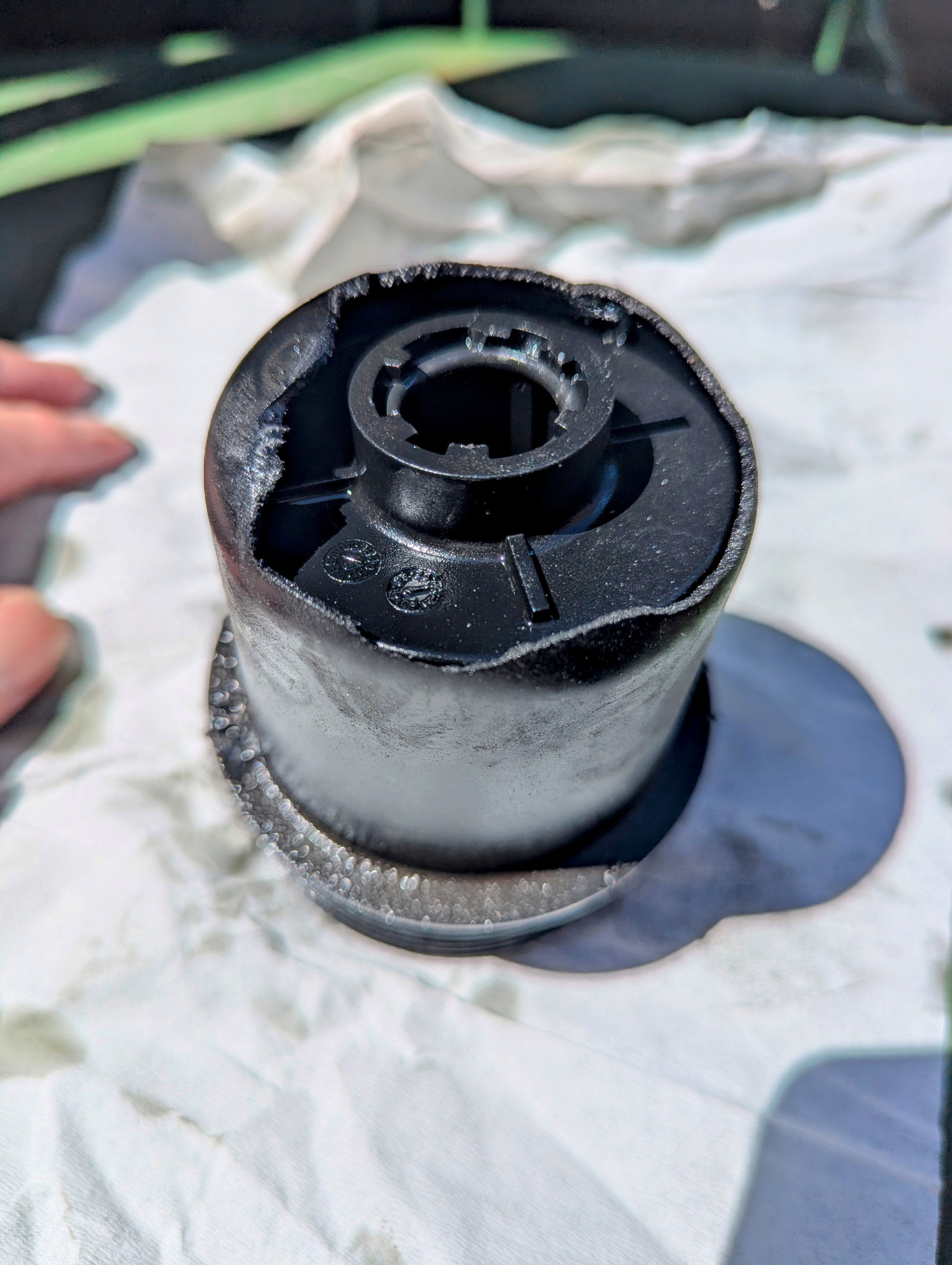

  1. Yes, it's the transmission oil filter housing with top broken off. Heaven knows why but quite frankly I'm just glad it's a straightforward fix. Oil and filter are freely available, this housing is dealer or specialist only but hopefully getting one on Monday 👍
  2. Don't need to be a DSG expert to spot the problem here 😉 Like I said, sudden catastrophic loss of oil. Easy fix anyway. Thanks for the comments 👍
