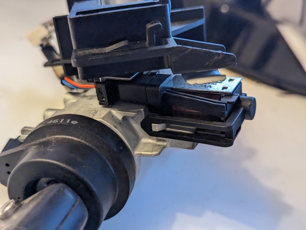

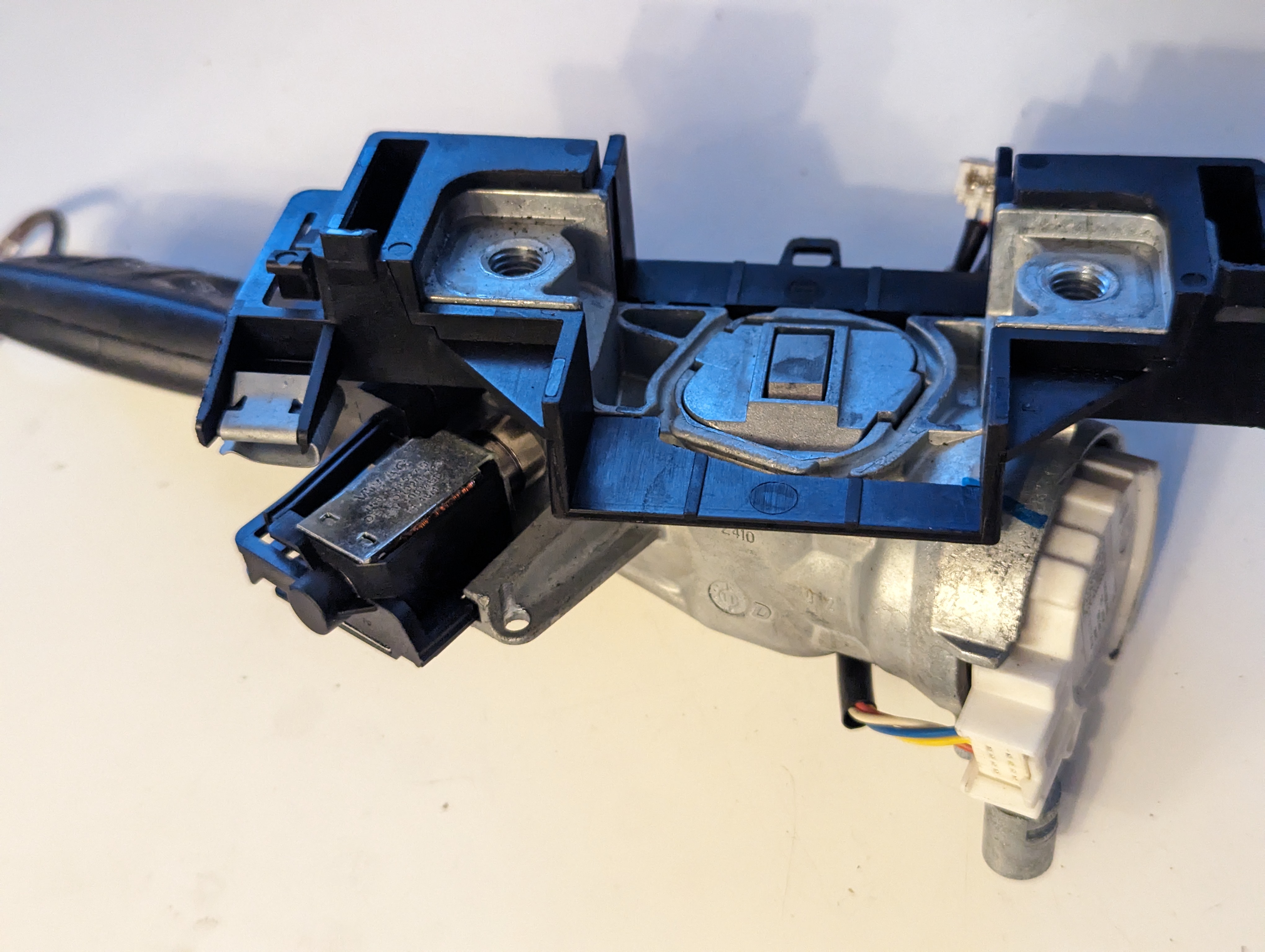

  5. Slight update on this. The Amazon special ignition I bought on Prime is starting to play up. When you remove the key the ignition doesn't actually click off without having to twiddle the end of the ignition barrel. Figured I'd just bought a cheap nasty aftermarket barrel, so I've bought a used ignition from a Skoda breaker that is much much smoother than the junk tier one I bought. However there is one slight difference, it appears to have an extra solenoid on it. From some Googling it appears it's from an automatic car and is to stop the key being removed until the car is in park. However my car being a manual I guess I can just leave it disconnected and it will not cause any issues? Could remove it completely too.
  6. All fixed. The ignition switch it self appeared like it wasn't clocked in the right position, so wasn't sending a signal. Reset it, checked it with a multi-meter, and re-assembled and car now starts! ESP light has gone now too, I think that occurs when you disconnect the battery and it goes off after about 100 yards.
