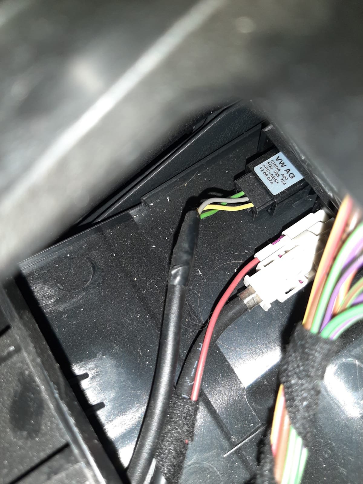

  6. Ok, but the newer version that is designed for carplay should solve the problem, right? The cable is prepared with 2 aditional wires, as you can see in the photo I have posted before!

  9. I have tried 3 cables, the result is the same! My Skoda is from 2013, I think that te usb port is the first model, because it's very small compared to the one that suports apple carplay. I think that upgrading to a newer model of usb port will solve the problem, but I want to be sure, before buying a new port. Thanks.
