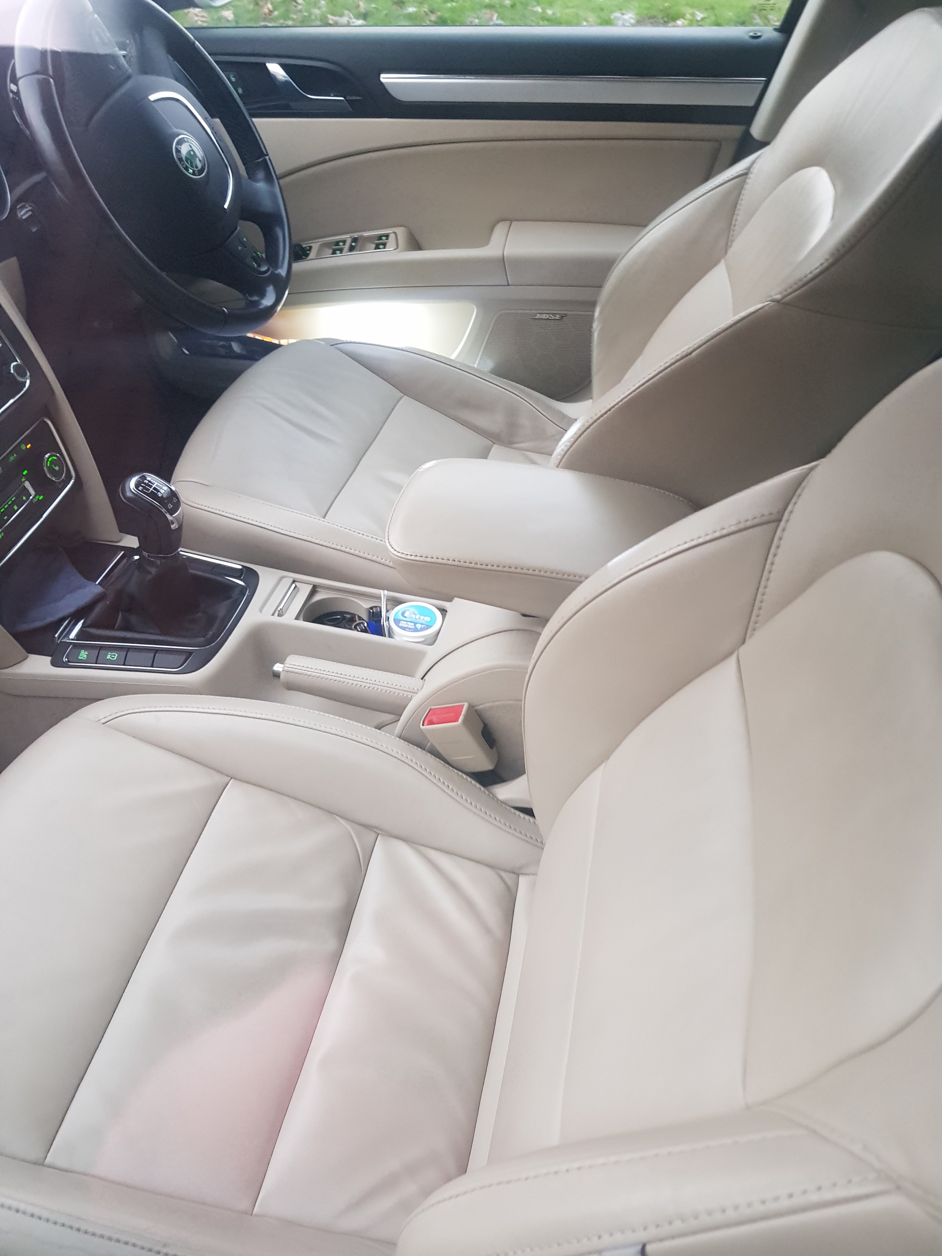

  3. Wires are fine no additional heat. The cool white is to bright going to change to warm white.

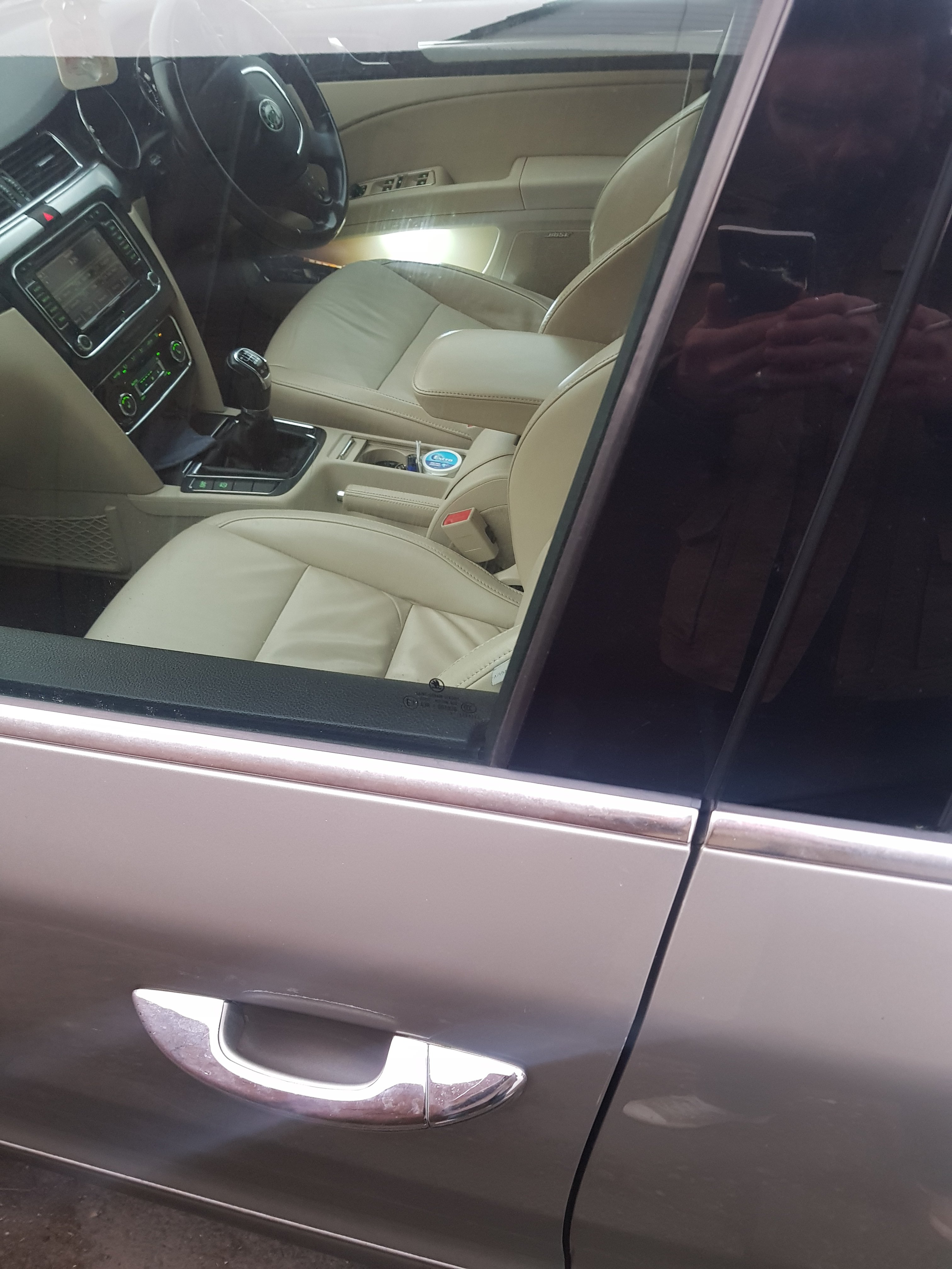

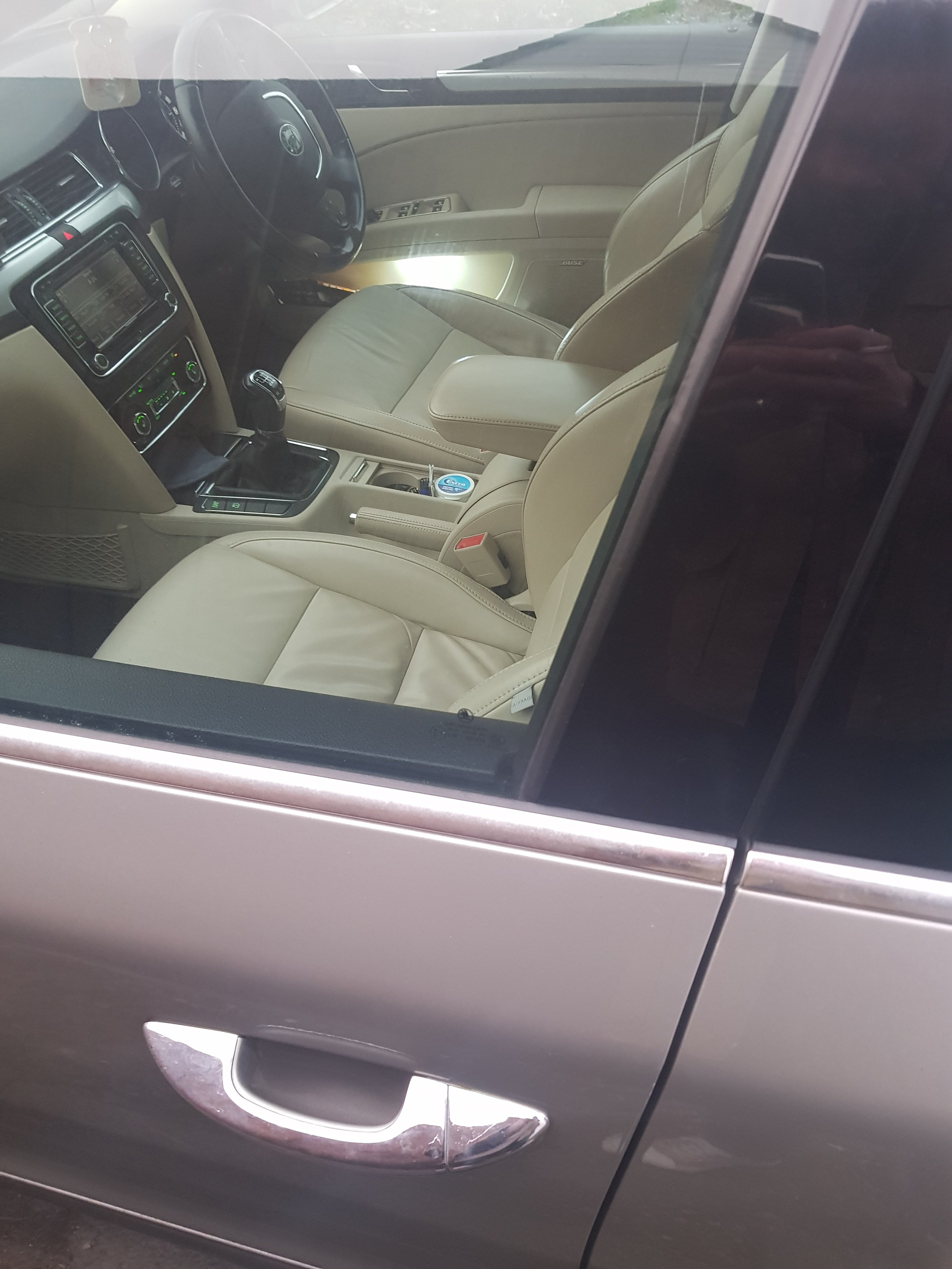

  4. Hi fitted today and works fine, used cool white but will change to warm white. Will do the other doors later and add a photo later of the one I fitted today

  6. Thinking about fitting led strips to door cards and was wondering if I could hardwire them to the wire for door handle lights.
  7. Hi any thoughts. Thinkinking about adding ambient lighting to door cards with led strips. Would it be possible to hardwire the strip to the wire used to light the door handle.
