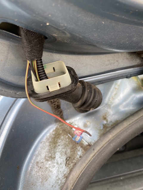

  5. Bloody boot switch! So, the boot opens with the key fob but not with the switch! I replace the locking mechanism but didn’t fix it, I have just replace the switch but that hasn’t fixed it. what could be the reason the switch isn’t working? Is it a common occurrence? Cheers

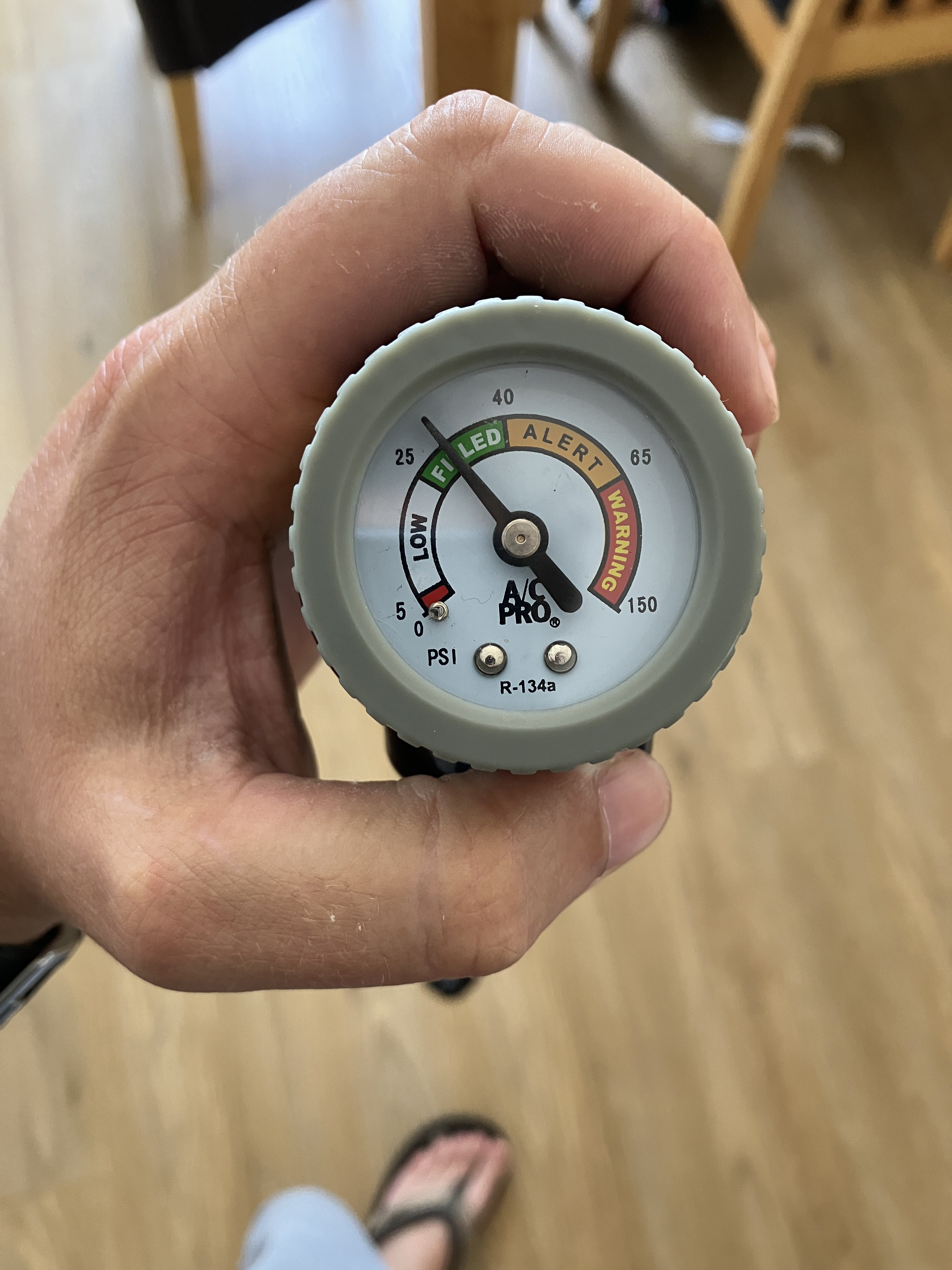

  10. Hi JR yeah it’s not full at 25psi the bottle ran out and couldn’t put anymore in, it’s between 25 and 30psi. the pressure gauge has a good ( green area ) between 25psi and 40psi I did the Hilux first and got that one up to 30psi then went on to the Skoda, I would have put more in but the canisters empty now it felt like there was more in there but I was mistaken. most info online suggests a different pressure depending on the air temp so I guess recommended PSI would depend on what country your in? just been out in the Skoda and it working as it should now and even the metallic noise from behind the vets is almost gone completely! Bonus! I appreciate its not a full empty, clean and refill like a garage would do but it seems to worked great on a DIY level. All the infos on there website https://www.acprocold.com/uk/ and it’s got pretty good reviews over at Halfords https://www.halfords.com/motoring/engine-oils-and-fluids/air-con/ac-pro-auto-air-conditioning-recharge---gas-r134a-264627.html?
  11. Yeah right on! I cleared the codes prior to filling, the gauge on the fill kit showed about 5 psi before filling. The fan at the front of the engine bay started up at about 10psi then it was full at 25psi. I was dubious about Halfords kit but am impressed so far, very easy to do and clear video instructions on YouTube.
  12. Update on this one. I picked up the AC pro kit from Halfords this morning and the car is now blowing nice and cold again! Woooo! Had enough in the kit to do both the Fabia and Hilux and it still feels about half full so it’s got another go in it still! il update again if it fails and goes warm but if it don’t update then assume it’s all good. thanks again for the replies ✌️
