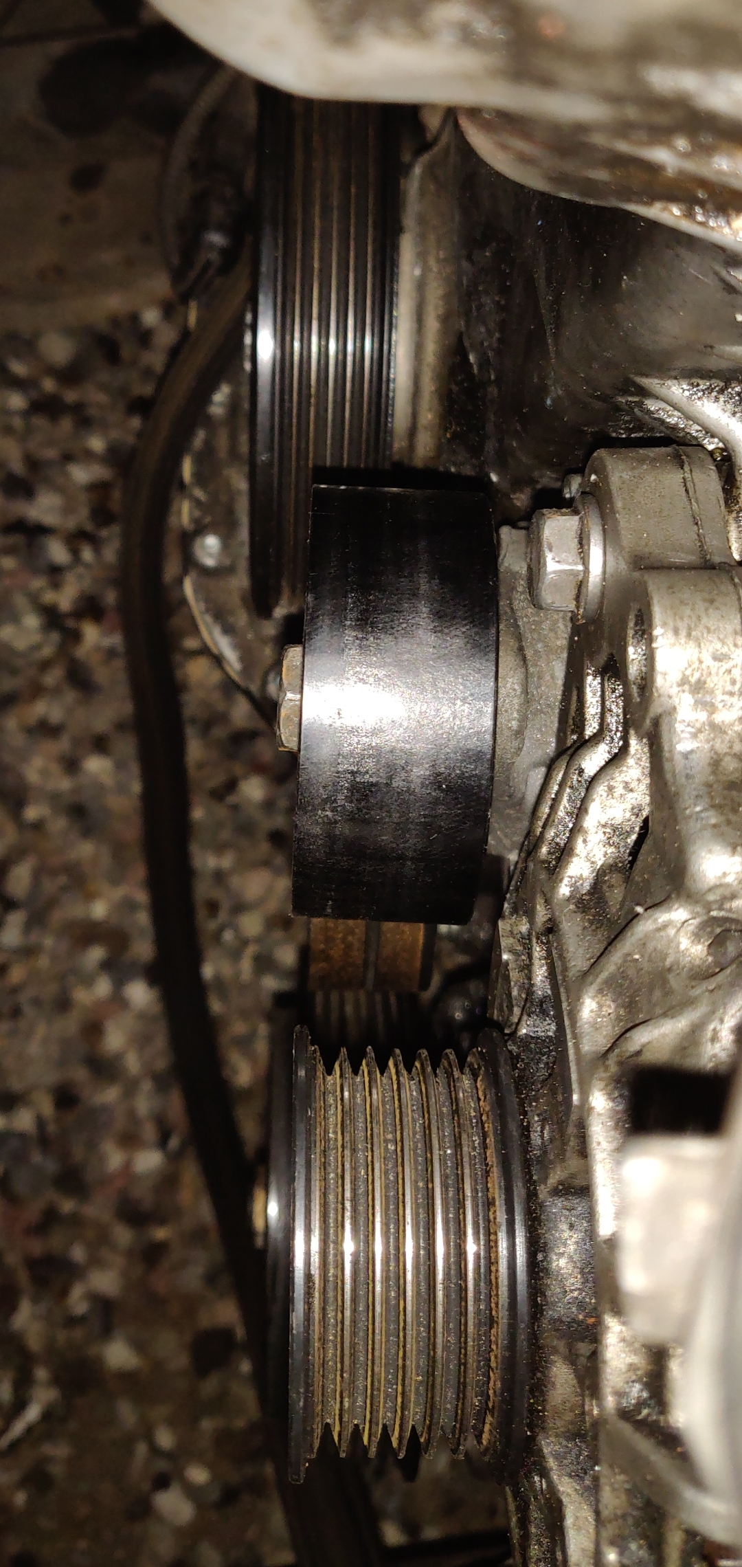

  4. So i have replaced the chain. Still not started the engine though, as the serpentine belt seems to be coming of. So I am not comfortable with continuing to attempt to start. It looks as if the tentioner is the culprit. Can anyone confirm from the picture, that the tensioner needs replacing or is it positioned normally like that?
