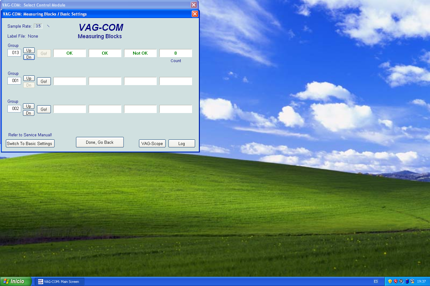

  7. But my trunk button in group 13 shows "ok ok not ok 0" and yours "ok ok ok 0" so the algorithm is not okey for me and i do not know what that means
  8. I have checked several things: 1º) If i check the 13 group and i press my old 2 button key it shows "ok ok ok 2" and if i do the same with my new key it shows "ok ok not ok 0". I do not know if this means something. 2º) If i check the 14 group with my old key(2 buttons) it shows a 1 for each button as long as i press the button. But if I check the same with the new key the 0 change into 1 only for a moment just for a moment no matter if i keep holding the button down and if I press the trunk button then the third zero change into a 1 but the same as the other 2 buttons, only for a little moment no matter if i keep holding. I think you are right and my key is very cheap perhaps or maybe is not the right one, maybe someone could say me a good place to buy another one?

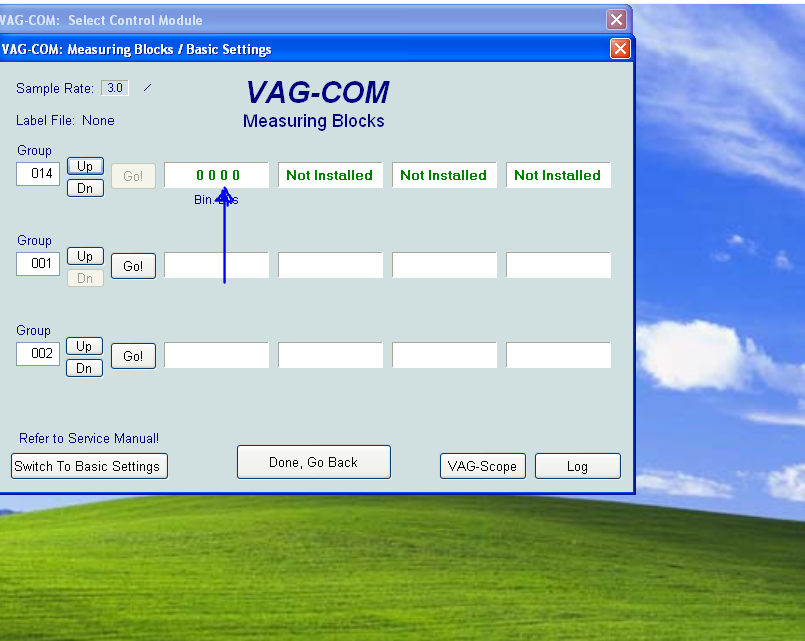

  10. I checked the signal in the vagcom and it shows 0000 and when i pressed the buttons a 0 change into 1 in each case but i do not know if that is correct because there is one 0 which not change (because there are 3 buttons and 4 zeros ) and maybe it the one which opens the trunk.
