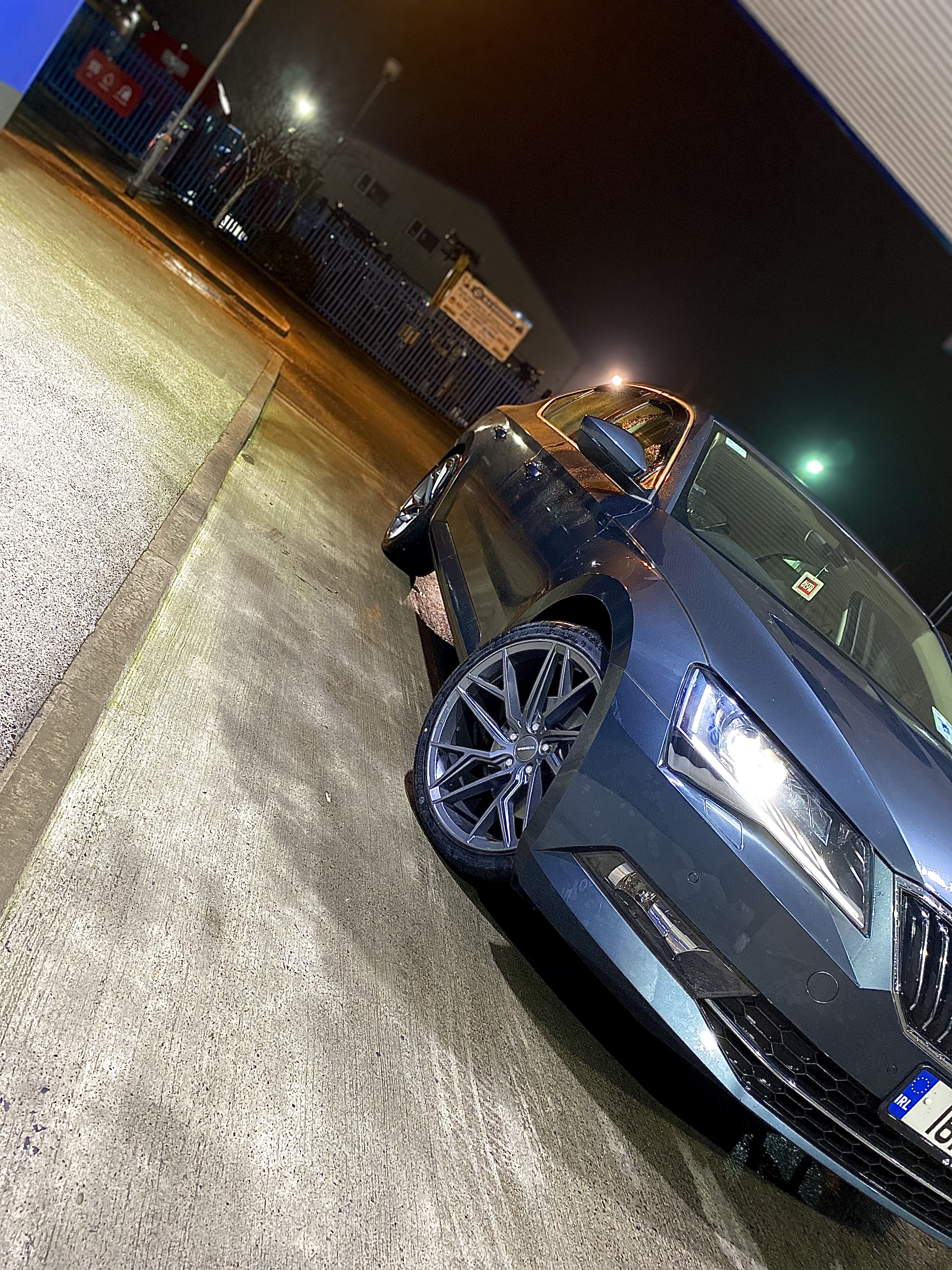

  1. I was nervous on if it would fit or not on the front with the 9.5 , I didn’t want to use spacers. I done a bit of research on them and sided on a more negative approach to them. Luckily I didn’t need them. I went with the 255/35/19 because it has a very slight stretch on the tire giving it a slimmer look without having to comprise ride quality. A few friends of mine are running 235/35/19 and for the price of the wheels I thought it would ruin them. And to answer your question it’s a ET42.
  2. Thanks for the reply , all went perfect with the fitting no spacers needed straight on running 255/35/19 x 9.5j all round . Looks amazing 👌🏻
  3. Hi , I purchased alloys for my Skoda Superb MK3. They run 9.5x19 all round. I have them on 255/35/19 set to fit tomorrow will I have problem with fitting the front? Not sure if I should have gone 8.5 ? any help ??
