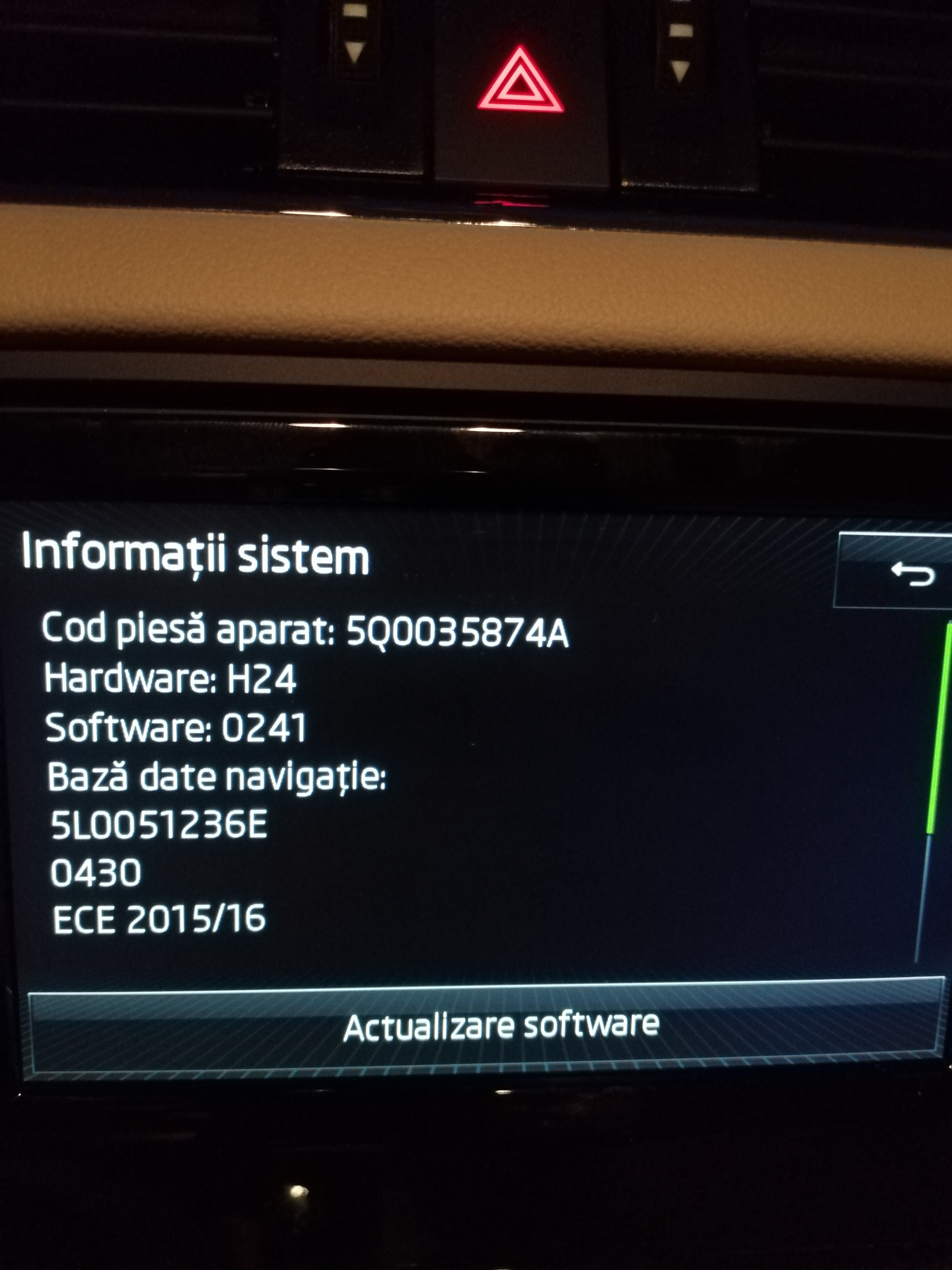

  1. Hi @pab567, Can you please help me with an update for my Amundsen MIB2 unit? I think last version is 0480? Thanks,

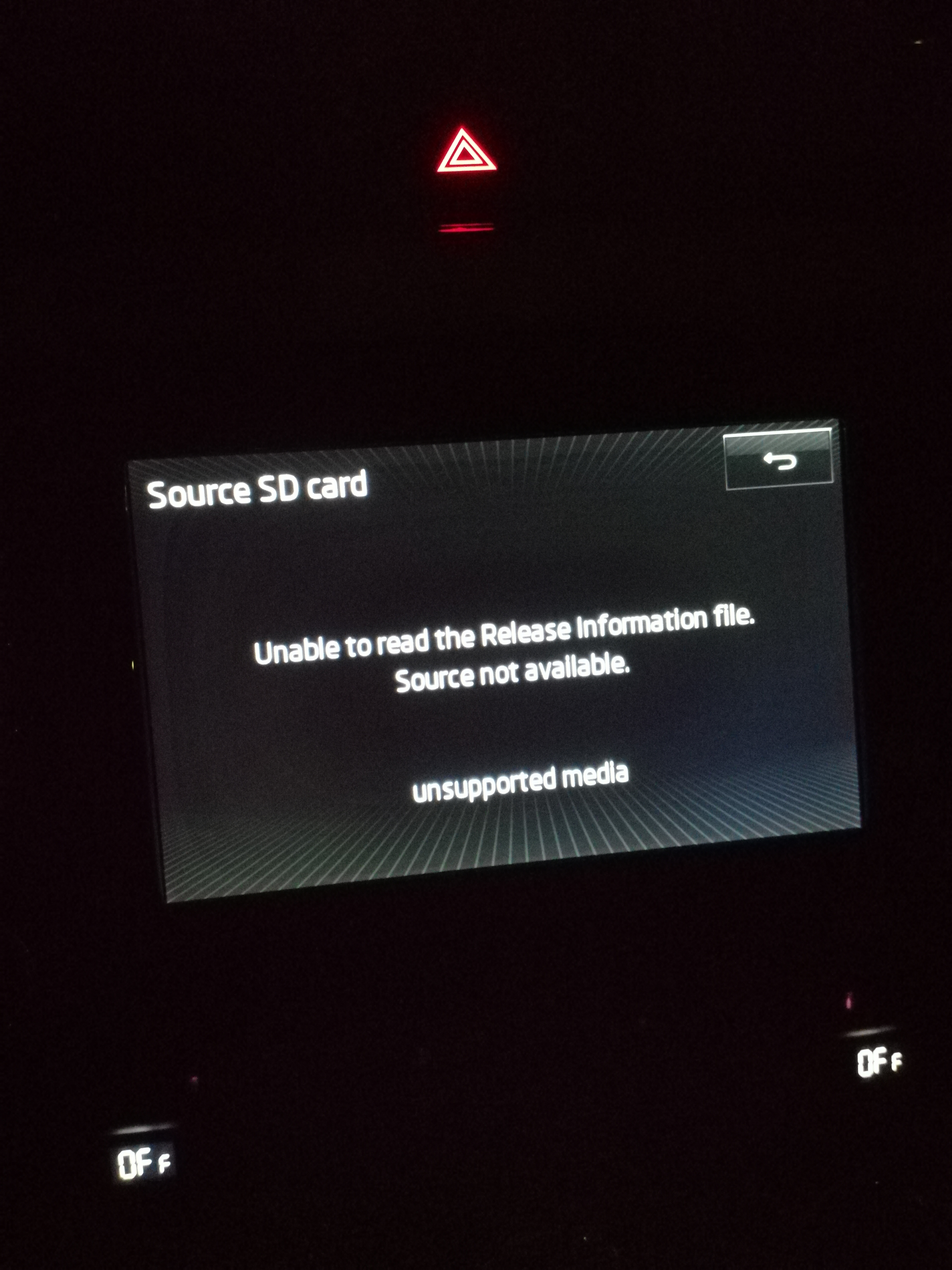

  5. I succeeded finally. I had to copy all the files directly into SD card. Before this, files were in a folder with the update name and thats why files were not detected by the unit. Thanks all for your help.
  6. Hi, Can anyone help me with this error? I try to update my unit and i get this error. I formatted SD card FAT32, put all the files directly into the SD card but same error. Thanks
  7. Hi @pab567, Can you please help me too with an update for my unit? Thanks.
