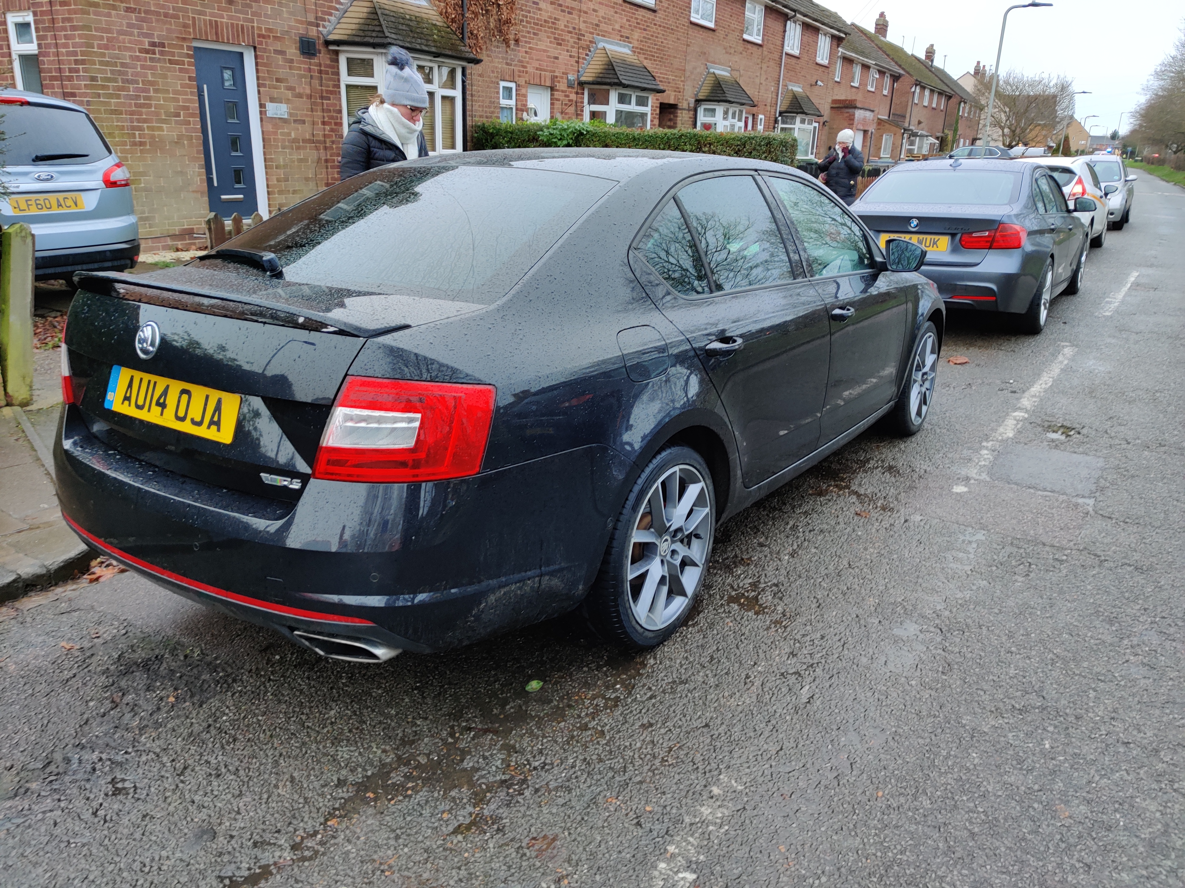

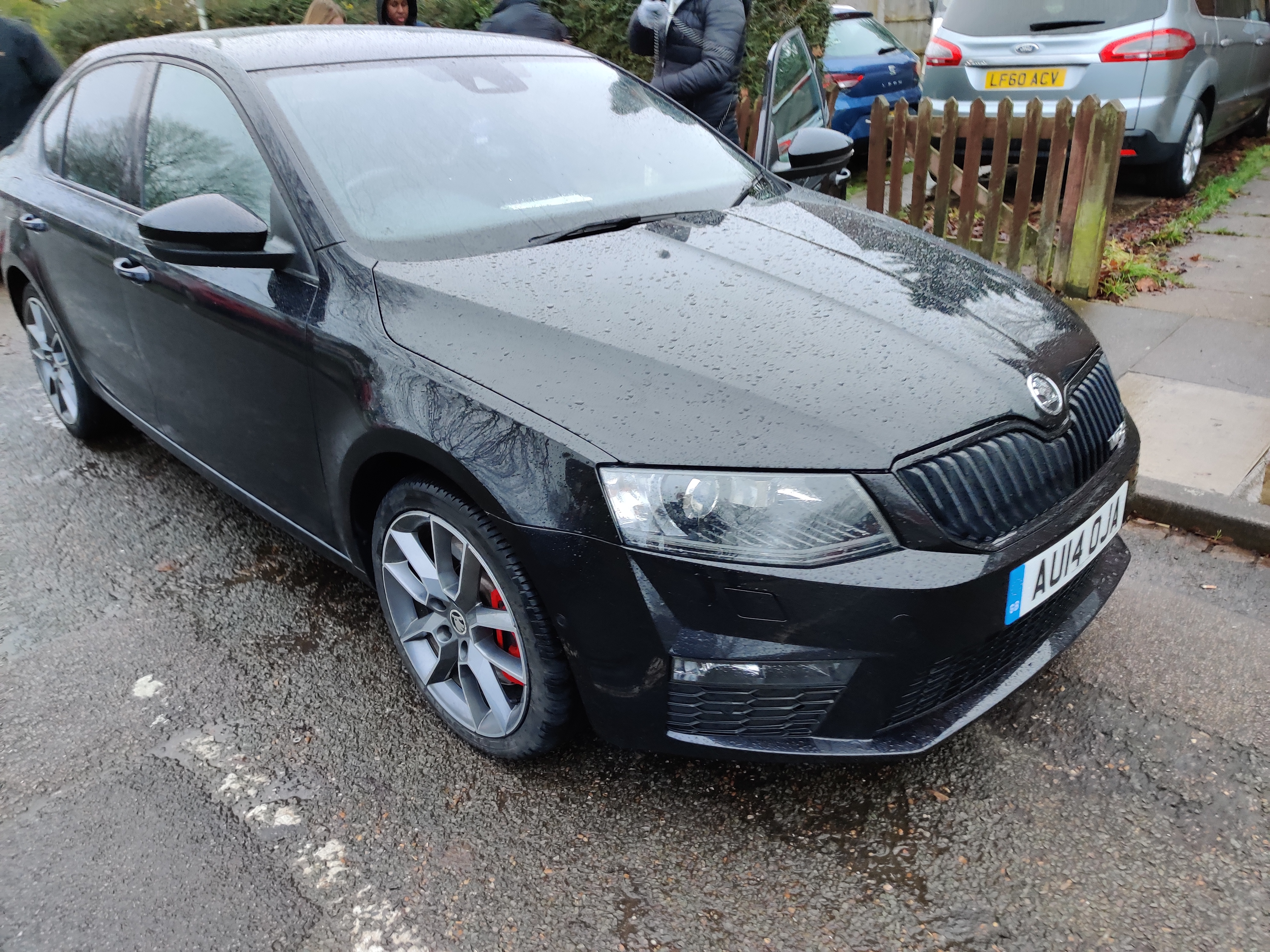

  8. Hi All, Coming from an Abarth Grande Punto recently purchased a Skoda Octavia TSI VRS MK3 with dsg. Car had 92k miles on it and I have already reached 93k in the space of a week 9 days. Car has been faultless and a completely different world from the Abarth in comfort, refinement, practicality (HUGE BOOT) and sheer pace. Already done a major service, dsg service, four new p-zero tyres and rear discs/pads (they were looking a bit sorry for themselves!). Looking forward to putting many more miles on the car and can see that I'll be keeping for the foreseeable. Anyway pictures below and off to the forums!
