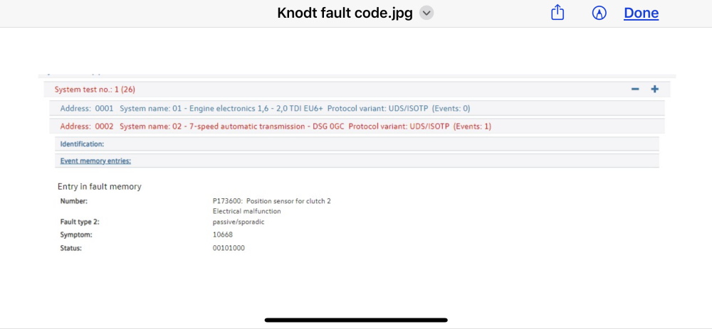

  1. Right I’ve just got my codes through for the fault on my DSG, and I’m also waiting to hear back from Skoda UK customer services. I’ll keep you posted.
  2. The technician I spoke to said it was not a common fault however I believe they are told not to admit liability or say it is a common problem as it give me ammunition for claiming that it is a faulty part. I know Aus / NZ had a recall on VW’s with faulty MCU however they claimed it was down to climate conditions, and would not do the same in Europe. I’m still waiting to hear back from Skoda with a list of the fault codes Shown on the Diagnostic check.
  3. Just found out it is a faulty Mechatronic unit. Is this a common fault on the DSG Transmission? Skoda have quoted me £1,400 to carry out the repairs. I’ve spoke to Skoda UK Customer service and they suggested I contact where I bought the Car from as there is no good will gesture from Skoda Norwich, understandably. mom waiting for a call back from the Sales Manager where we bought it. 🤞🏻

  5. FYI, Sorry for the late reply been tied up with other things. We have had the car for just over 3 years and it has done 49,900 miles.
