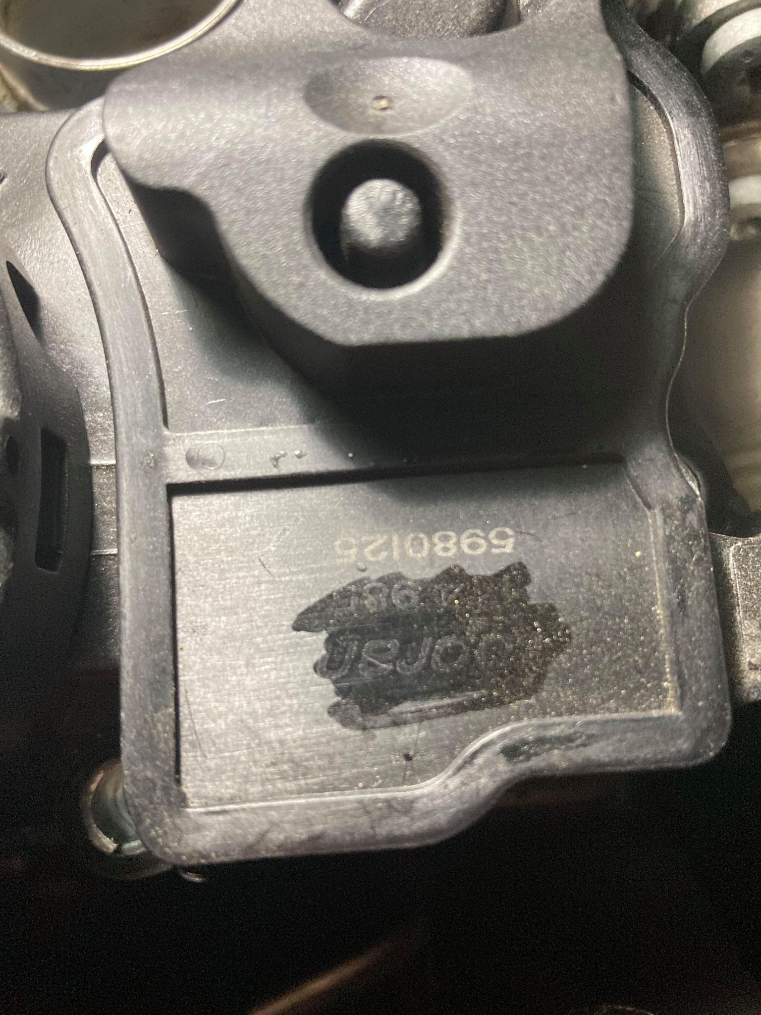

  6. Well.... Good News Bad News... I received a new PCV, the same Topran one from a different supplier which they checked was correct for the CDAA, came in a nice Topran box etc which gave me a little more confidence than the first label scrubbed out packed in a bag one... Installed it, on a friday arvo... Got a bit of smoke as to be expected with the amount of oil in the intake system, but by mid saturday and all weekend (about 500klms) she was clean of blowing smoke! Over the week I did about another 500klm and no smoke and no discernable drop in oil level on the dipstick! Awesome news! Then.... over the weekend it went from no smoke to the proverbial tone of smoke and the oil warning coming on over about 200km... So without yanking the PCV out again, I'm betting the new one's failed... F(*K! I've popped the front breather hose off and found oil... Haven't pulled the rear hose off yet (bit harder to do without pulling coils etc...) I doubt lightning would strike two new PCV valves like that, so I've gotta suspect something else is badly wrong and killing the valves... The good news is, while the PCV valve was functioning, I got no smoke and no oil usage, so that seems like a good sign for the internals of the engine...

  9. Hey @TheClient Thanks for replying I'm not sure what was in it previously as I didn't think to note it down before I threw it out (though I know it had been replaced some time ago (from the log book)) The part I was supplied (from Tooley Imports, Sydney) was a Topran 114 985 and since then I've not felt confident that it's the right one. They used my VIN to pick the part. When I search for it I land on https://runautoparts.com.au/valve-engine-block-breather-114736-114-985 which when I enter my model details it tells me it's not the right one... (not to mention $84 instead of the $130 or so I paid Tooleys) The genuine part number is 06H103495 so I take it that it isn't basically a matter of getting the latest revision for it? (AJ I believe?) and that it is a bit more involved? The other thing that concerns me is the Topran part number looks like it has been 'blacked out'... Best duck down to the local Skoda dealer I think...
  10. Heyo, My 2010 Octavia (CDAA 1.8TSI) was burning a fair amount oil when I bought it and it was suggested before we got too in depth to replace the PCV Valve. I ordered one, removed the old one and oil drained out of the breather hose, installed the new one and hey presto, smoke gone (after a few drives sucking the remaining oil from the intake hoses etc) Not long (maybe a month) after the smoke came back gradually and got to the point it was burning through a litre in about 200km! So I removed the PCV valve again and again oil drained out of both breather hoses and I found the small rubber valve/leaf and come out of the unit... Thankfully just sitting on top still... The 'lug' part seems not big enough to grip the hole it locks into, it goes in and doesn't fall straight out but just giving it a tiny lift pops it out with no resistance.... Anyways, I'm organising a replacement but also wondering if anyone knows something that might cause this to fail like this or am I just unlucky and I got a faulty new unit...? Thanks for reading! Side question, what's the best to clean the oil from the coil pack? The oil was weeping from the breather hose above one cylinder...
