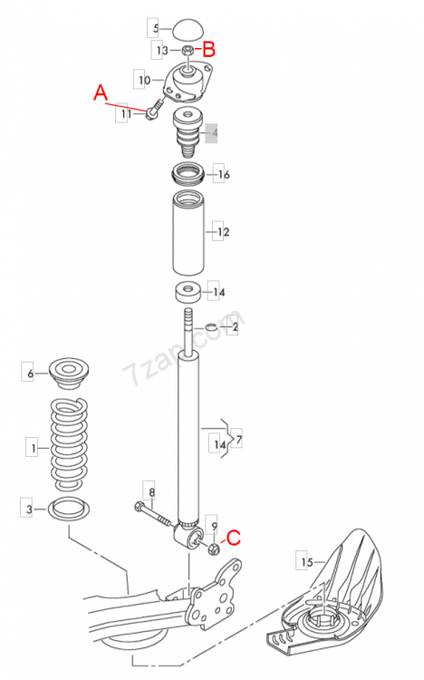

  6. Hi, I am going to replace my rear suspension buffer (?) I am looking for the correct torque setting for the marked bolts and nuts. Some websites specify the following: A: 30 Nm + 90° B: 25 Nm C: 40 Nm + 90° Does that sound correct? What does the +90°? Is it just 30 Nm and a quarter turn? Best regards Mathias

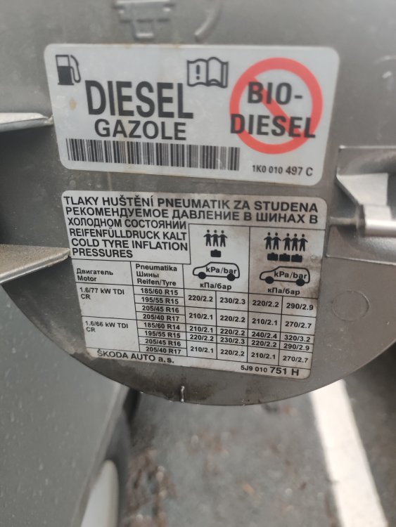

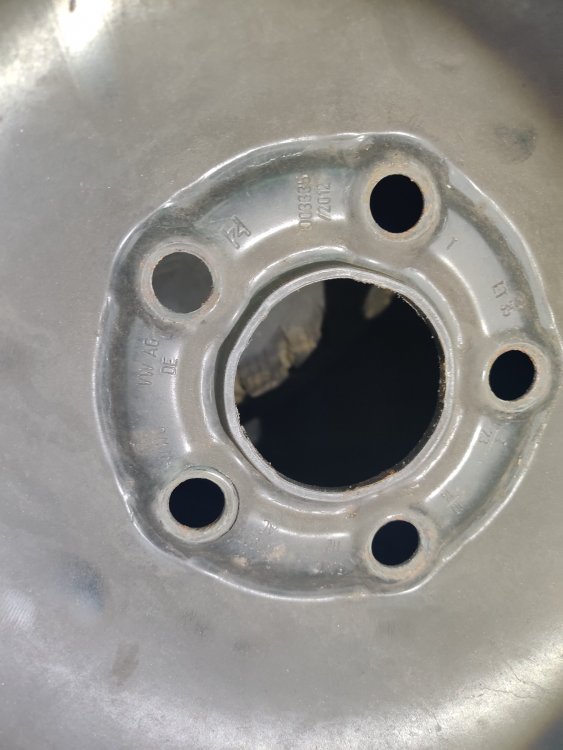

  8. It's a set with both tyres and rims. I have attached a picture from the fuel cap, the info on there is what made me wonder if they would fit. The rims are with 5 stud holes and ET 35 The rimes are both smaller and slimmer. But, as long as they are the same kind as the OEM I recon they will work just as good?
