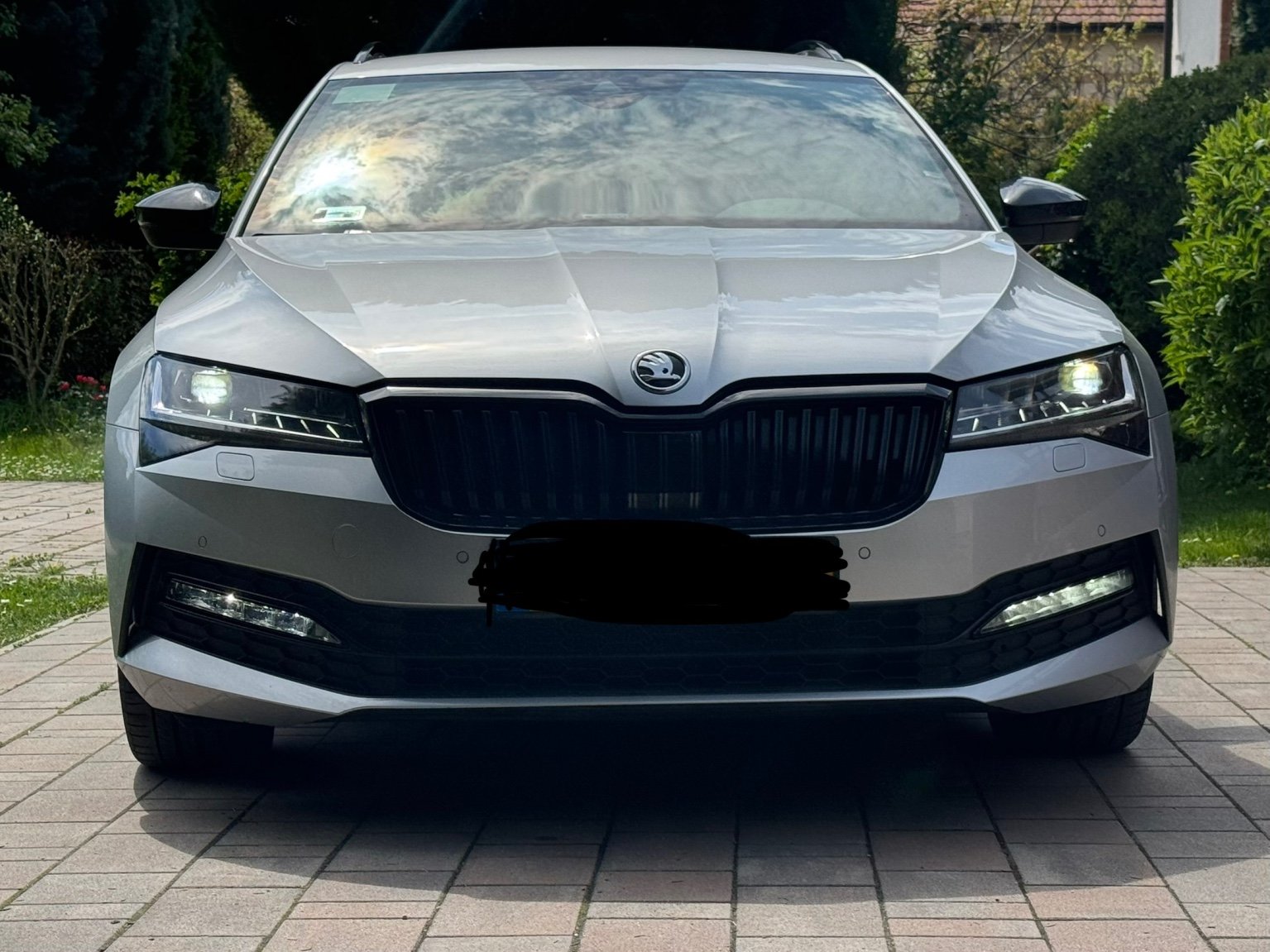

  7. Yeah so i bought two headlights with new oem numbers (2023) the driver site works well but the passanger side not do the calibrazion when i turn on the engine. There is not a single error or code in vcds. I went with it to my dealership but they says to me that the calibration motor get bed inside it.
  8. Hi guys! So i had to replace my 2020's matrix headlights because of an incident. The newer ones are made in 2023 with a new oem number. After the replacement i noticed that my right one is not doing the calibration when i start the engine. ( I mean there it goes a bit down than goes back in that place when i started the engine.) After this, i changed the control modules of the headlights back to the previous one but symptom is the same. There is not a single error message, in vcds too.. Can someone help me with it? Thank you!

  10. Hi Guys! I changed my fog lamp in my 2020 superb fl because it was cracked. Bought a new one from aliexpress but it seems to be less brighter than the old one.( Only changed one side.) Main question is. Can i adjust the brightness with vcds? The left one is the new one.(in this photo)
