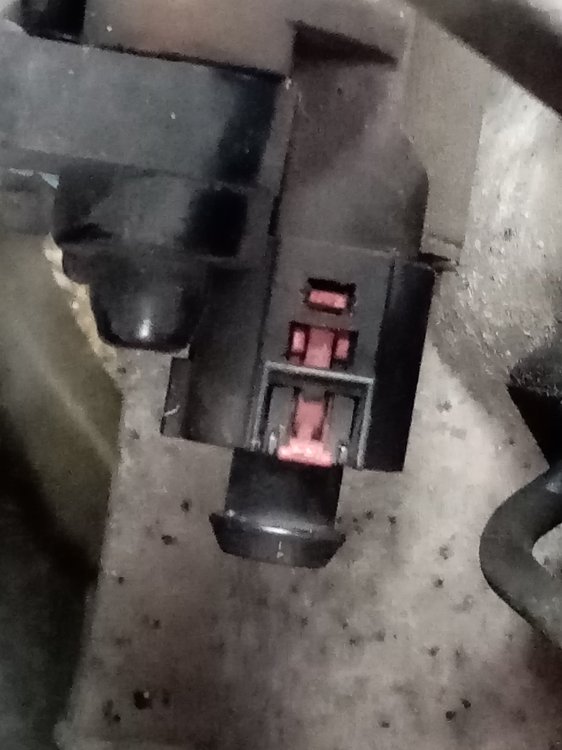

  3. We were lowering the passenger front window which went all the way to the bottom, accompanied by a horrible clattering. That was it stuck down, any attempts to raise it just produced the rattling. Luckily it was in the middle of a heatwave. Took the door card off and motor but can only lift the window up 2" to try to get to the clamps. There's a cable with a nipple visible loose inside the door by the locking button which is draped over a pulley (see photo, sorry about the socks). Any suggestions? Skoda Fabia Ambiente 1.2 12V (BME)
  4. Red clip crumbled away and pressing into one of the revealed holes with a little electrical screwdriver did it. All sorted.
  5. Whats the trick to getting the plug off with the red clip?
  6. Managed to make a good enough connection and get ourselves home. Will see about a new plug or just a spade connector.
  7. I just broke down with this exact issue. Happy to wait for Green Flag to come and look at it until the wait went from 15 to 90 minutes, then I started stuffing the bare wire end in but so far to no avail 😭

  11. Switch changed, not much improvement. Noticed light never comes on doing 65-70mph on A1 or main roads but does if revs drop below 2000 like taking a roundabout or side road. Blocked oil filter maybe time for a change, not sure when I did it TBH.
