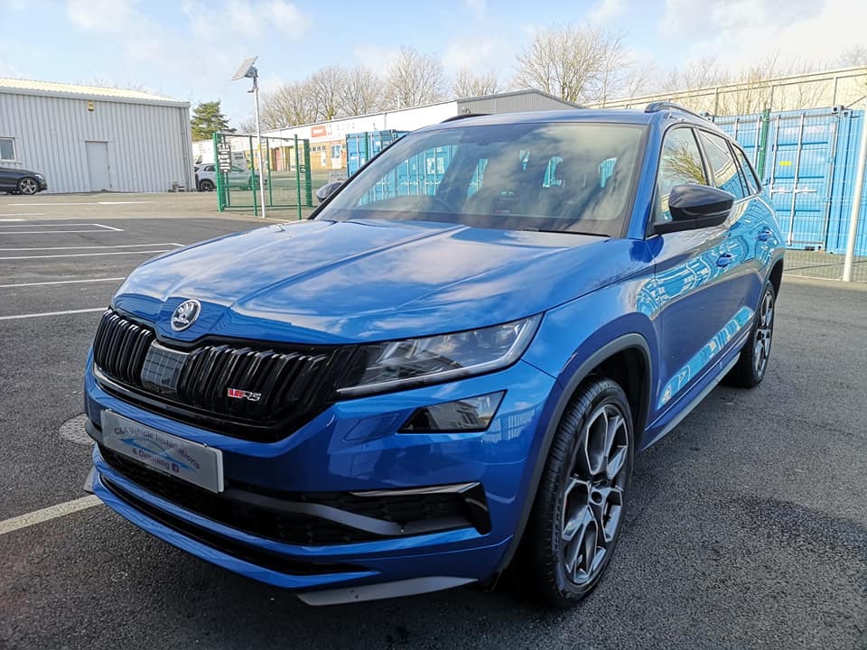

  1. Yes I did. It was a loose bolt holding the bracket to the water pump which seems a unique issue to the VRS.
  2. Thanks for the response. It’s definitely coming from inside the front nearside wheel arch/engine Bay Area.Hot or cold makes no difference.
  3. Good evening. I have tried searching so sorry if it’s come up before. One for the VRS owners! Has anyone had or is anyone having a rattle from the f/o/s of the car when under load? Dealer believed it to be tensioner and pulley issue which was changed today (both pulleys and the tensioner!)but the rattle is still there πŸ™ˆ All heat shields are solid.
