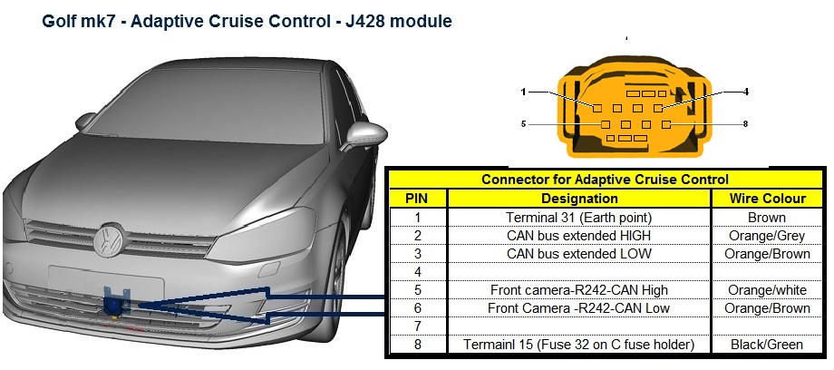

  1. power on the black/green and black/white wires? yes brown wires grounded? yes can bus high pin 2 can bus low pin 3 thx wery much this diagram corect without front camera

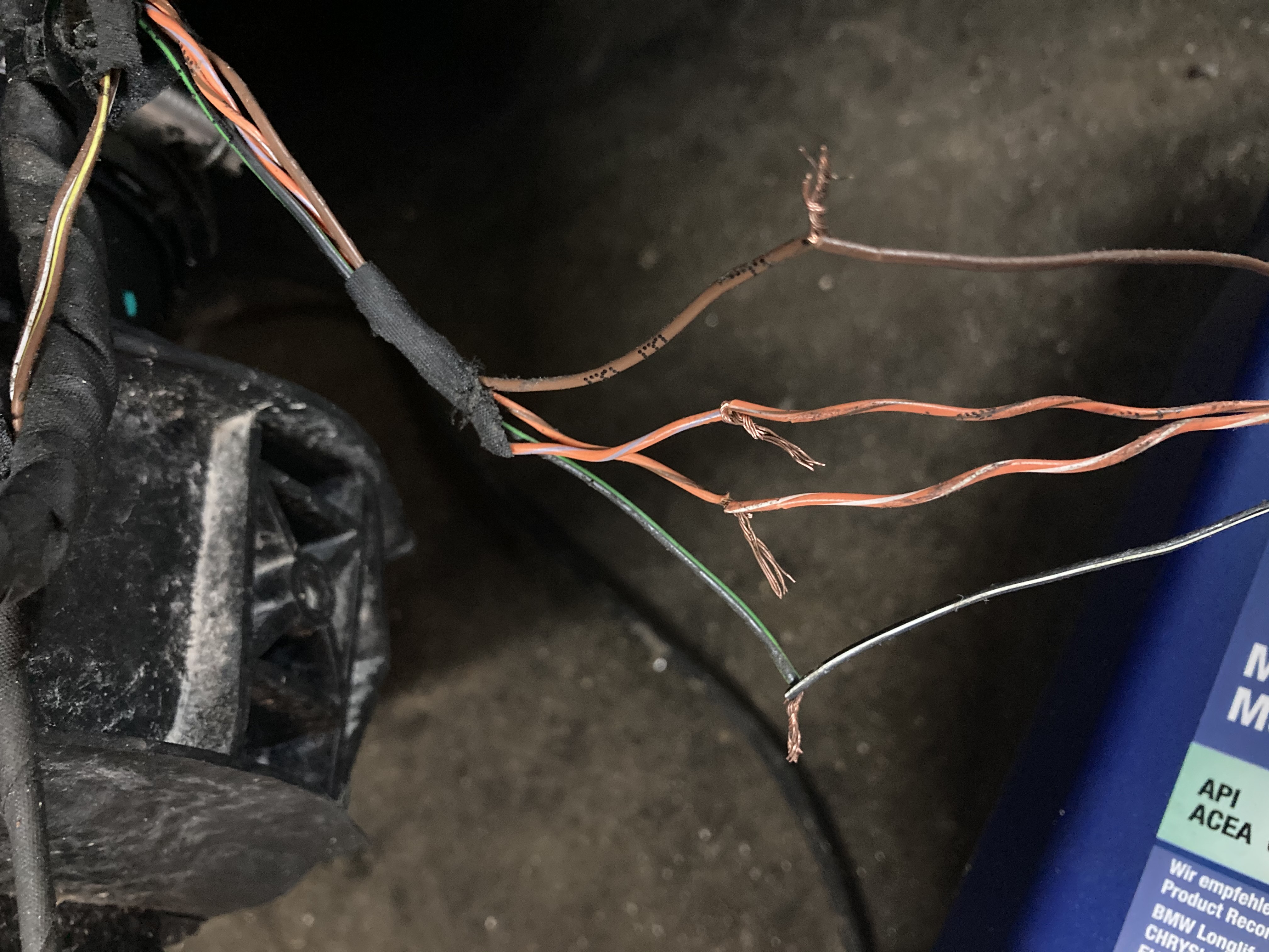

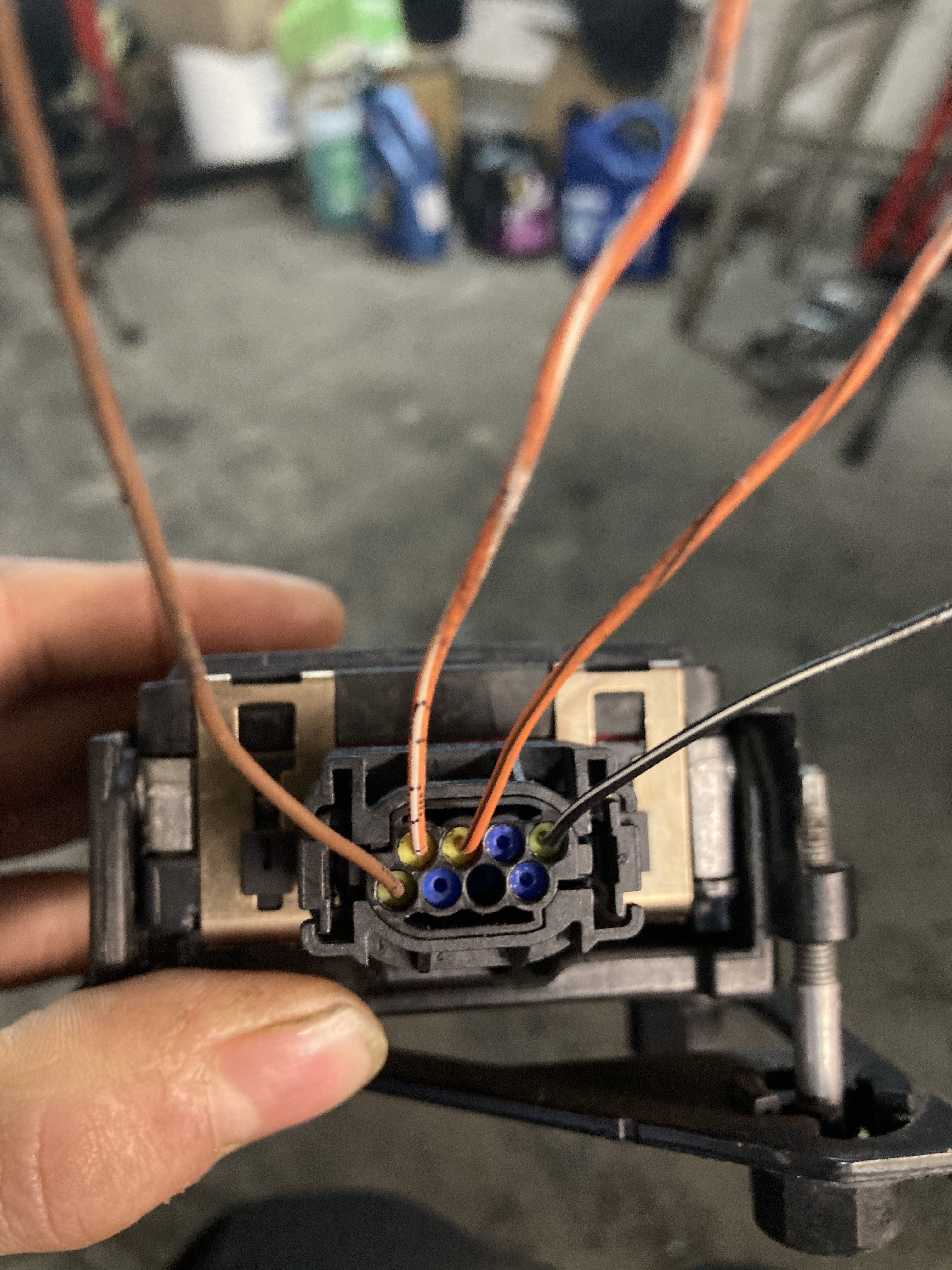

  2. Need wiring diagram because car had accident. i buy new distronic and now i don’t now how to connect because wiring a different color
  3. hello who can help? how do the wires connect? skoda octavia 2014 rs thx
