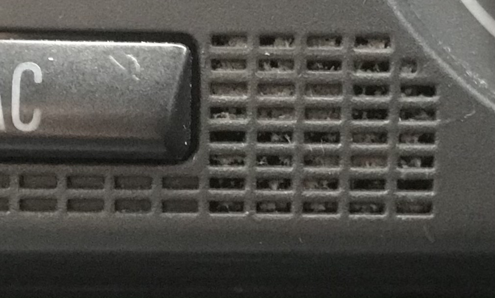

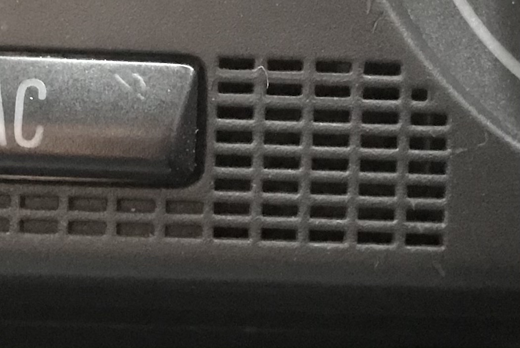

  17. I didn't say but the MPG can go back to 54 at different times of the day and doesnt seem linked to engine or outside temp. It always runs and sounds a bit lumpy as it's a 3 cylinder 1.2 12v and I always use E10 although it does sometimes lose powermoving off from stopped or low speed.
  18. My average MPG is normally 54 as I do a pretty consistant commute on a motorway but it is now dropping to 44 but for no particular reason. It happens on different journeys and at different times I've had the car (54 plate Fabia 1.2 engine) for about 18monts and it's just started happening. Any idea what it might be? MAF sensor, injectors? Thanks ๐Ÿ‘
  19. Thank you KT for taking time to reply, I'll do that
  20. Thanks it was clogged up! & I cleaned it I'll see how it goes now

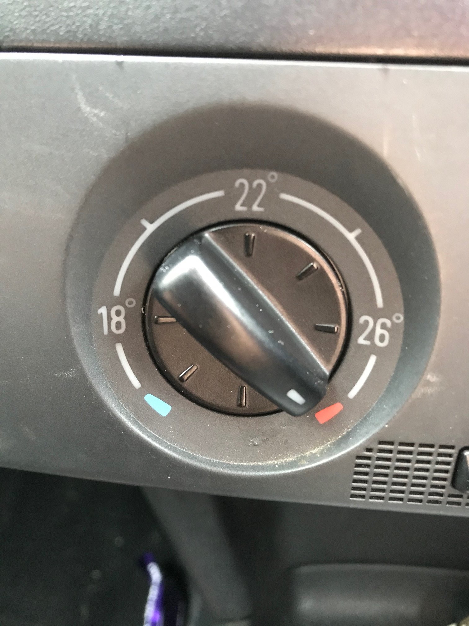

  22. Just a quick one, when I set the internal temperature the blower is either cold (fully closed in the Blue) or hot (one click towards 18) How do I get it just blowing warm air? Am I doing something wrong or is it broken?
