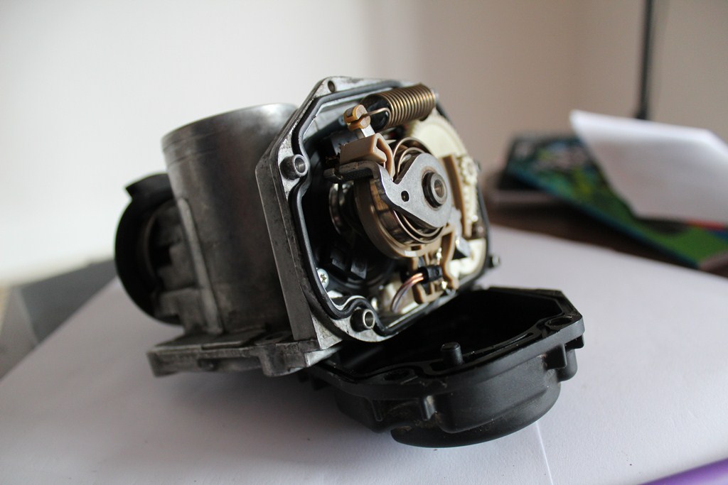

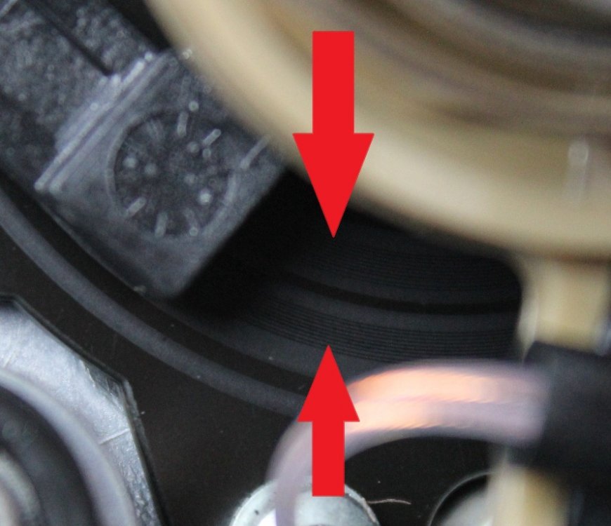

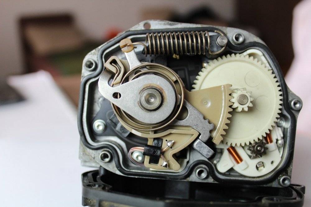

  2. Hello, i am new member but experienced Skoda user ... Felicia 1.6 mpi - 1997...i am having interesting issues on this car....but curently i am trying to do a good job with throttle body.. I have cleaned the throttle body with carburator cleaner, but now i want to clean potentiometer, which is inside the TB. Does anyone tried that? Is there any serious side effects of this action? I will be using spray for regeneration of potentiometer Kontakt PR . I am posting the pictures of my TB and this potentiometer(TPS) inside of it. There are visible TRACKS where the slider slide... There are actually two sliders one for the actual position of the gas pedal and the second one is used for idle. I would spray them both... Reasons why i want to do this: 1.) Adaptation of the TB would cost me 20 euros, cause i dont have VAG software, and before paying i want to do as much as posibble... 2.) I have noticed that the rev counter needle is making micro dancing in EVERY position (no matter is it idle or 3k revs). This TB is very old, i guess it's from '97 and it is posibble that the sliders scratched the resistive layer and micro dust makes micro dancing of rev counter needle. Any suggestions would be very helpful. tnx
