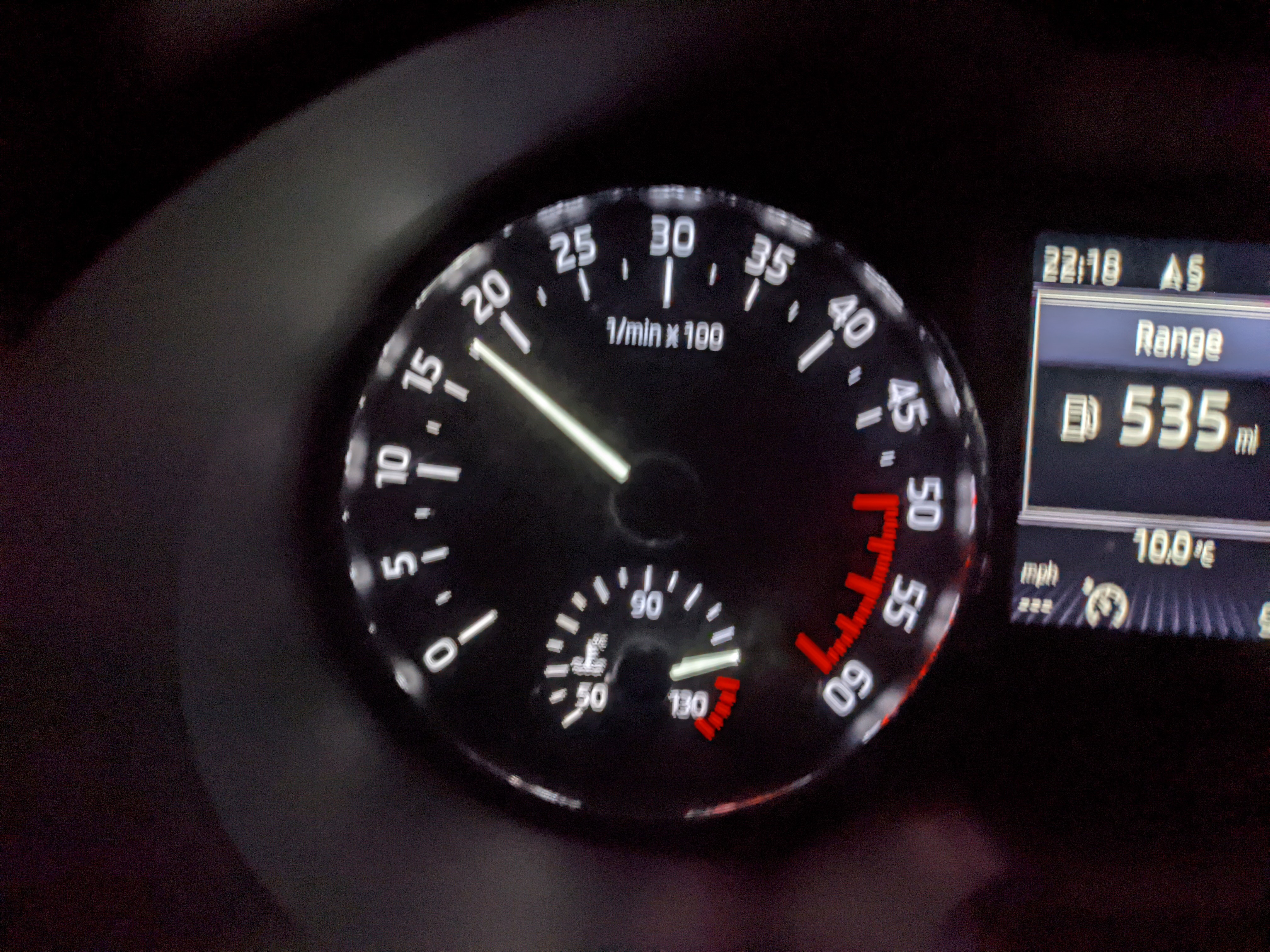

  1. 4x4 SE L Octavia Estate 2.0 150 82,000 miles When driving normally at 62MPH (on cruise) my temp guage flew of the chart! See photo... I employed the old idea of turning my heating up to Hi, this remedied the situation and the gauge returned to 90°. I then attempted to reset my climate to 21° on auto and moments later the temp guage flew back up to around 130°. This has happened twice in the last 10,000 miles. Both times I pulled over, checked the coolant level, turned the car off, waited a moment and the drove on without further issue meaning to Google the symptom. Neither times was the coolant reservoir hot to the touch or changing in anyway... I have seen remarks from "simple coolant flush needed" to "head gaskets gone mate, throw it in the bin". Any advice on a known issue with these Octavias and coolant temp readings?
