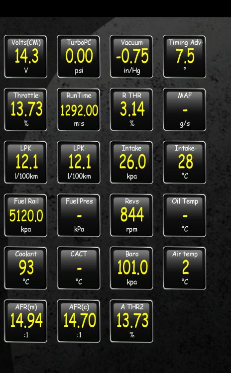

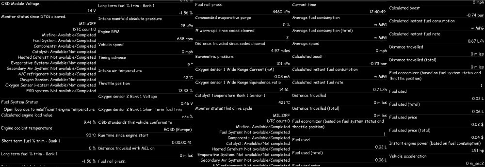

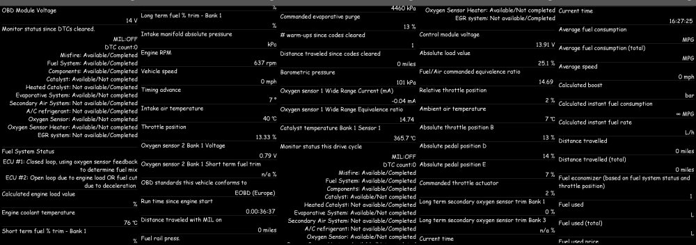

  1. Hey there, so this morning I was able to have the scan after the lights popped out, first picture is a snapshot with the values I've been monitoring while driving so I was able to take it right after the event (being stuck in traffic) , then I continued my travel so when i got in a parking lot I made a full scan (the long picture)
