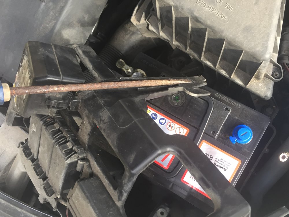

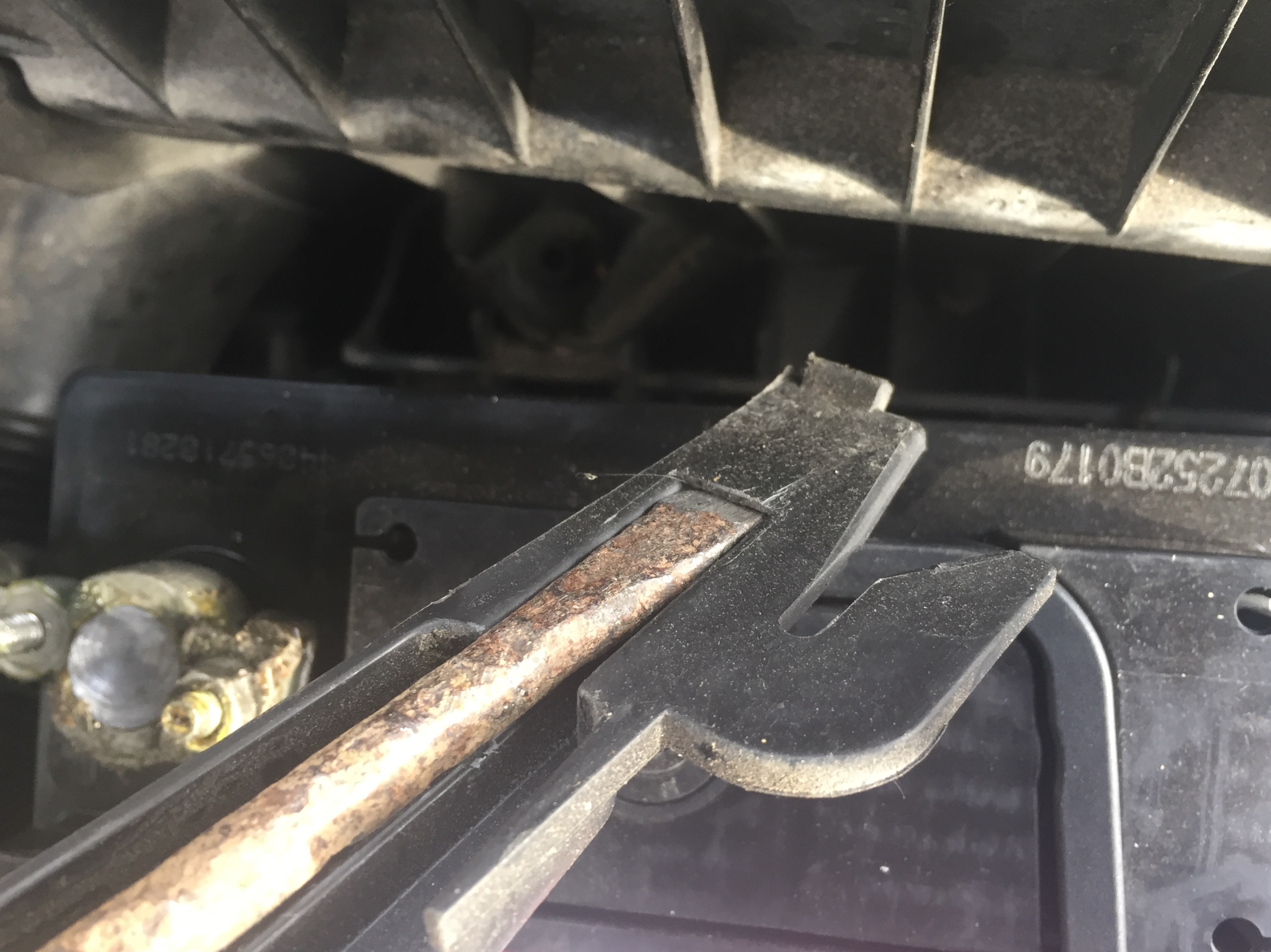

  3. I have just changed the battery on a 2007 Roomster 1.4 TDI and would like to thank this thread for the help in removing the plastic cover which houses the battery. The two side clips were relatively easy - inserted a flat head screwdriver in the slot and pulled away from the tray. The third clip is more tricky as it’s positioned at the back of the battery and impossible to reach by hand. You definitely need a long reach flat head screwdriver. Push that down towards the clip and prise away from from the tray. I’ll add photos of the released clip.
