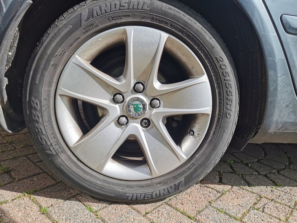

Yup, first thing I did was take all the others out and replace with normal wheel nuts, I figure the chances of me getting a flat and needing to change the tyre is higher than the risk of someone decided to steal some beaten up alloys from a 12 year old Octavia 😄

I did... but unfortunately this was by taking it to the tyre fitters 😞

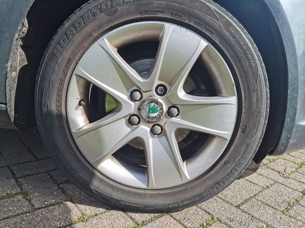

Yeah, the spiral socket is what I tried, but it was a cheap £10 set from Amazon (figured it was something I'm unlikely to use very often). Unfortunately the biggest size was 19mm which is "just" too small, I spent about an hour trying to hammer it on to the nut, but couldn't get it on far enough to actually grip 😕

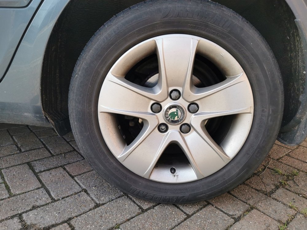

Locking wheel nut stripped - suggestions?

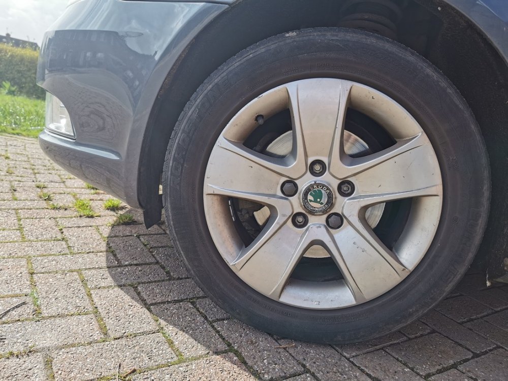

Went to change my brake pads last weekend and one of my locking wheel bolts has completely stripped the splines - it's basically just a perfect circle in the middle now. I managed to hammer a 20mm socket on the outside, but that is just spinning when I apply any force to it. I picked up a pack of nut/bolt extractors, but the largest one was 19mm which doesn't quite go on - managed to hammer it on about half way, but it just slips off when I apply any force to it - I can't find a 20mm nut extractor anywhere 😞 I took it down to the local tyre fitter over the weekend after spending several hours swearing at it, and they tried pretty much the same as me with no luck, so it's booked in for Thursday to have a socket welded on, but is there anything else I can try before then to save a few £? Frustratingly, the wheel was off a few weeks ago to check the disks and pads while I was servicing it and the nut came off no problem then, so I guess I've just over-tightened it 😞

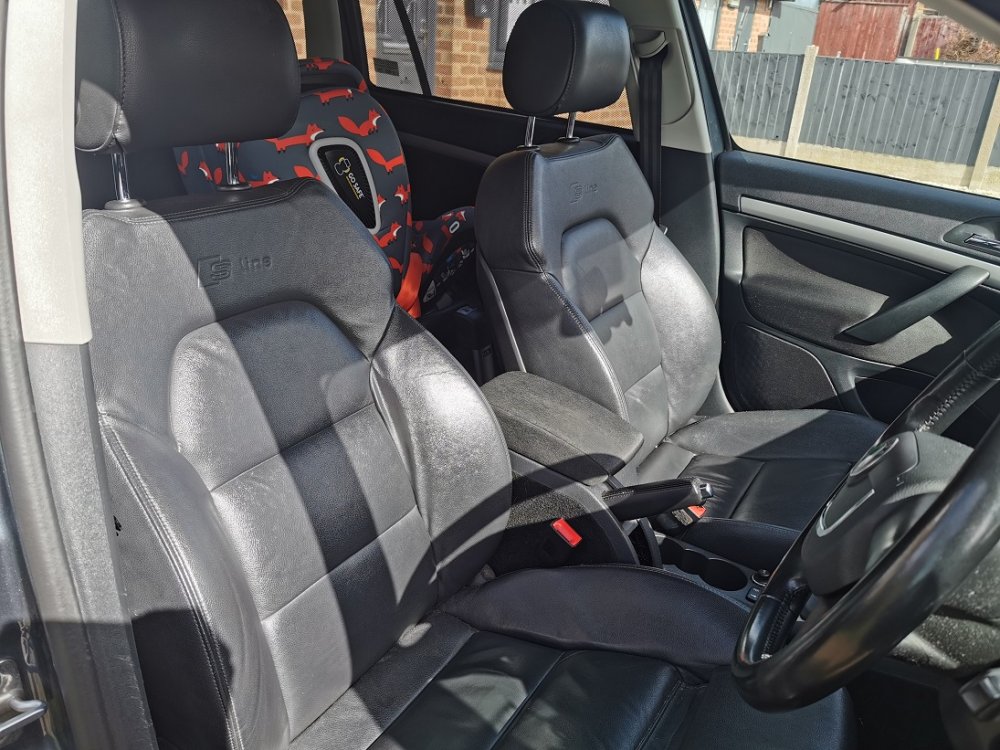

Audi A6 B6 front seats will fit with a bit of very basic modification - I put some S-Line ones in mine. There's an extra metal locating lug on the rails from the Audi seats which needs removing - 30 seconds with a hacksaw Electrical connectors don't fit - you'll need to either make some adapters or cut the plugs off and rewire them with the ones from your original seats (I did the latter). If you don't currently have electric seats then you'll need to run wiring some wiring. I picked up manual seats with the electric lumbar adjustment, and piggybacked off the cigarette lighte, but if I'd gone for electric seats I would have run it directly from the fuse box. I believe the memory seats require more than just power - an additional control module or something? I didn't bother wiring up the heated seat pads, I believe these also require an additional control module - if this is something you want then there are plenty of aftermarket kits on ebay etc. From my research before fitting these, there isn't really anything else which will fit the rear seats without significant modification.

The donor car was a 60 plate A6 saloon, so no chance of the rears fitting (although actually, I haven't tried), as far as I'm aware, any C6 (2004-2011) variant will do. In my case (manual cloth Elegance), the following connectors needed to be swapped: Driver side: Airbag (3 pin yellow), seatbelt (2 pin black) Passenger side: Airbag (3 pin yellow) The donor seats came with 4 connectors: Airbag (3 pin yellow) - easy swap, the wire colours match Seatbelt (black, not sure of the connector as it was already missing) - different colours, but I just matched up the ones with the stripe - possibly doesn't matter as I'm guessing it just checks for an open or closed circuit. Seat Electrics (8 pin red, although only 4 wires) - had to do some research on this one, it appears 2 of the wires (pins 4 + 5) are for the lumbar control, and the other 2 are for the rear footwell lights, I didn't bother with the lights, just connected the lumbar to 12V Seat Heating (green 6? pin) - no idea, ignored this one as I don't have the wiring. If you just solder/heatshrink the new connectors on, it's probably quicker, and in hindsight I think this would have been a better option as I can't envision swapping them back. There's also an extra locating pin on the Audi seats which I cut off with hacksaw and then filed down, otherwise they just drop in. You'll lose the rear seat pockets, and the storage under the passenger seat (could probably be attached somehow, but I couldn't get the screw holes to line up).

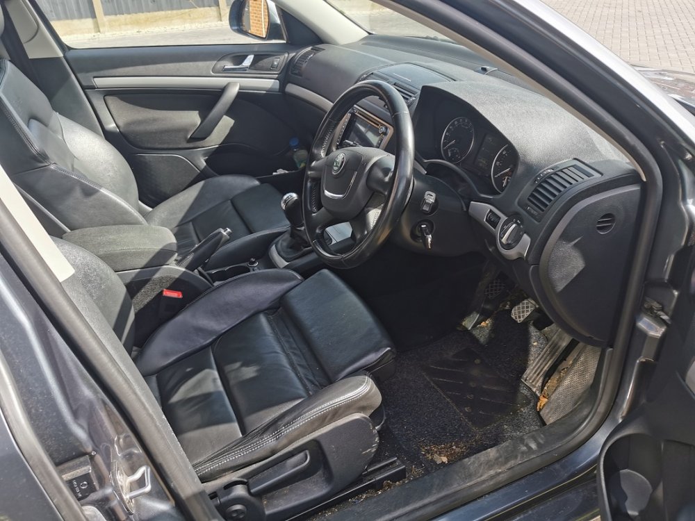

Seat options for FL estate
Managed to pick up some A6 S Line seats over the weekend, and spent yesterday swapping them over, relatively straightforward - the most time consuming part was crimping all the connectors so I could easily swap the plugs back if needed! The electric lumbar adjustment connection was a bit of a PITA to run the 12v to, but after a bit of research, they have a relatively low current draw (the original fuses are 5A), so I piggybacked them off the lighter socket. All fully working, night & day in terms of comfort! They are full leather heated, I was trying to figure out if it was possible to get an aftermarket heated seat kit and just hook it up to the existing pads, but I don't think that would work too well. Happy with it all for now anyway - will see how they are in winter and can always stick an aftermarket kit in if they are too cold! Back seats don't look too bad even though they don't match, so don't think I'll bother with those for now. Now I just need to get rid of the rear Audi seats and figure out what I'm going to do with the old Skoda fronts!

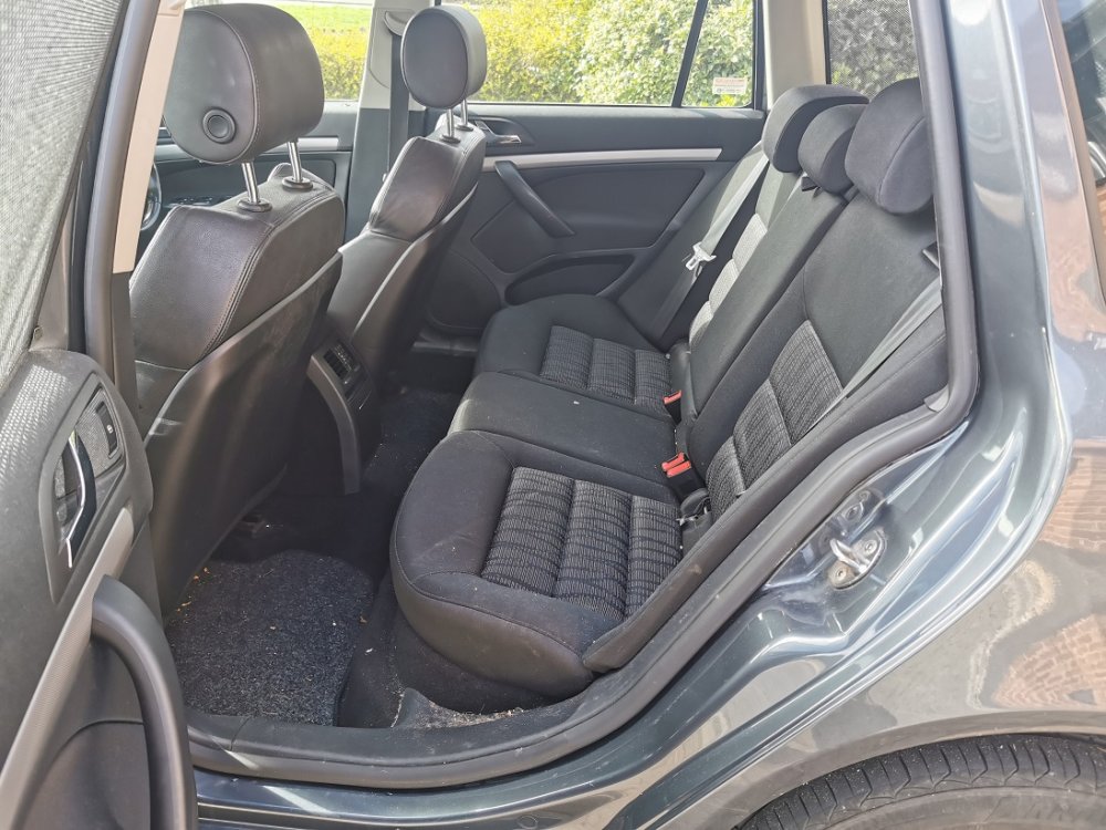

A potential new solution: Audi A6 fronts L&K rears (and possibly door cards) Yes it will still be a hybrid mishmash of scavenged parts, but I think the leather rears will probably match the fronts better than the current cloth ones.

It seems another member has managed to get the golf Mk5 rears to fit That certainly swings it towards the Golf - those seats look the same as the ones i'm looking at, although that thread doesn't say if they've gone into a hatch or estate. Also the Golf set near me is full leather, whereas the A6 ones are half leather. Probably true about the quality being better on the Audi ones though. Choices...

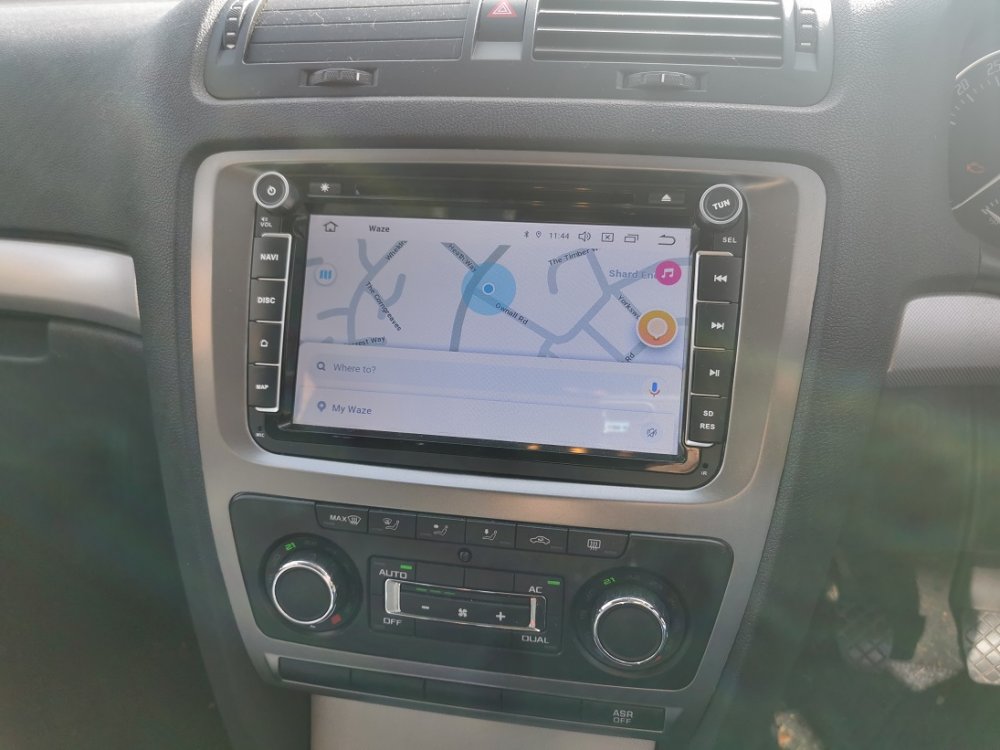

New Mk II estate owner, a few questions re. headrests, android stereos, Maxidot & MFSW
Yes it's this one here: https://xtrons.co.uk/skoda-octavia-reversing-camera-camskot01, As mentioned though, unfortunately the screw holes don't line up properly, so maybe better going for the boot opening one as linked by @Phil-E above - here is mine installed atm: https://photos.app.goo.gl/PSrdv9HuHqEJFG287
