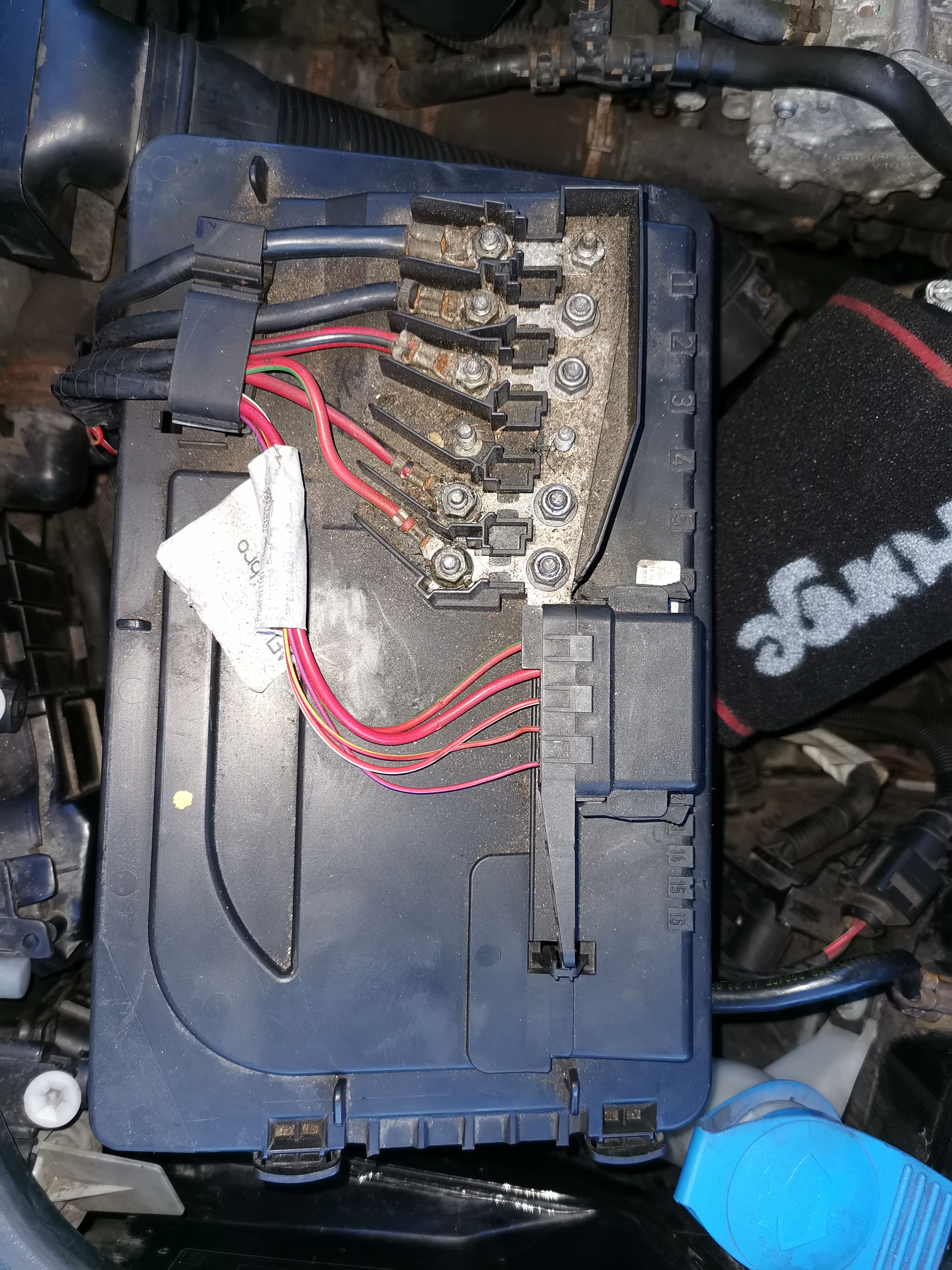

  1. Unfortunately not mate, I had a new crank sensor fitted on Wednesday and that didn't fix it, Looking at swapping the ECU with my mates soon to see if it's a problem with the map or not. I've had a look for the glow plug fuse on top of the battery like you said but not sure what I'm really looking for aha. Attached an image for you to see, don't know if it tells you anything but worth the shot mate aha. Cheers bud
