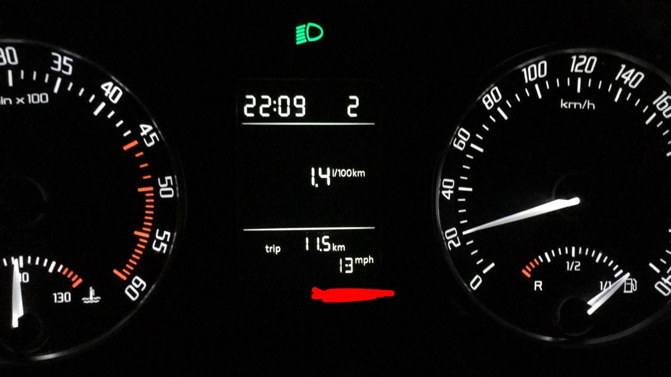

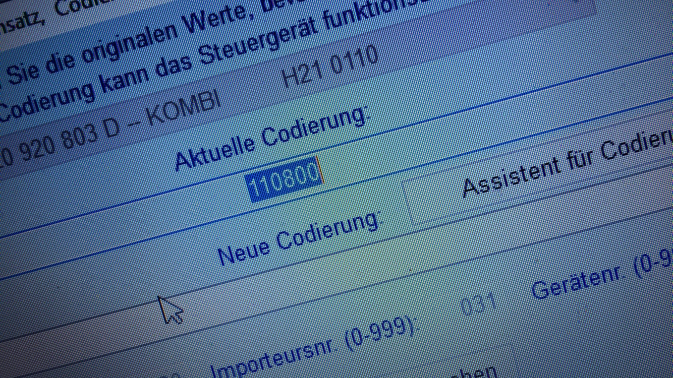

  1. Hi I’m the owner of a Octavia 2 FL 1,6 TDI Greenline, where the instrumentcluster suddenly is dead. Nothing in the cluster is working - no lights, needles or displays. As the immobiliser is going thru the cluster, the car also won’t run - it just starts, but stops after about 1 second. All fuses are OK. Has anyone had this before??? 🤔🙏🏻 Drove the car normally on wednesday, but as I would start the car on thursday, the problem was there - has never had something like this before.
