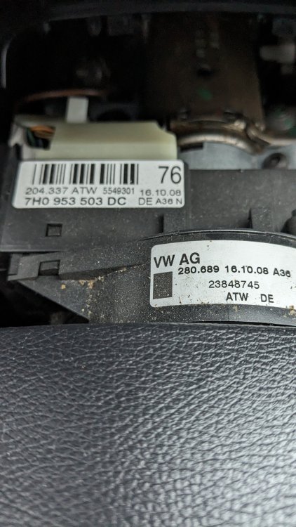

  6. Ohh, okey. Do you think that if I would change the slip ring I would be able to get access to Module 16 or that the cruise control might work? - Yes the do seems to be all the same. A bit more pattern on the rear axel but otherwise the seems the same. - I do guess that when you push the set on CC it would be telling the engine ECU to hold the speed, since the ECU is recognised the input from the CC could there be something in the Eeprom that isnt working or could there be any mechanical fault?
  7. Hmm, So if I would have replaced the slip ring and stalk to another one with G85, wonder if it would work then or if it would be non compatible? - Noticed another thing when checking the speed on each individual tire there was a difference in speed about 2 km/h on left right tire, thinking if this could interfere somehow?

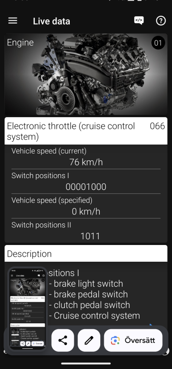

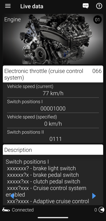

  10. Yes tried everything. Moving the stalk in different positions and in giving feedback from it. On, off and cancel. Its just that it will not apply it to the engine. You can see in the images that im getting feedback but it will not apply that to specified speed. Edit: Also bought a new clutch pedal switch but no difference.

  12. Hi! i can't get my cruise control to work. It will not engage when in speed. Nothing happens. I have tried the following to get it to work: - Checked the stalk in Live Data and it checks out and in getting feedback from OBD11. No clutch engaged or brake. - Tried putting in the activate code in Engine Module. Did a Throttle Body Alignment in OBD. - Removed the microchip on the stalk and cleaned it. - Checked all the fuses. I have no idea where to continue from here. Thanks in advance!

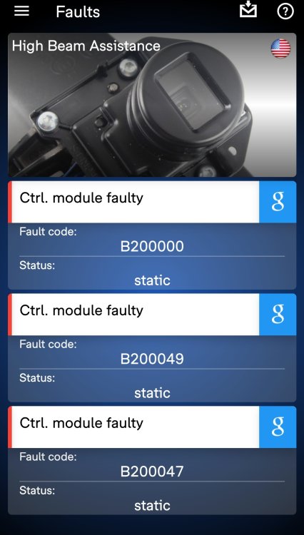

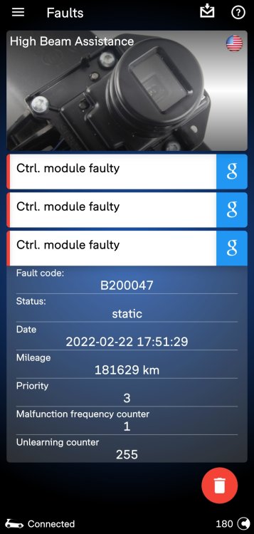

  15. The problem was when i bought the car. RLS was not working I got that working. * The right side light issue is because when using OBDELEVEN apps - Its not coding properly. - But that issue has been resolved. I had the original adaption. The problem is the HBA. I read on the forum that many people had to code the A5 module. But I only have the 20 module. The High beam adaptive function that follows the movement of the steering wheel works flawless. When using the high beam and the Light assist is check via Multimedia panel its comes on and works but gives error Light assist fault. 09: Gives databus error - no communication and HBA (see image below)
  16. Hi! Im having some issue with my Skoda Octavia VRS 2014. - First I had the issue with the RLS not working. But after som coding in OBDELEVEN it works. The issue is that the Headlights Assist is not working. It gives the error Light assist Issue. - Also when coding DRL with turn signal. The right side of the lights stays on even when the car is off. Anyone have an idea of what that can be?
