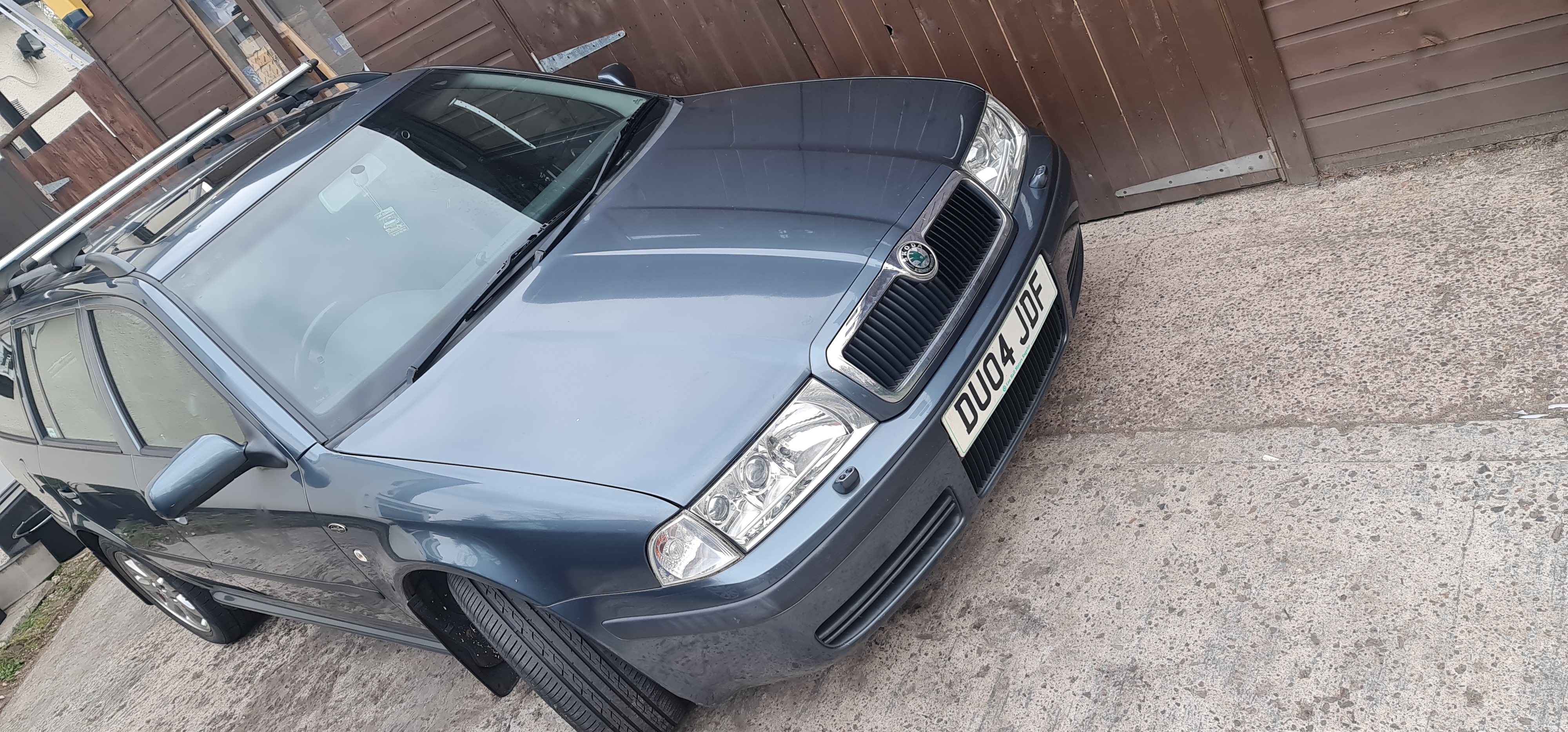

  8. HI its not white smoke its just the normal smkoe cause the glow plugs are not working .they are brand new but ive tested for power and its just earth there no live at all
