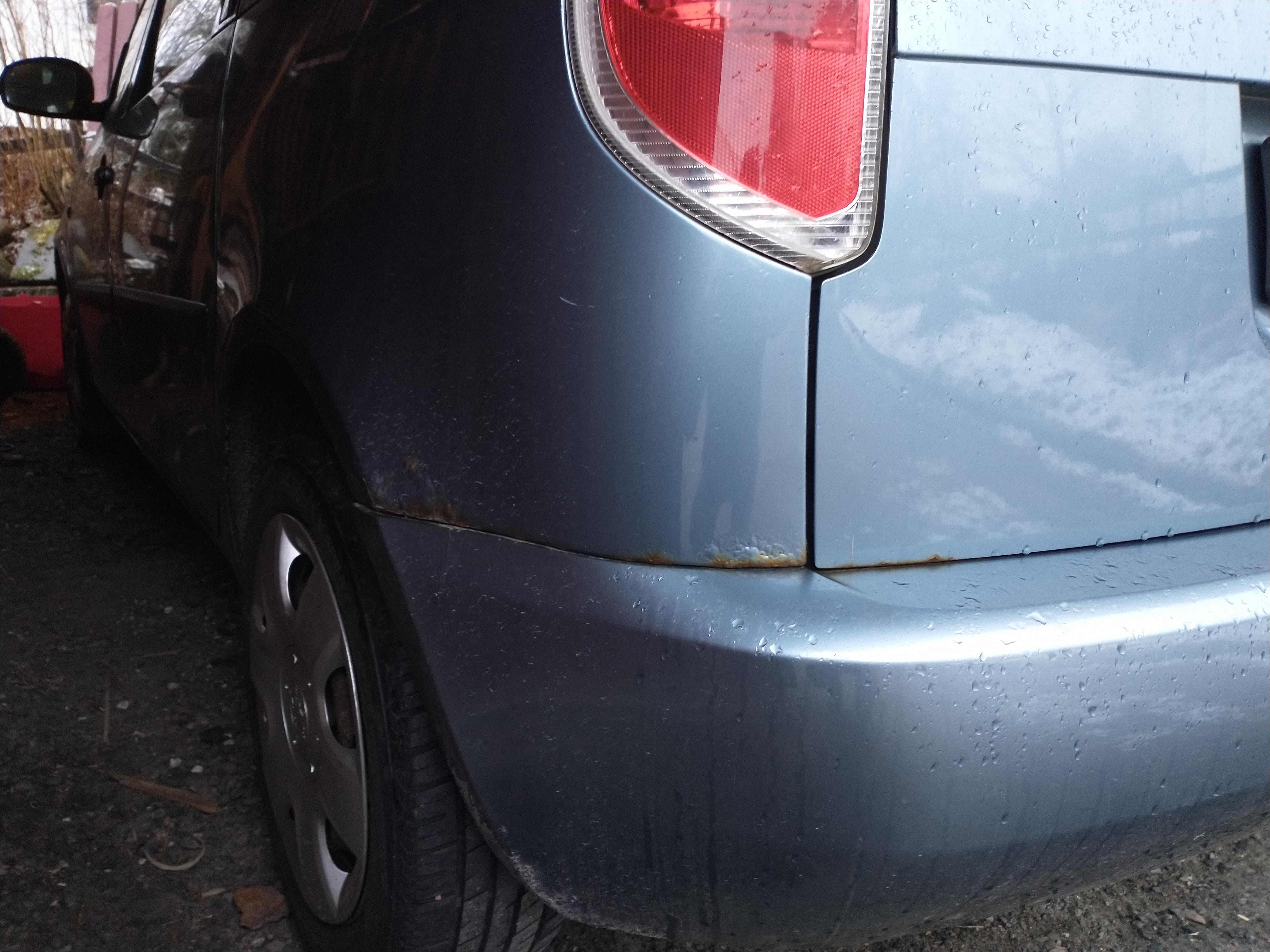

  2. I think I'm going to attack it all with an angle grinder with a wire brush attachment on the front and behind the panel to remove all rust, then fill and paint. It has bubbled up so I'm guessing the rust will go right through...

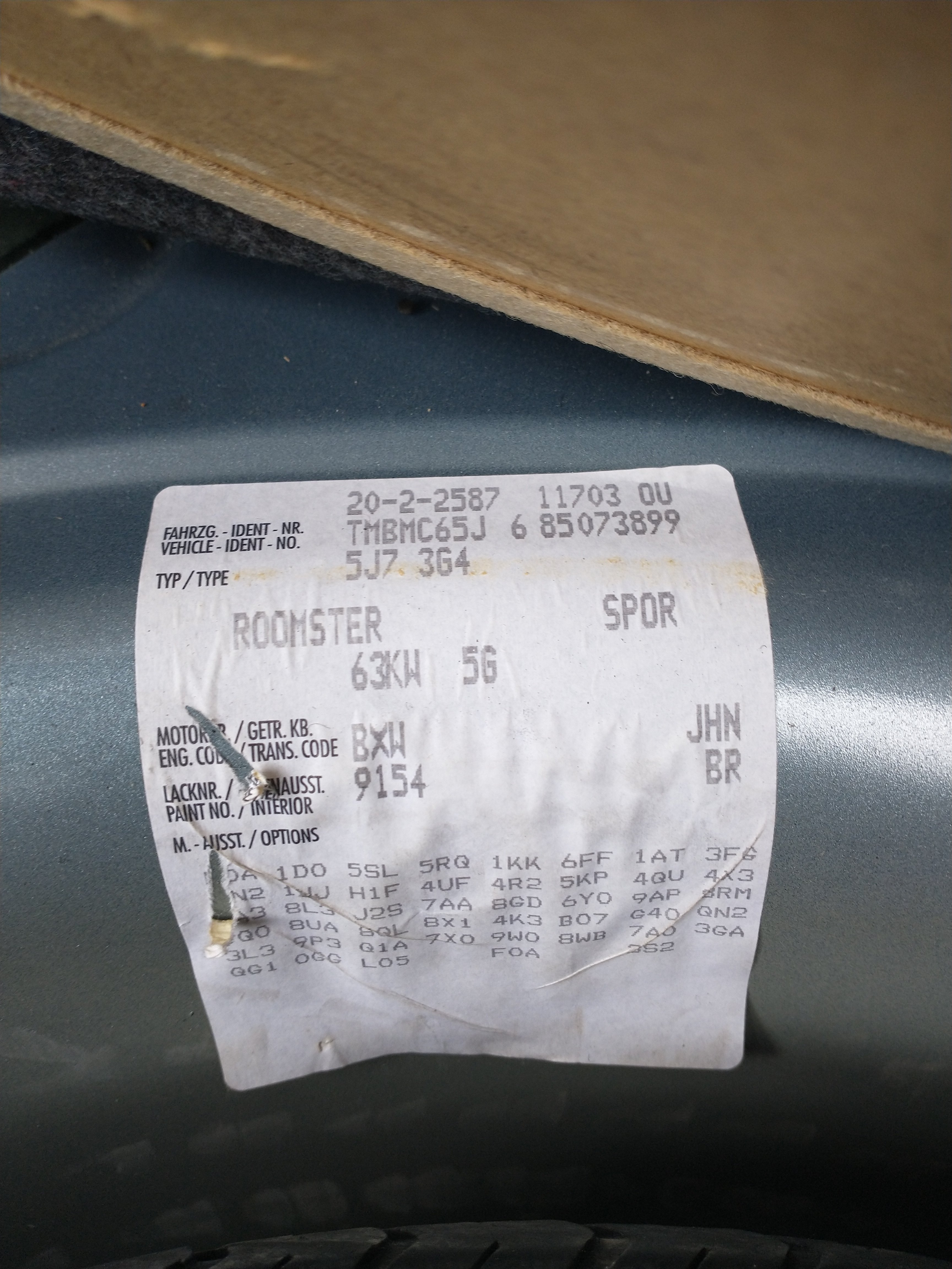

  4. I need to get rid of some rust on my Roomster I have found the paint code, 9154, but I have found that the colour is called Satin Grey and the car looks blue to me! Is there any way the paint code can be wrong, or should I just go ahead and order the paint?
