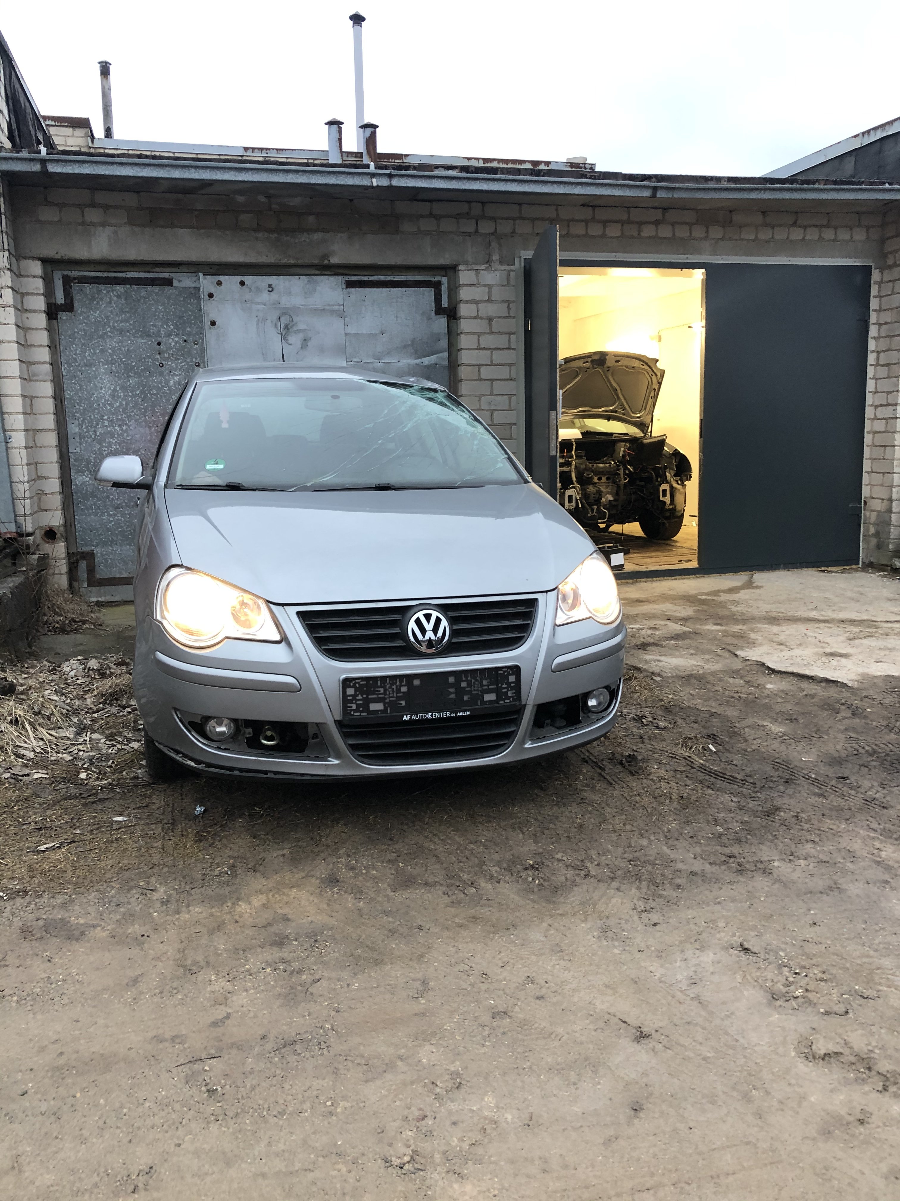

  1. Here is the car almost finished 😁
  2. Yep. Ignition switched 12v. Well the engine runs like butter and everything works now. Noe to retrofit the fog lights wiring and put on a 9n3 front end and the car is finished haha

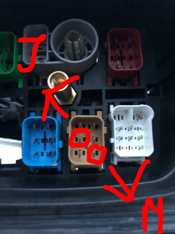

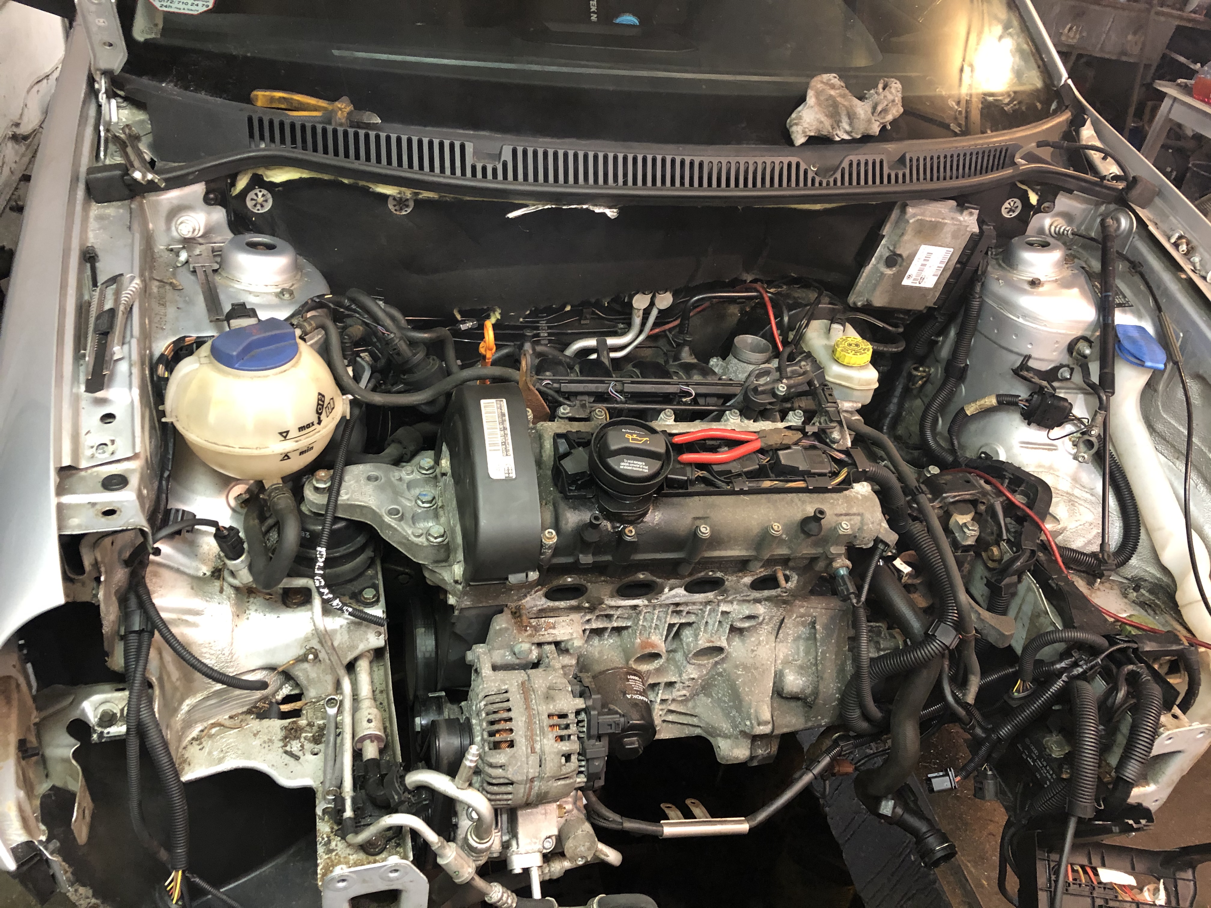

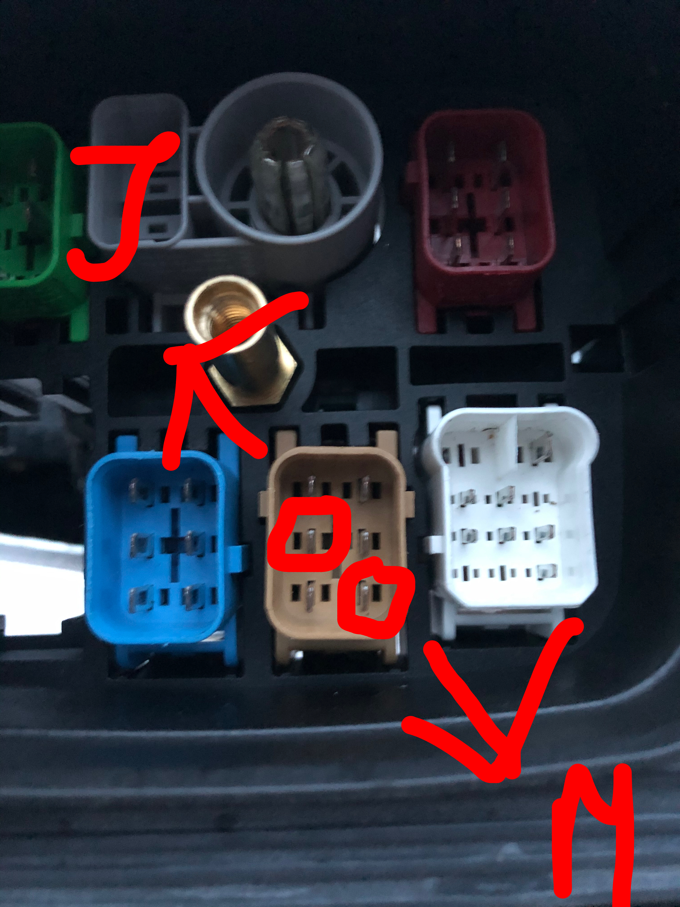

  4. Thanks for the answer! The 9n is built in 2003 and the 9n3 is from 2006. We put the entire 9n3 engine bay loom from the 9n3. On the bulkhead connector there are 2pins missing in the 9n that the 9n3 has. I’m attaching a picture of the two pins. J stands for black and purple wire and M stands for blue and white i think. Also we swapped the ecu, instrument cluster and the immo chip in the key for the immobilizer
