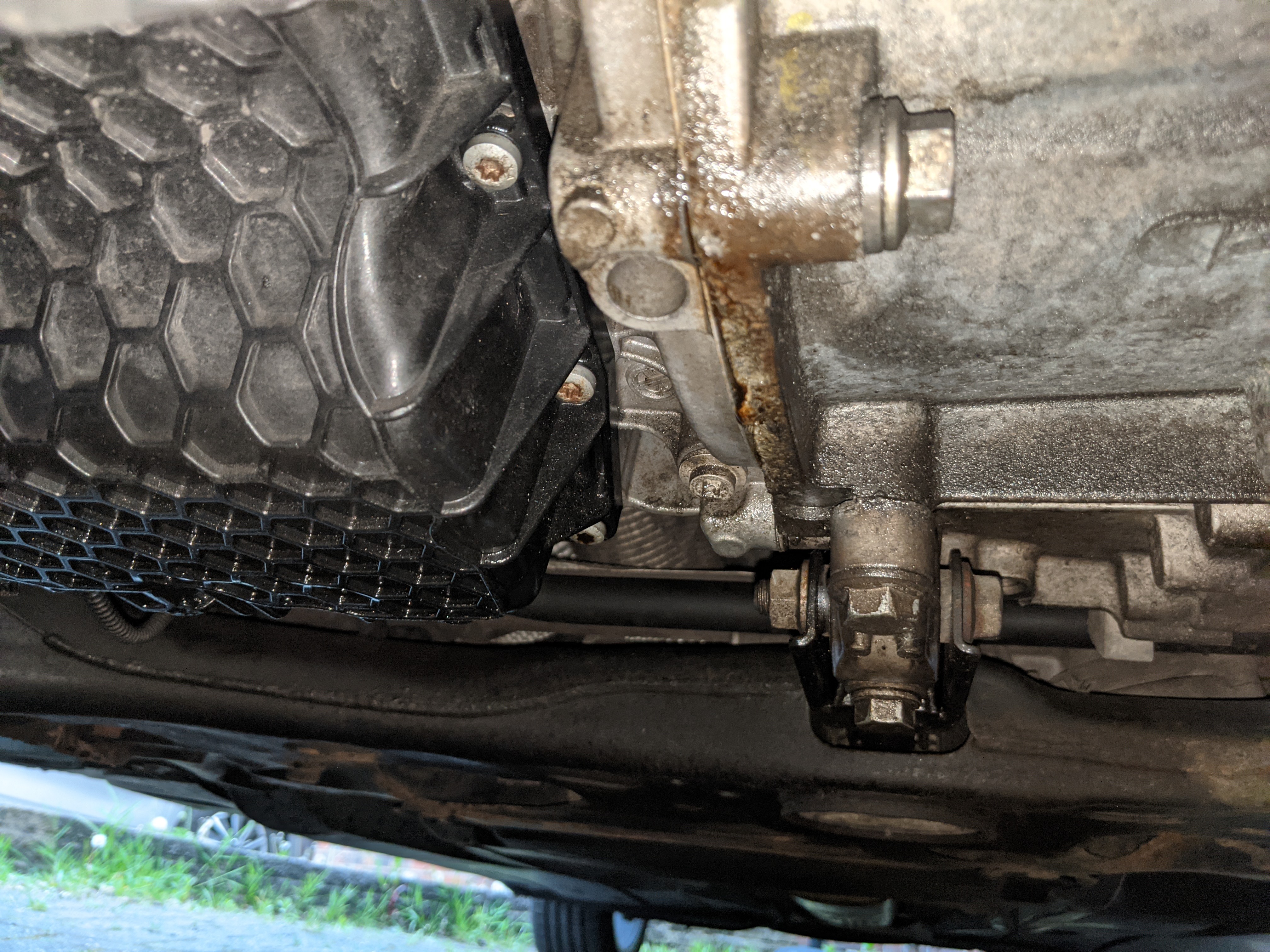

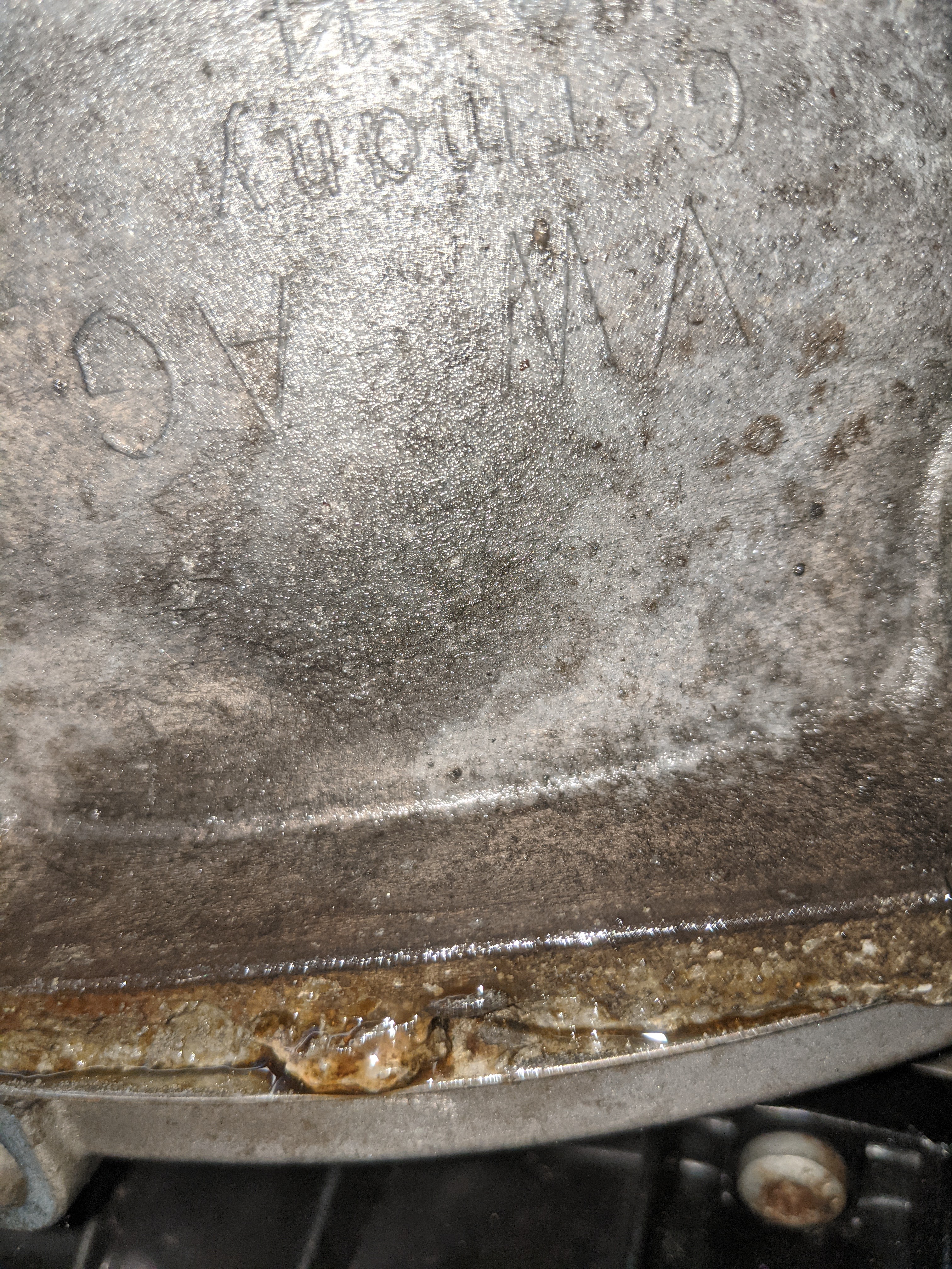

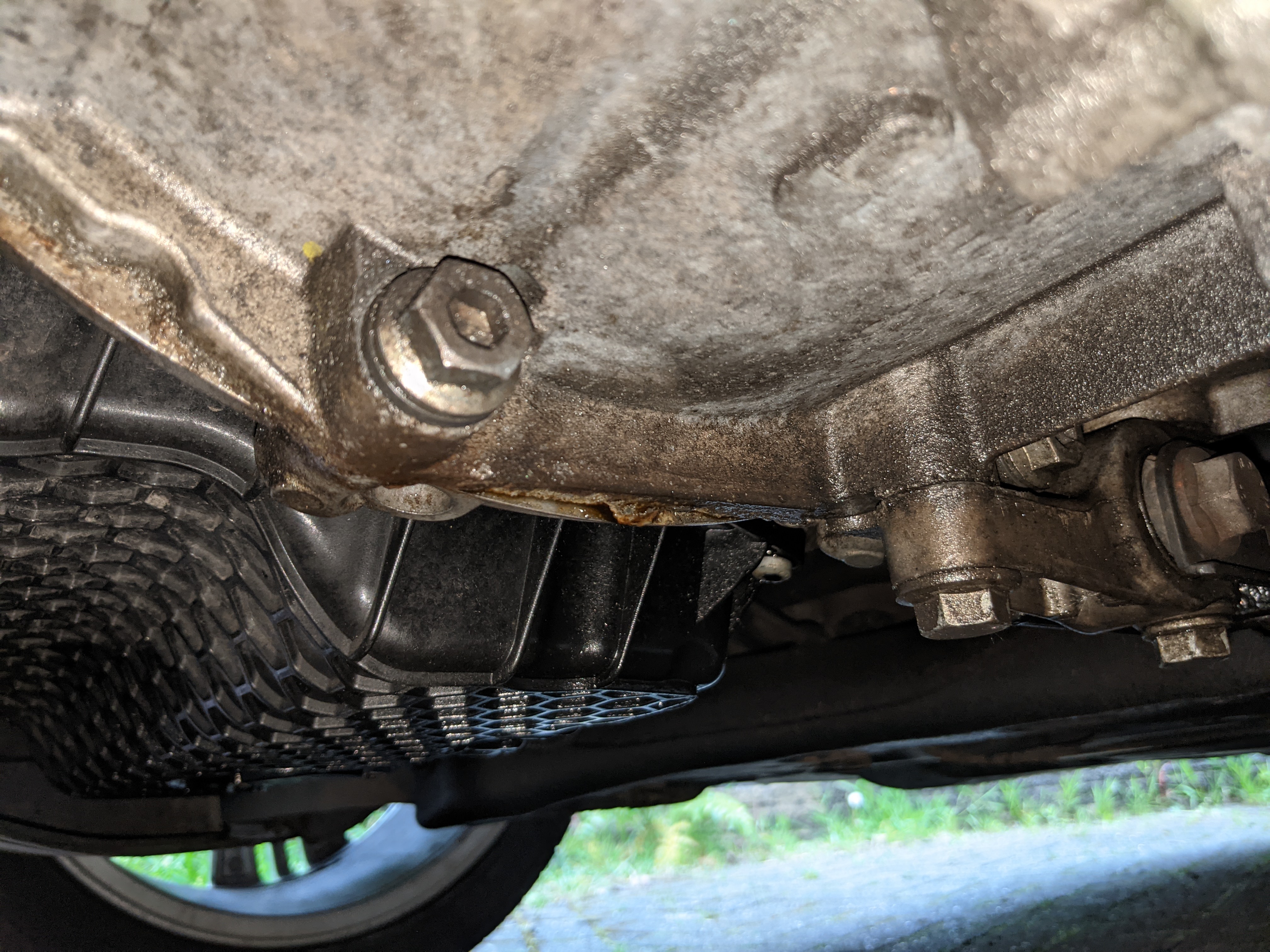

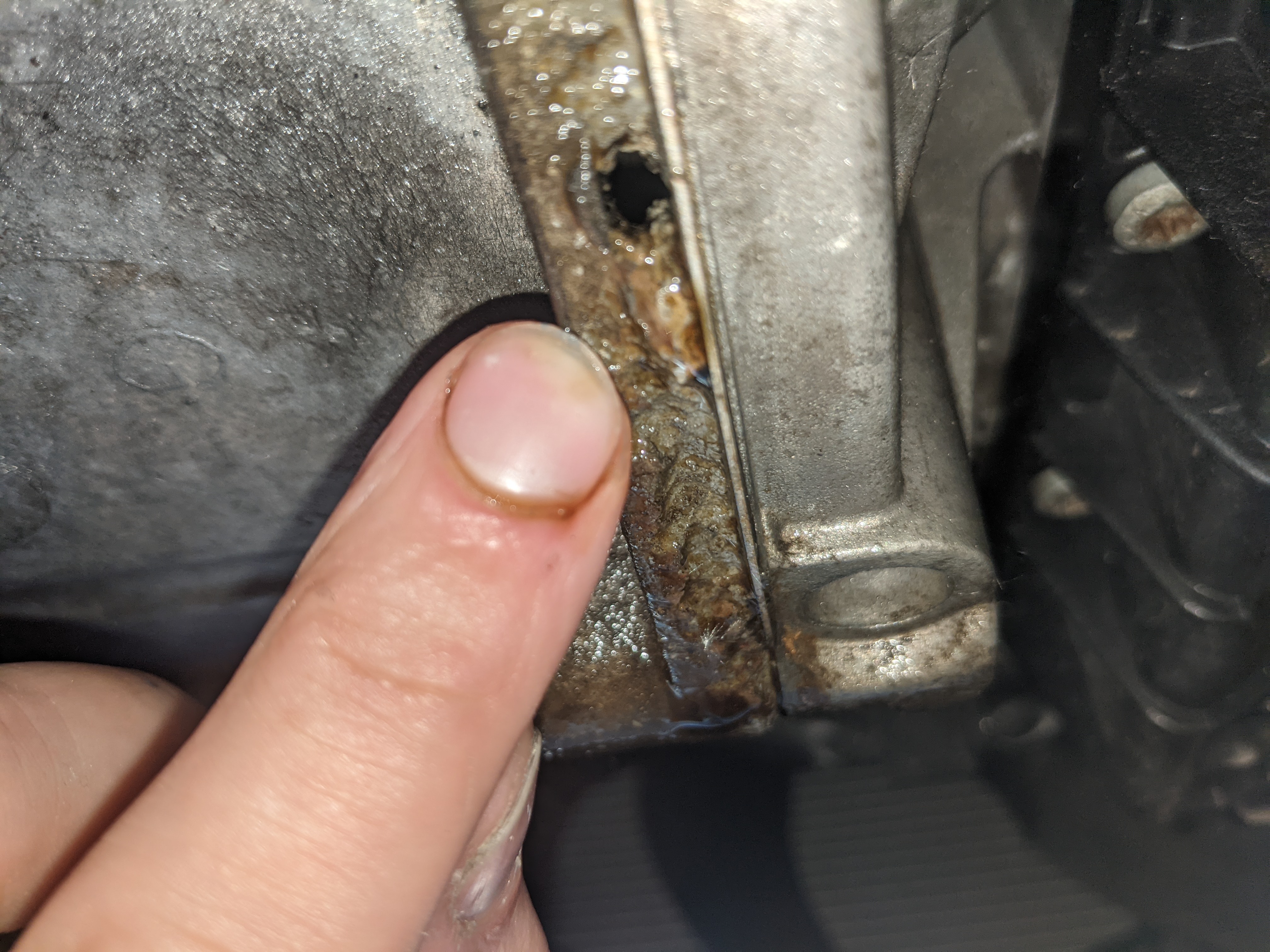

  1. @J.R. Thankyou for all your advice mate, its appreciated, as you stated it was indeed a drain hole (albeit a suspicious looking one) but the source of the leak is a suspected main rear seal, and like you say a couple drops of oil a day is nothing too serious so ill keep an eye on it, and when the clutch is due ill get the seal done at the same time. Otherwise, all is groovy and i can relax

  4. Thanks bud, i had an injector let go on the car recently after a month of ownership and 500 miles and the garage contributed what they would cost it at to replace (as they are about 60 miles from me) but they were a bit funny with me, im just hesitant to go back with another problem in case i get told to do one. I think i have another month and a half through trading standards/consumer rights act.
  5. Thanks for the replies guys, to further my original post, it only seems to weep/slow drip oil after its been driven/oil is hot, i managed to get some better pictures, is this the aforementioned weep hole? Also can confirm i was being an idiot, its not the gbox engine mating its under the block next to the sump, there does seem to be more oil than id expect to be around the area?
