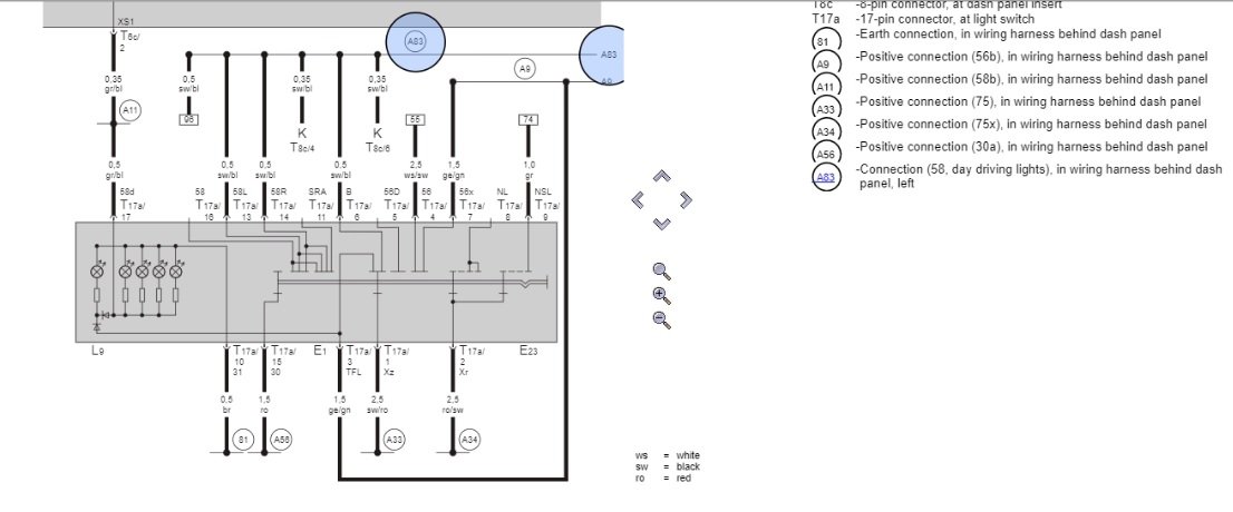

  2. Hello everyone, I have day driving lights on diped headlights, but I want to deactivate it. I didnt find function in ODIS to deactivate them. I have wirring diagram for OEM daylights (attachment) but didnt find solution. So, if anyone have idea how to deactivate please help me. Thank you
