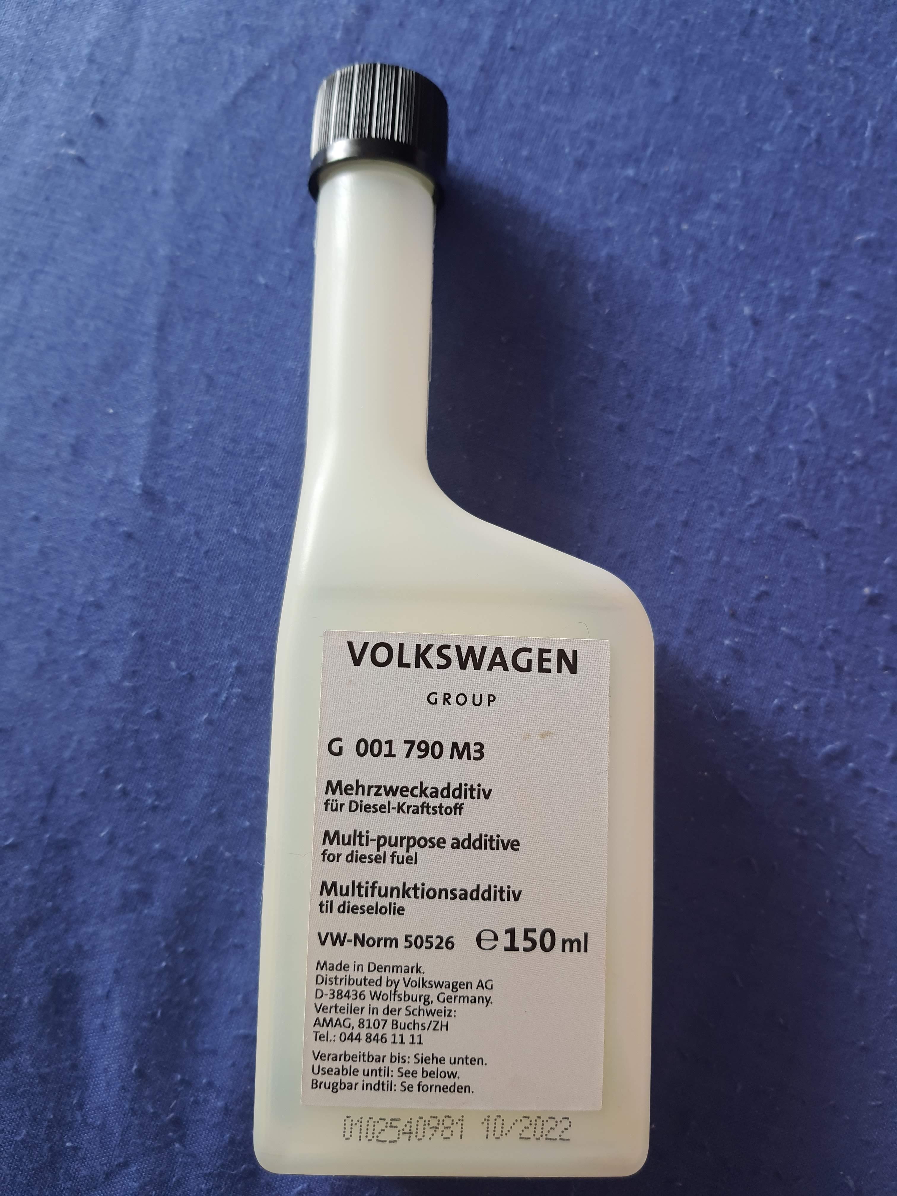

How many km has your car done? A bit over 167000km When was it last serviced & by who? 05 July 2021, 136000km by Skoda dealer What is actually wrong with the car? Engine misfire. Visited dealer to figure out what is that. (Never had diesel before, so wasn't familiar) So they servised (July 2021) gave me bottle additive tu put in the tank and said you should befine. I was fine for about 15000km, just until oil change. It started misfire again. So changed oil (nd something else related), got same botle again. Asked why I should pour it every time? they said if it helps, just don't bother yourself - pour it. I asked again: I want to eliminate problem, not to hide... It would be expensive and probably unnescesary, they answered. Ok... Now again just before oil chnge (in 15000km) symptoms came back, but stronger. Car got jerky not only when cold, but always. Cold engine was really hard speed up from 0 to ~20km/h, then 2-50km/h it was jerky, but not extremely bad. With these symptoms I limite my driving just to work-home qhich is 10 min driving trough town and 15min on highway. On higway 95km/h was my sweet point almost no jerking. Driving in town, gears changing bit too late, I started to change them manually to avoid hig revs. (for me high revs is about 2.500rpm) when acclerating from standstill the clicking noise appears. foot away the accelerator - clicking (banging?) noise gone. (I had same noise with my very old ptrol car by the way). So I headed to dealer with these symptoms. In a few hours they come back to me with news listed in the first post + they want relace timing belt, which in general OK for me. I had plans to do it in about 200000km as dealer recommended year ago. Also they said driving the car now is dangerous as it can completely damage engine and forced me to start repairs. Only coled down when I said Ok fix it, but don't have 3000 in my pocket right now... I drove away to the private garage 5km away. There is different story. They said only one injector is gone, but today they found that it can be all 4 and engine compression must be checked. Nothing about high Pressure fuel pump, by the way. I don't know what to trust.... Well what are they actually saying other than possible nonsense. Possible, beause any of these symptoms about faulty fuel pump doesn't apply to me.. Any. Really poor quality diesel! Do you buy it from some farm or filling stations? For years same single fuel station. Ocasionally somwhere else on the long trips. Circle K. But I never heard that diesel quality in Ireland is good. Never ever heard that. Everyone hate Irish diesel..

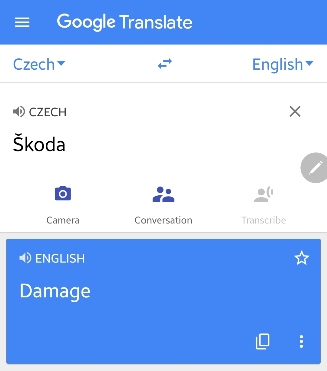

Why? Just because... - Ε koda as a brand name: see picture attached π€£ and because of association with another attached picture π€£ - Diesel. Too noisy engines, like tractors π - Automatic. For lazy ******s π - My old car. Why the hell you asked that? πβΊ Mitsubishi Spacestar 2005 π₯°π How I managed to end up with Ε koda? Ε koda did worked well on design, I like the design of all models starting 2016 until now. Noise isolation pretty good to not care about noise engine, and diesel cost less than petrol. π And I kinda enjoying the fact that I can drink my coffee while I'm moving out at green traffic light. Or just enjoying picking my nose while moving in stop and go traffic -dsg do all the job.. π I'm tall - 1.93m with driver seat full back, still have space for myself behind driver seat. How spacious is that! π€ͺ Looks like I have something to say, I was wrong in my first greeting post π
