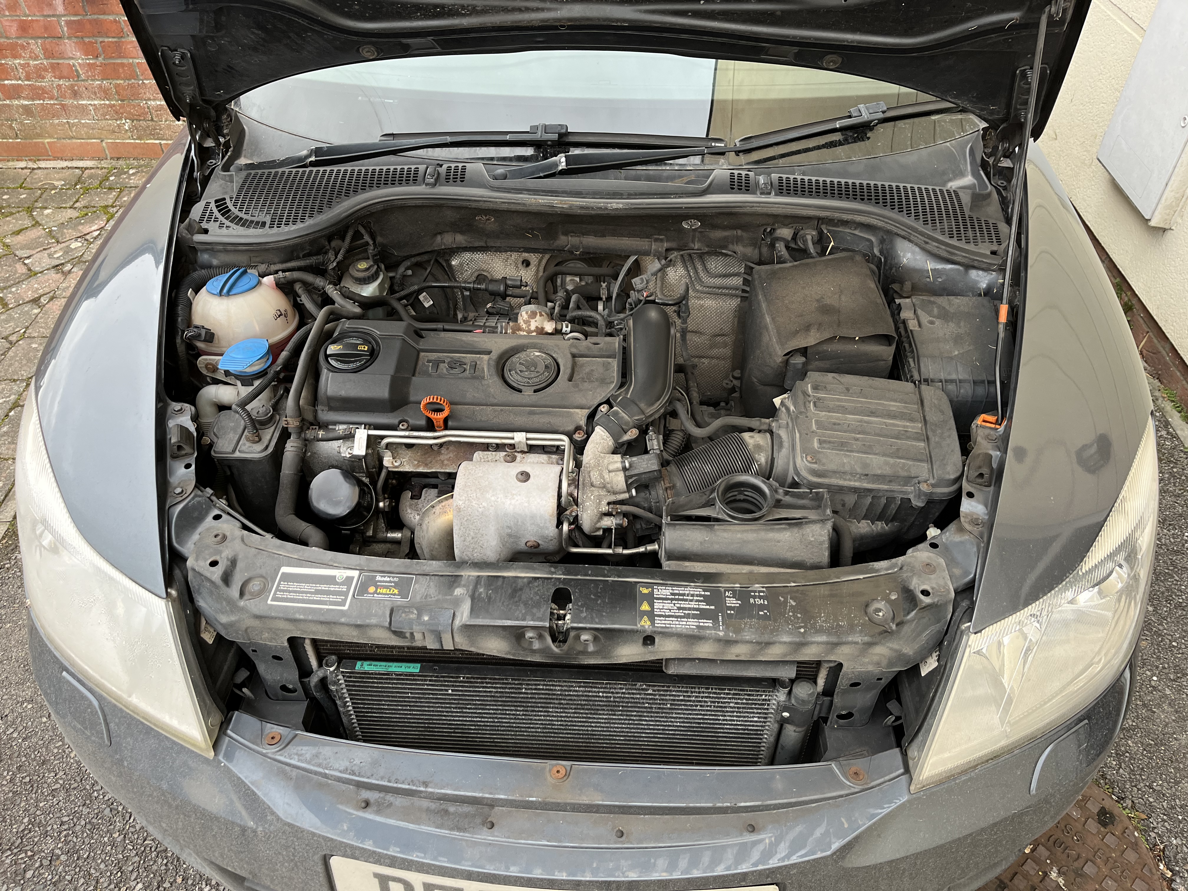

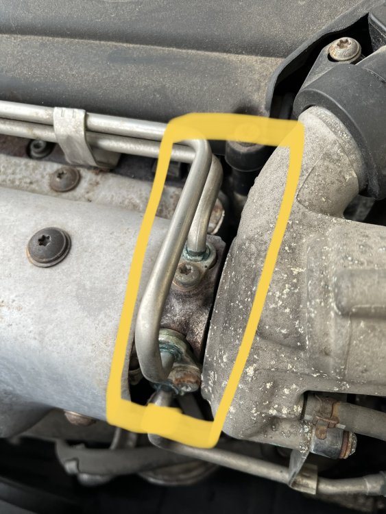

  2. Hi all, Please could someone possibly help me with the following issue. I have a Skoda Octavia 1.4 tsi dsg (2009). After fairly short runs of around 20 miles there is a weird smell coming from the engine. When I look under the bonnet, it’s coming from an area at the front of the engine (looks like two small metal pipes coming out of the are). Is very lightly smoking (sort of whispery smoke) and a strong smell. Nearest I can describe it is a burning electrical/metal smell. I’ve attached pictures to show the area I mean. It has been doing it a while so not sure if it’s designed to do it or not? thanks all 🙂

  7. Have got some turbo cleaner and had a look at running it through the other day. From researching online it looks like the turbo is at the back of the engine and the below pipe in black feeds into it? Just to make sure I’m not being a total numpty, but assume it’s just a case of undoing the screws arrowed and then spraying into the inlet at the top (i.e. where the top arrow is)? Have tried also to arrange for a mobile mechanic to come out and take the old turbo off/instal the refurbished one but it’s been a real pain trying to get one to get back to me!
