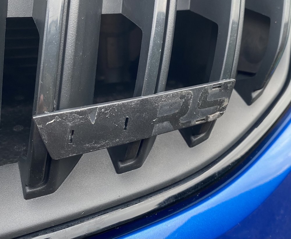

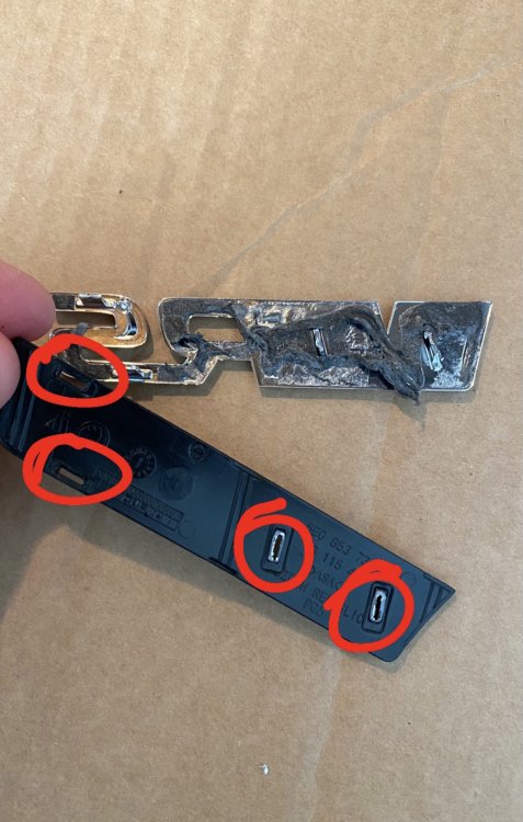

Front Grill VRS emblem
Part number for the front vRS badge I ordered for my facelift is 5E0 853 736 C 9B9, hope that helps. Regarding folks questions on splitting it from back plate, see pictures. 4 ‘pins’ that align it on the plate, then Skoda’s crazy adhesive.
