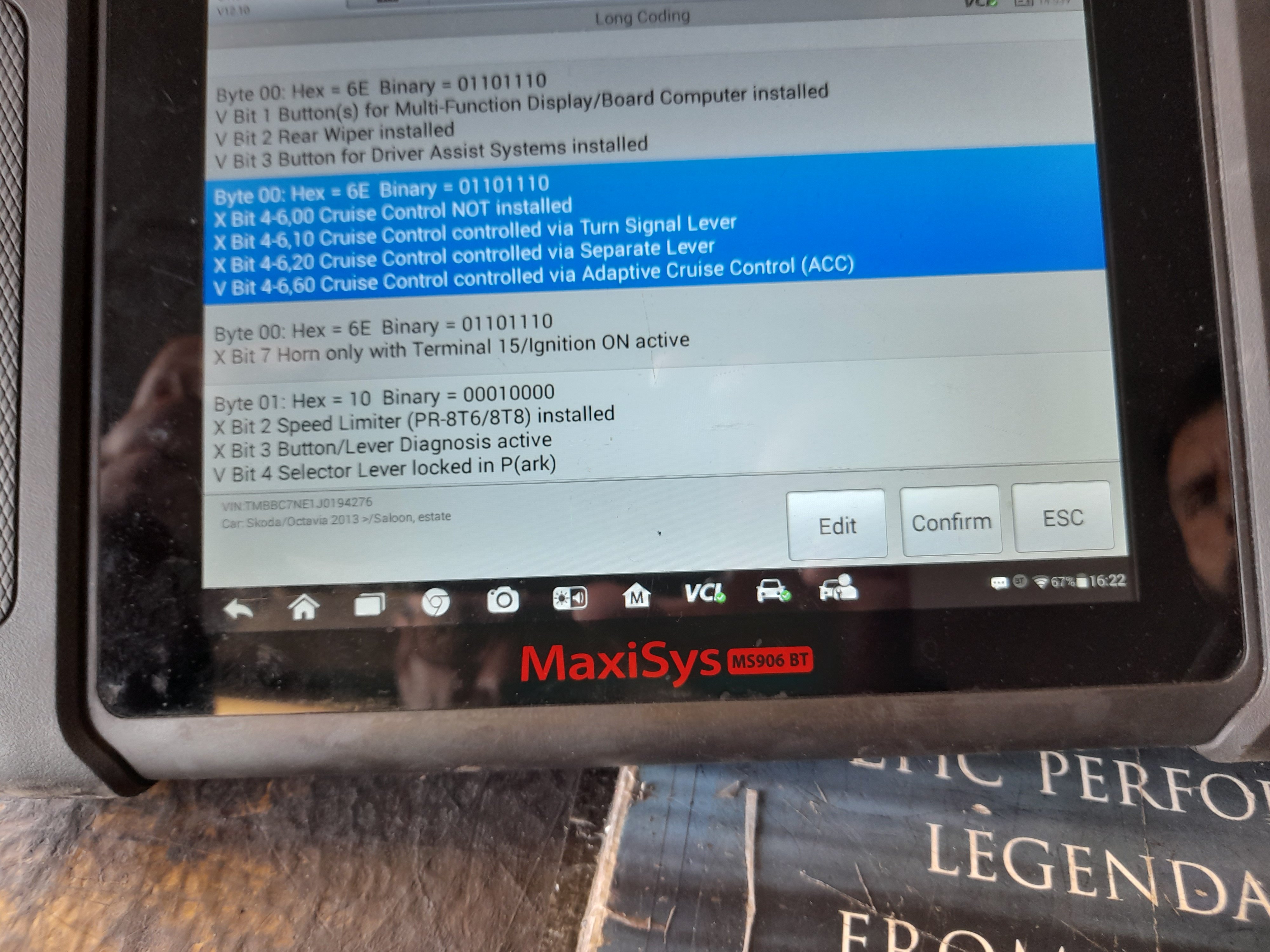

  1. Car back from Skoda. Cruise control codes were wiped prior to my ownership! Skoda managed to restore so all good. Thanks for all advice and help.
  2. Thanks for the suggestions. I may have to bite the bullet and begrudgingly go to Skoda. Thanks again for your help. Will post the results when known
  3. Thanks, wasn't sure what to put! It's DSG has Mfsw but no assistance menus like lane assist. The garage I use are good but haven't got vcds to produce the code. Apparently they need the code to programme the module? Nothing has been changed or replaced . No coding was.available so build code needed to reset CC. Thank you
  4. Hi. Please can anyone. Driving me crackers. The garage need a build code and or steering wheel module code for 2018 octy with cruise control (not ACC)) so they can reset . The picture below is what is showing on their reader. It may have been set historically for ACC when it does mot have it. Trying to avoid Skoda charging me £££ for code as I'm skint at the mo. Any help would be greatly appreciated. 😊
  5. Found out the wrong battery was fitted by previous owner. AGM battery is the solution. Thanks for all the help and responses

  9. Thankyouforyourresponse. It had the EPC cleared at Skoda and they said low voltage was the problem but I think the battery is fine. No loss of power etc. Don't have radar CC. . Back to Skoda I guess

  11. This message appeared when activating cruise control. Also the cruise control symbol was white in colour with an exclamation mark. Sometimes start stop shows error. Just to complicate matters the EPC appears randomly but will usually go upon a restart ? Would be grateful for any feedback .
