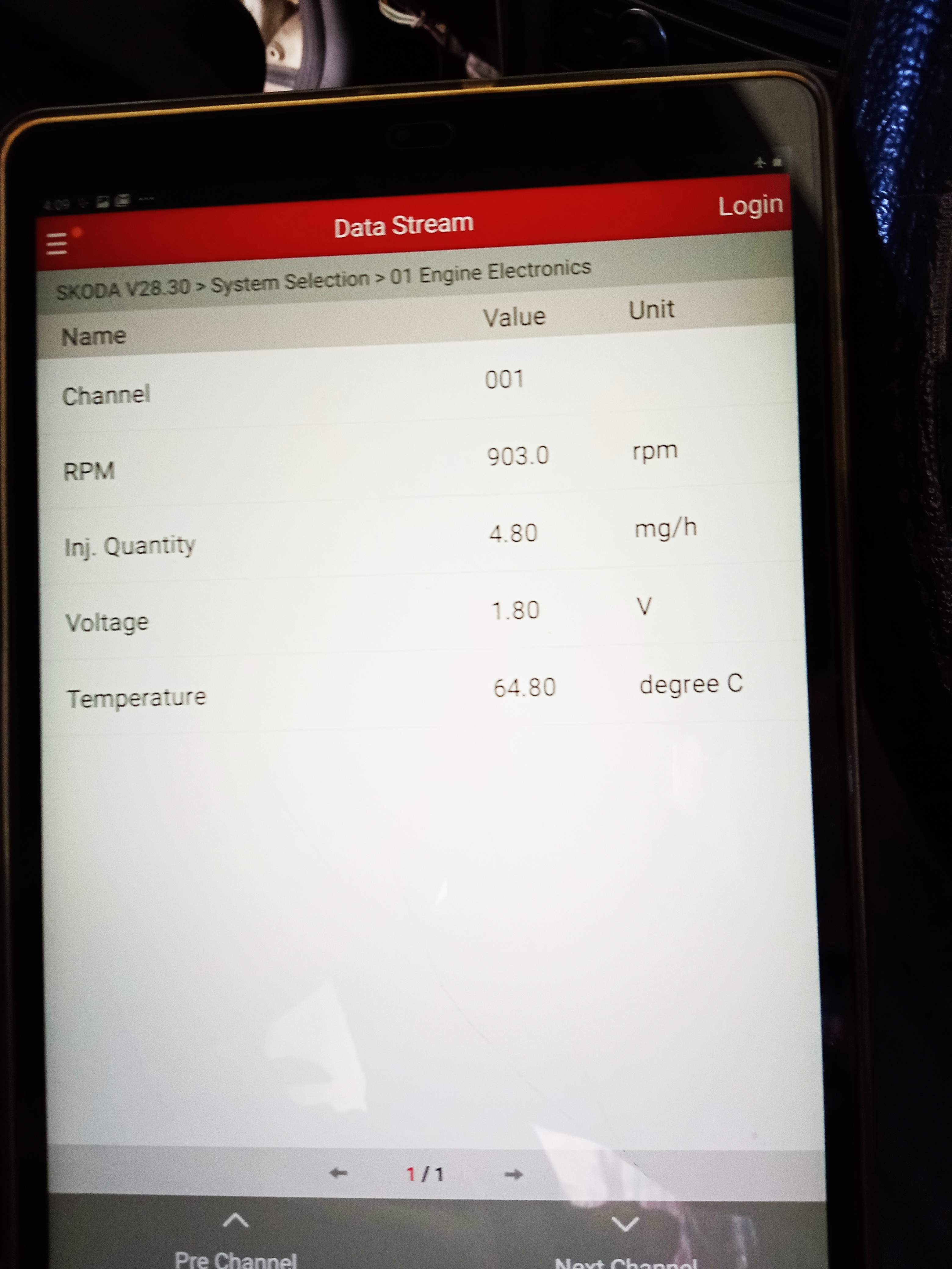

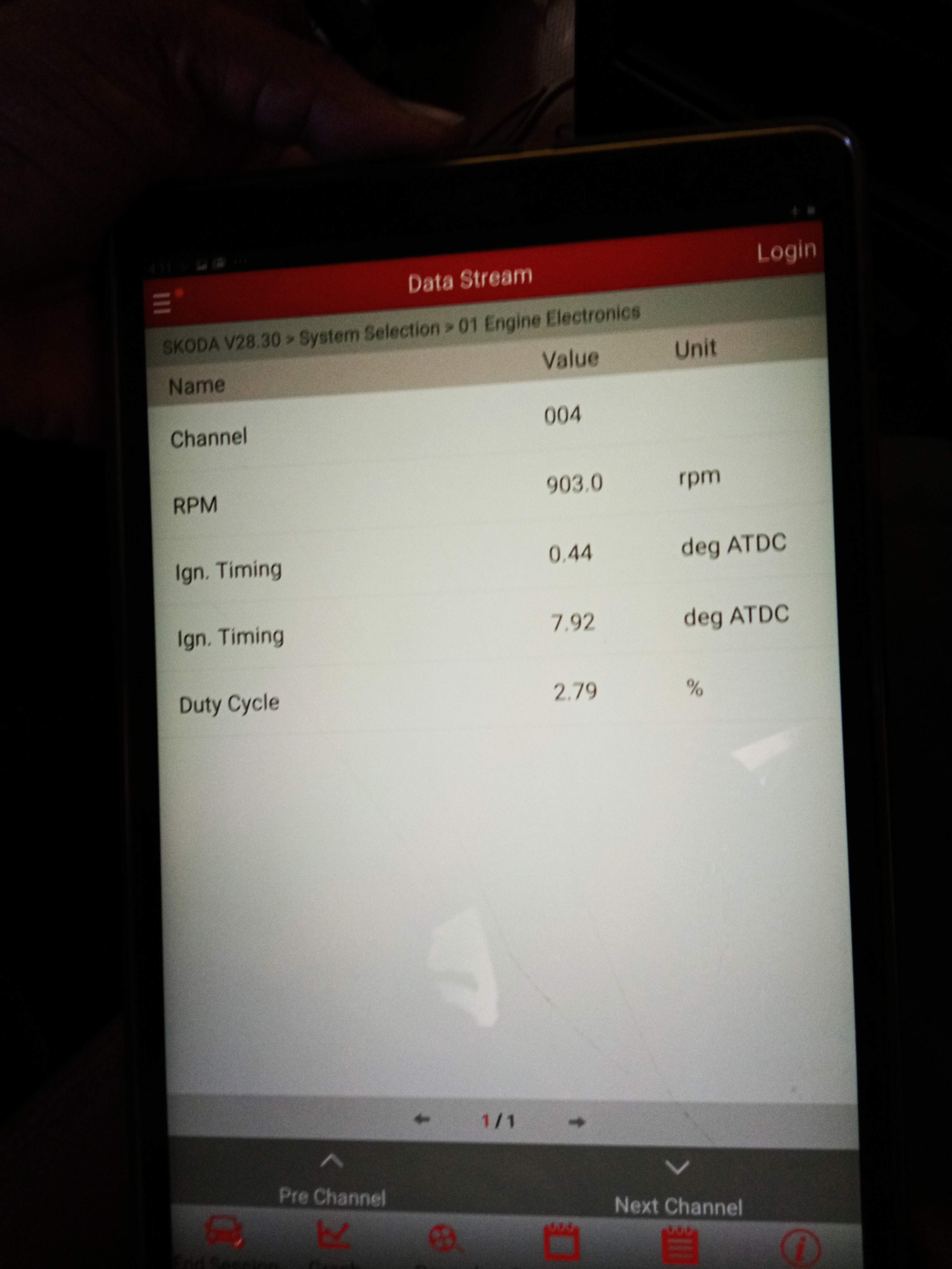

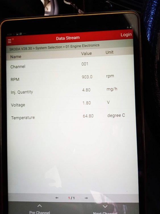

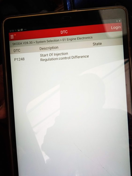

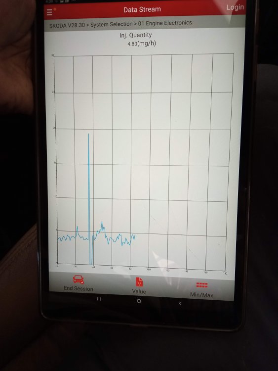

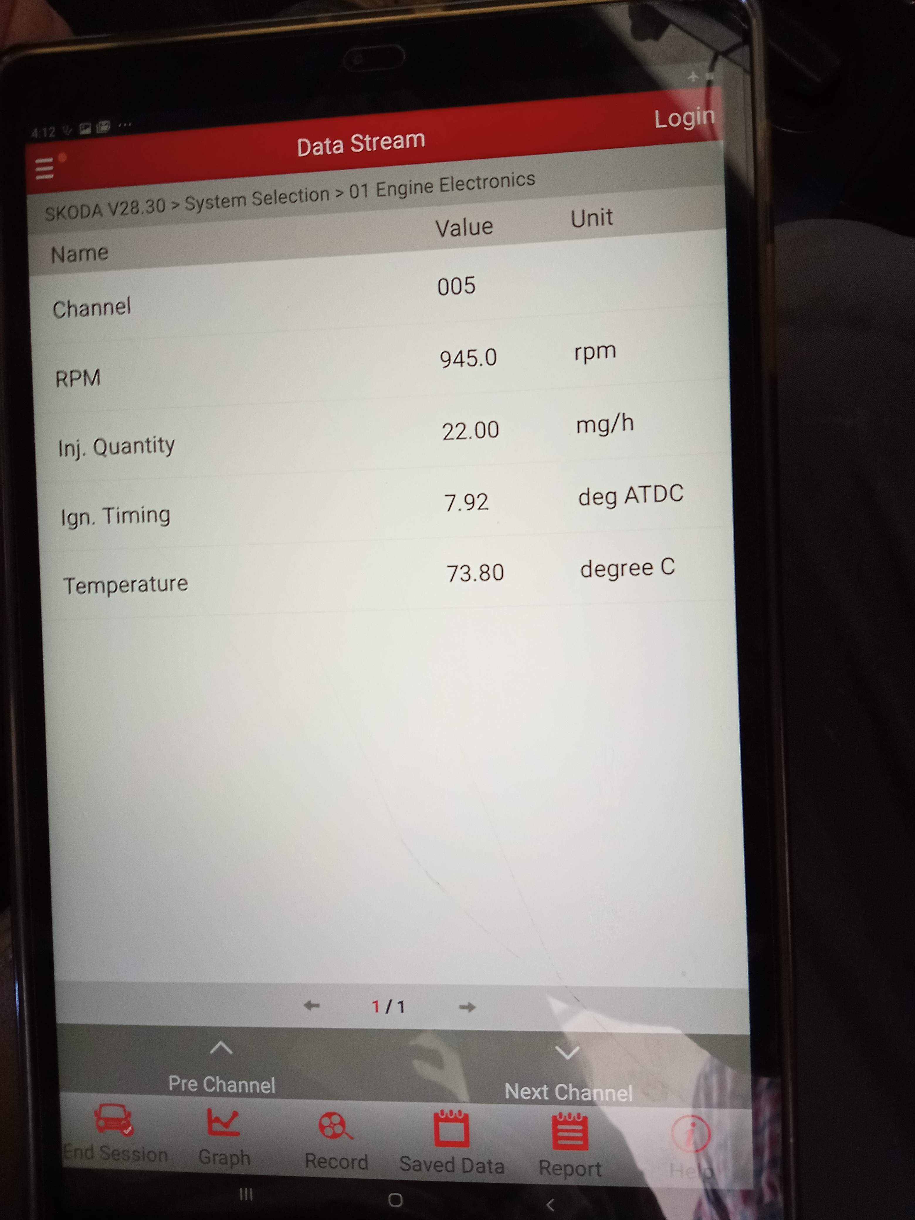

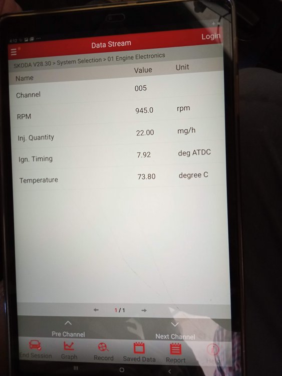

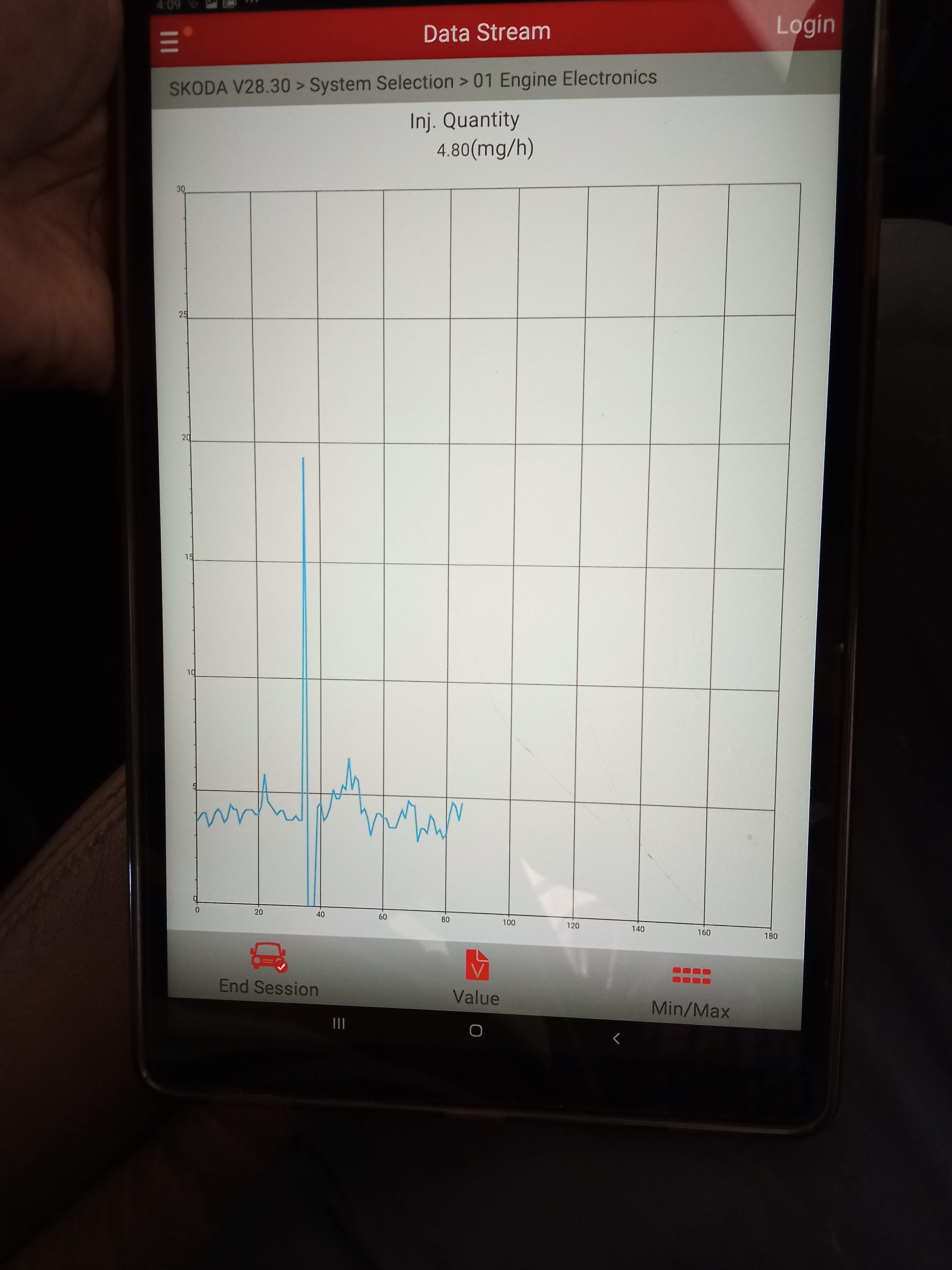

  11. EGR cleaned, Airflow sensor cleaned. I did decarbonizing using hydrogen liquid and gas recently. Nozzles were serviced. RPM is normal. It show 600 because the needle rests below zero rpm. The latest scan result shoes P1248 error. I have attached the scan result images. The fuel supply is erratic, the graph is evident. When accelerating, fuel consumption decreases (as per scan tool readings) and when deceleration, it increases. At idle injection quantity is 3.4 to 4.8 mg but suddenly shoots up to 22 mg. No air bubble in fuel line. When I advance timing, car starts in one crank but later it takes 3-4 cranks. Car jerks while releasing accelerator. Both at slow speed and high speed fuel supply is intermittent and no response to acceleration at times. Timing is inconsistent. I suspect it to the problem with ALH Pump Pressure Valve. Please advise.
