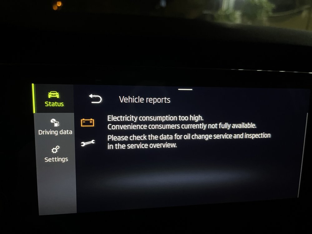

  1. I went to the agency and the removed the error using laptop
  2. I did it with a black sticker in egypt it cost around (200 EGP= 10 euros)
  3. Hi There, i had an accident with skoda octavia Iv known as (Octavia A8) in Egypt some one hit me from the back so i changed the boot trunk , bumbper , parking sensors, seat belts , front grill but after i receives the car from the work shop i noticed a strange error on the infotainment screen as per the attached photo so does any one face this problem before its about electricity consumption too high & the automatic start stop is not working !!!!
