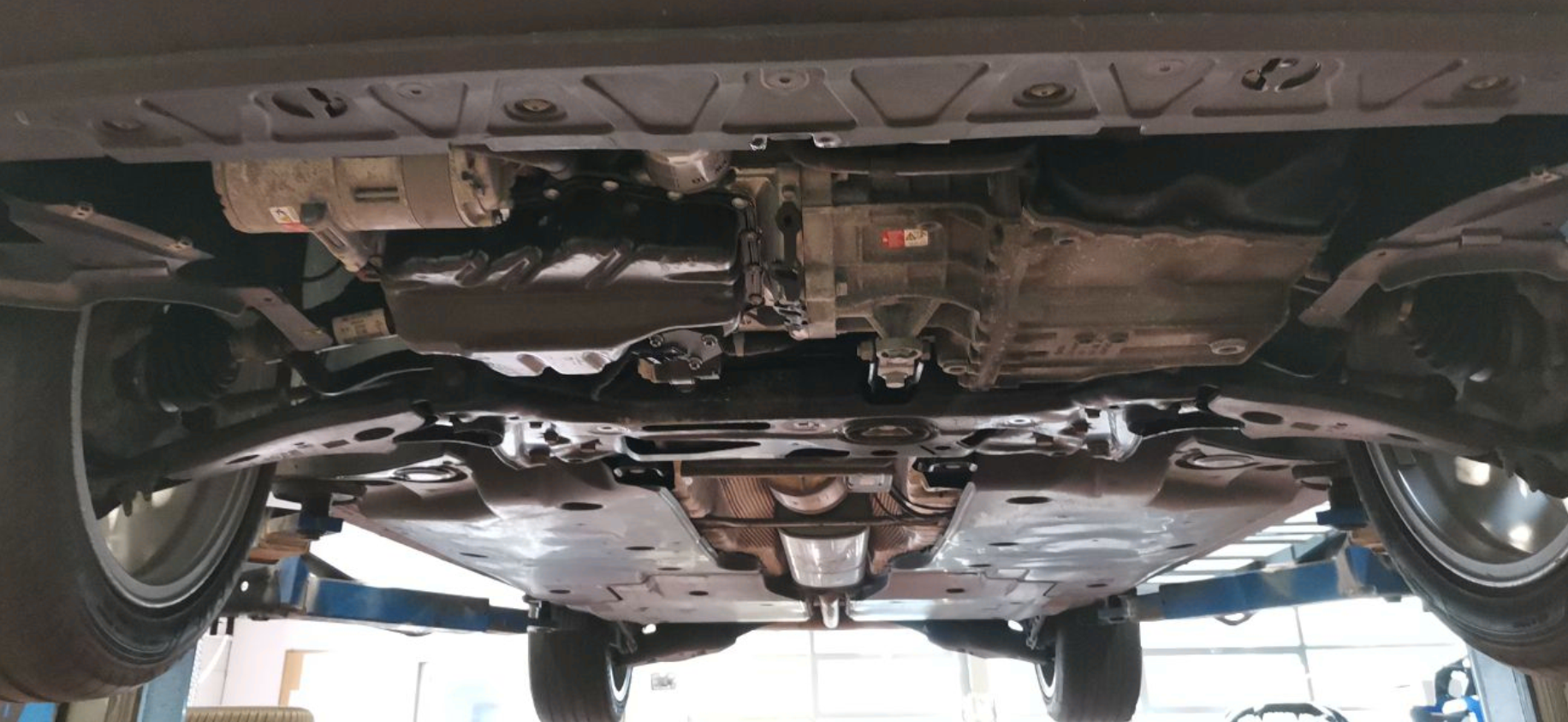

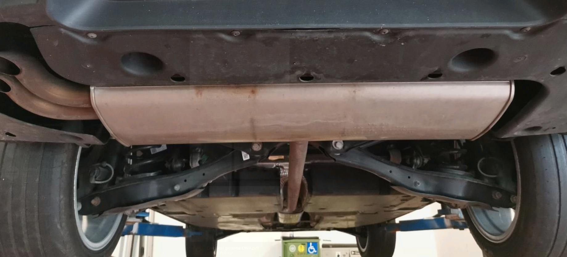

  2. I have pictures from the local Skoda dealer who sells the car. It looks good enough when it comes to bodywork, also the underneath seems to be good. My real worry is gearbox which Internet says is not very repairable, and also the state of the HV battery and the things around it (hear exchangers, AC compressor, cooling system, etc.)
