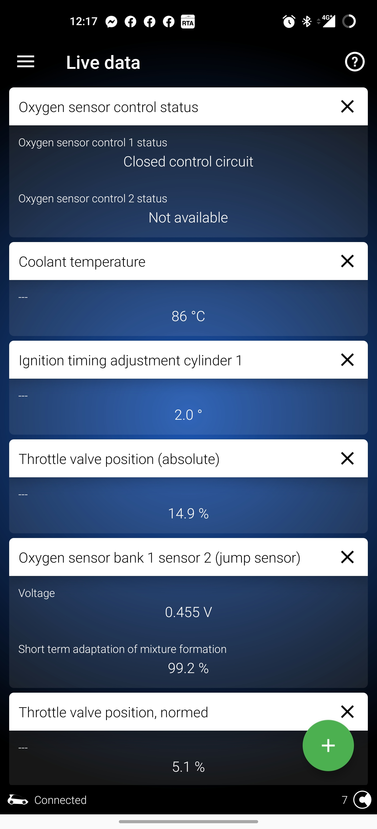

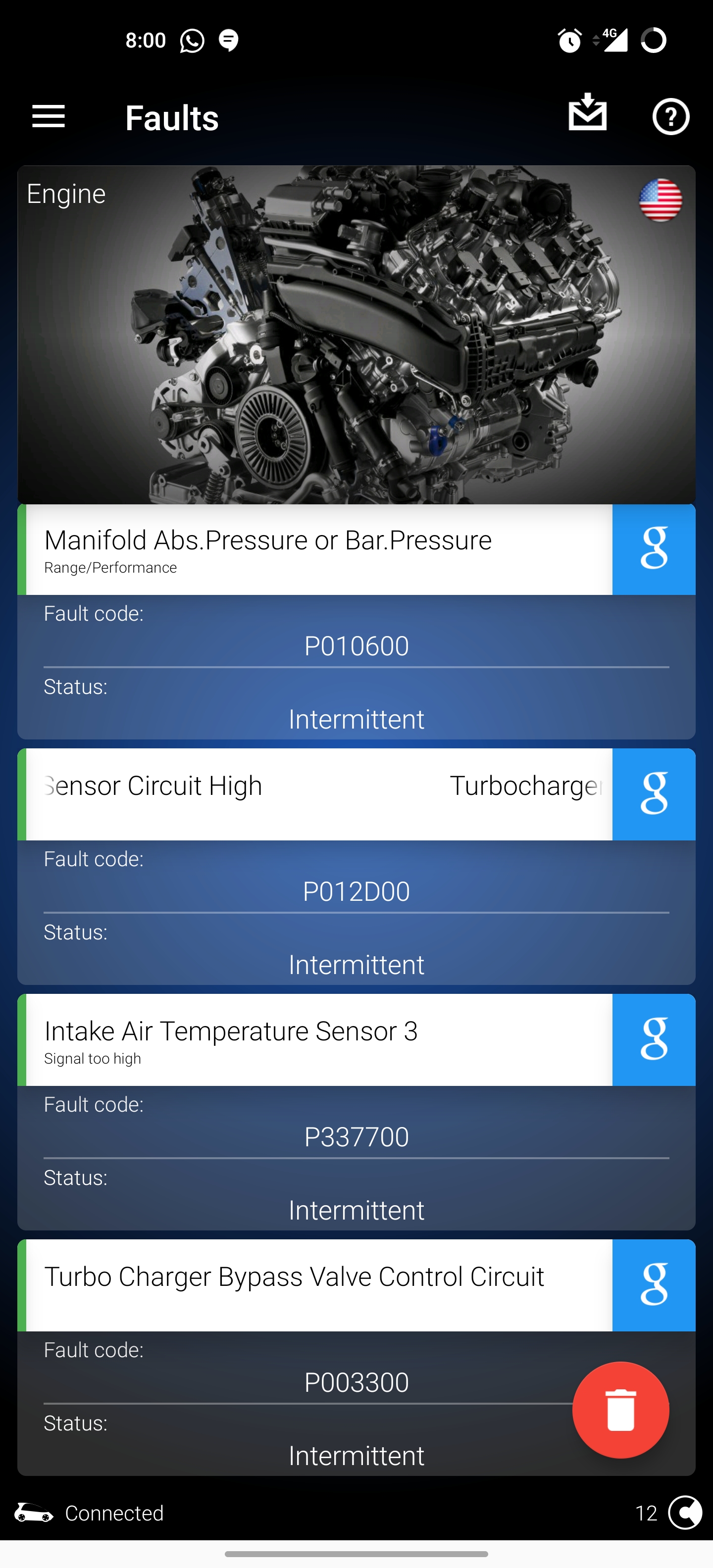

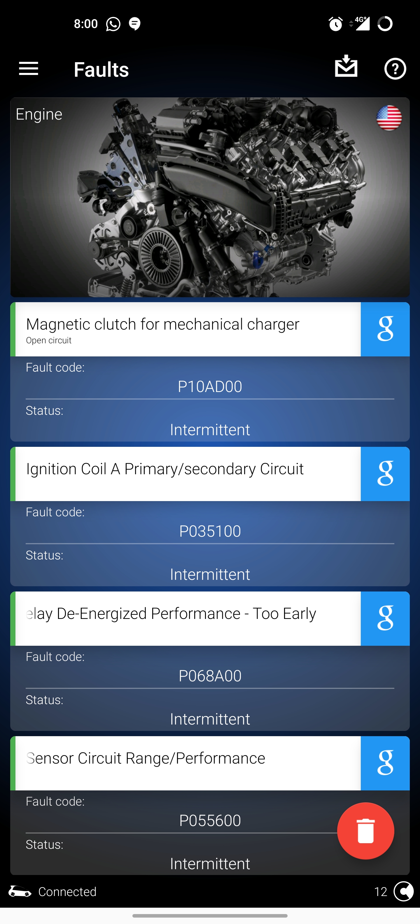

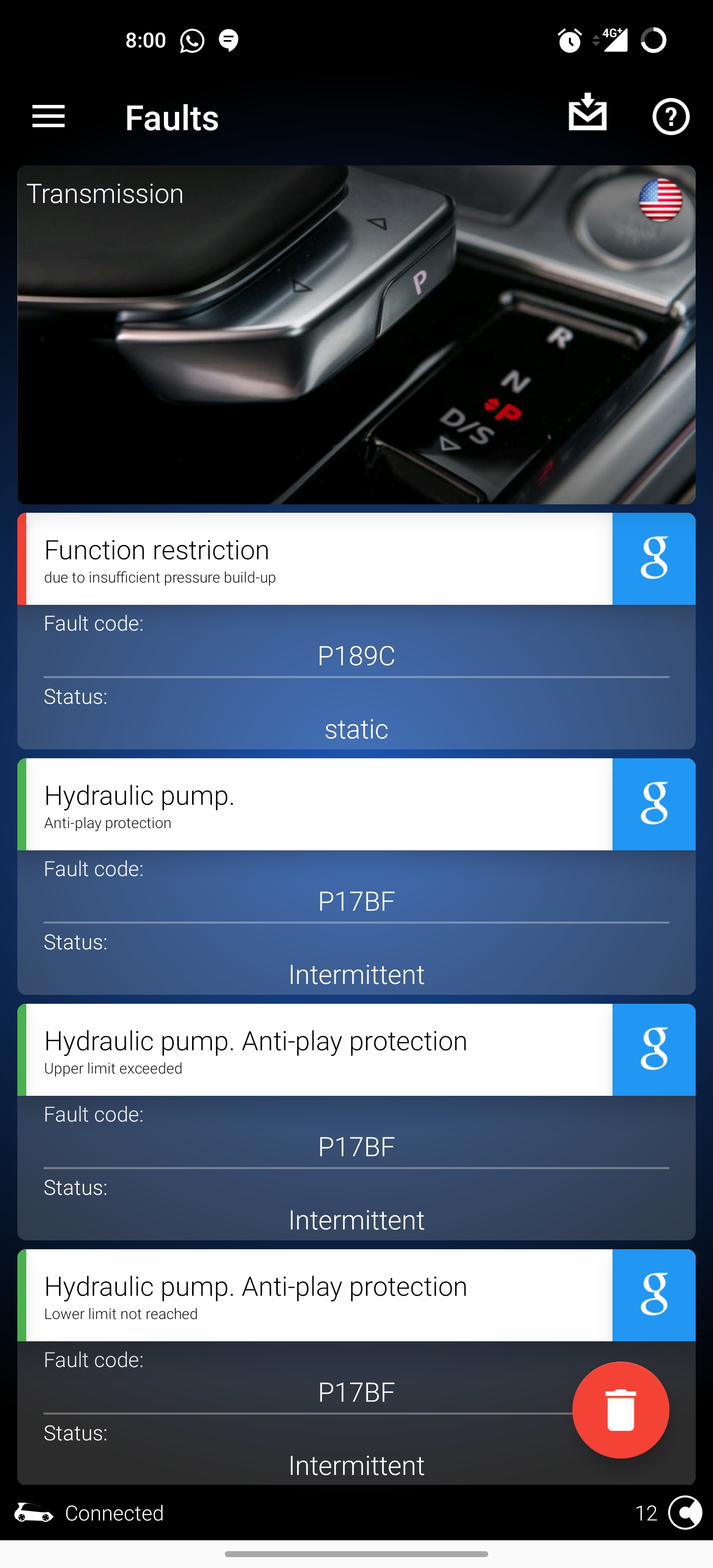

  3. Im not much of a car guy so please bare with me. First are missfires that i can literally feel specially on idle. I got the obd reader just today and when i used it the missfires misteriously lightened. At times the car runs smoothly that i thought its not turned on until another engine hiccup.
  4. I wouldnt dump it and will be returning it to owner as discussed with him. I found broken connectors of the coils or the coils could be bad or the plugs. Could be causing the misfires. Mechatronics got checked already and needs replacing... Other codes i havnt figured

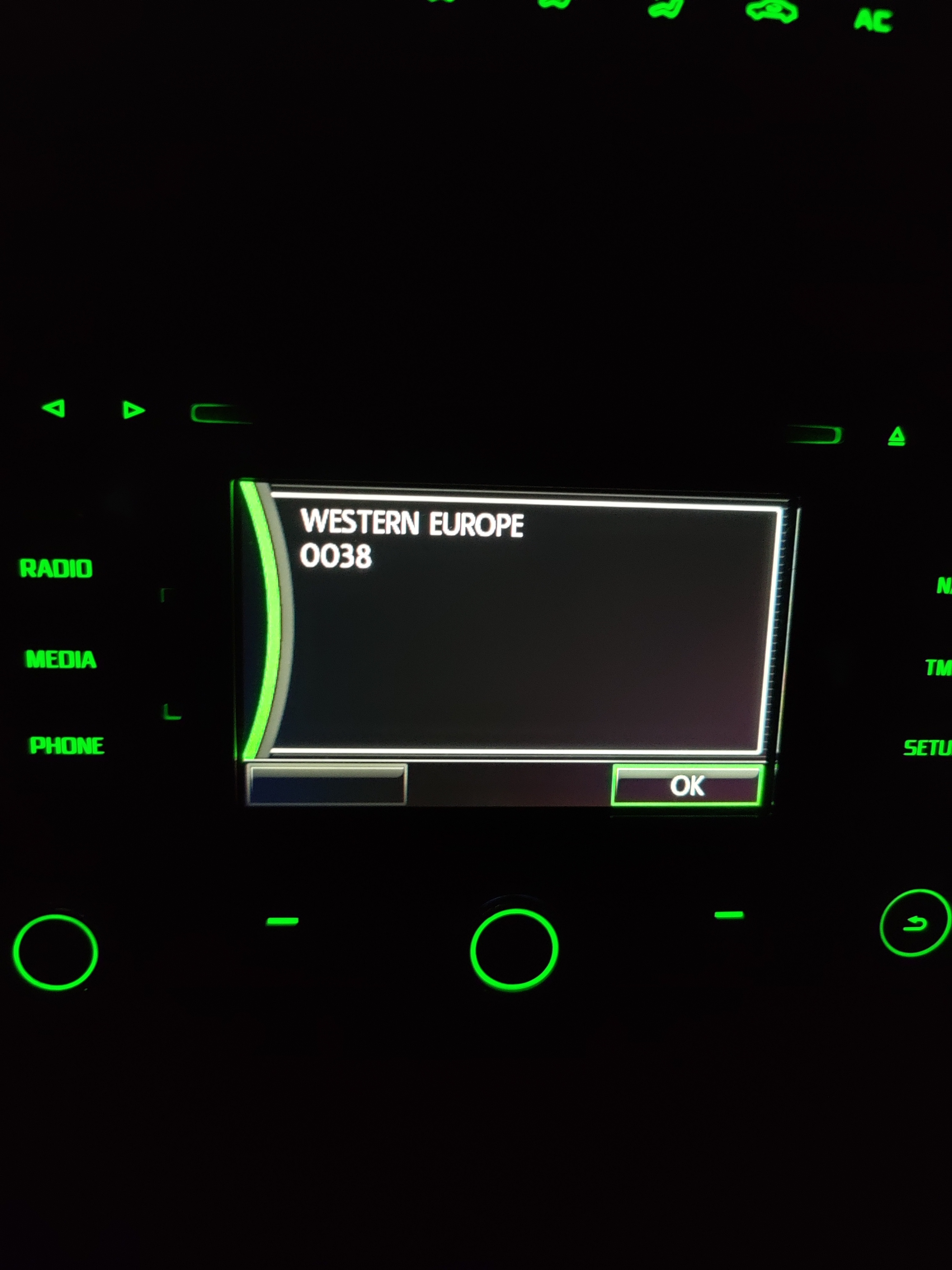

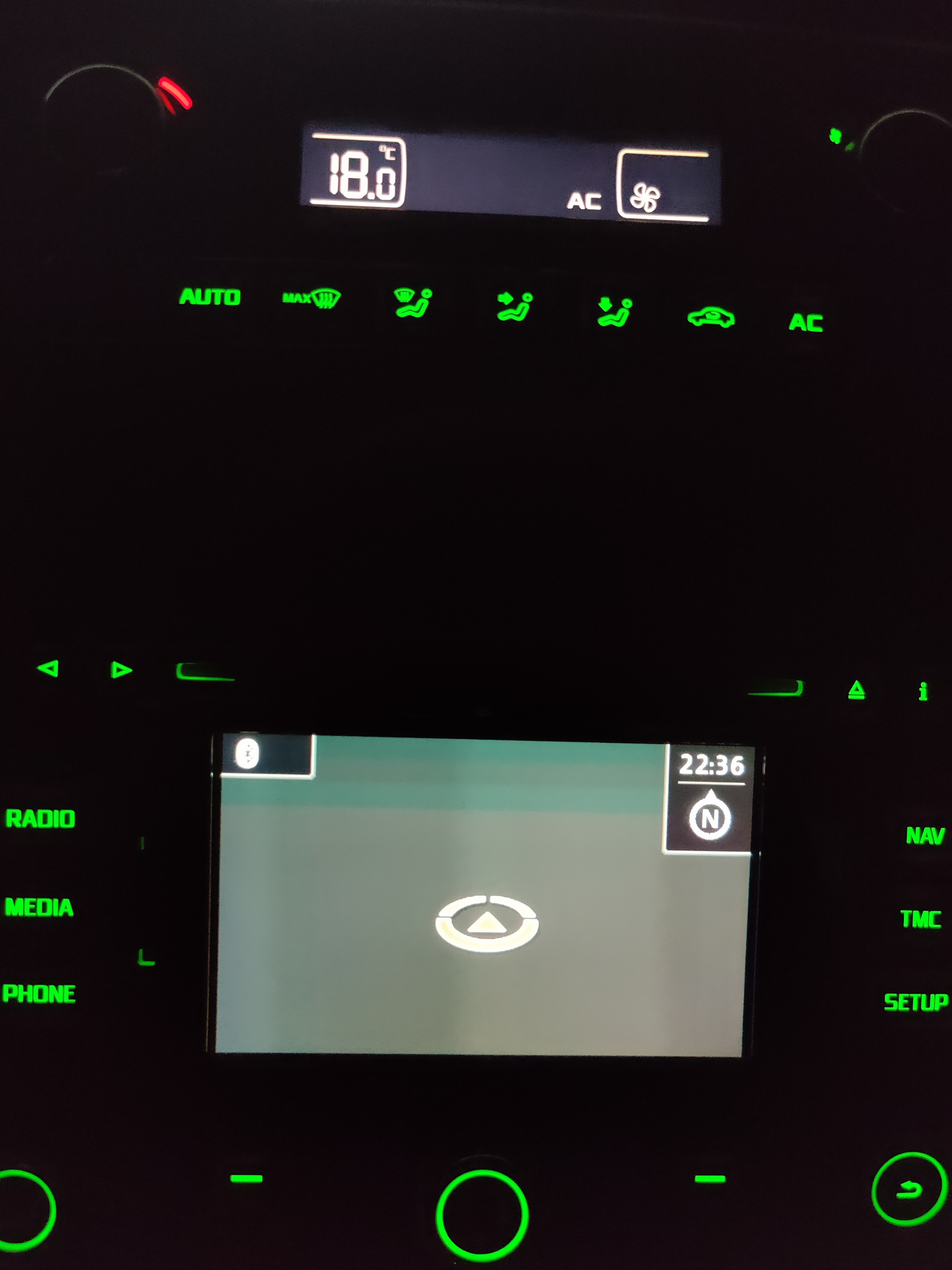

  6. I am in the thinking of these nav systems having the the world map available in system. And withe specific update with euro maps hence the question.
  7. Uae is in the middle east
  8. I have a 2012 vrs fabia and the satnav is not working. Map not showing but it tells me my exact location. Im in united arab emirates.
