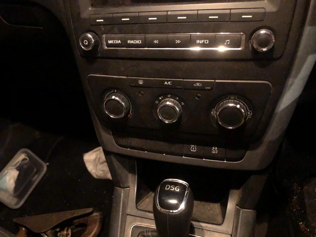

  1. thanks for your help everybody. i bought this part - SKODA Octavia 2013 HEATER CLIMATE CONTROL BUTTONS 3T0820047AK from eBay / recycling place in Bradford and that cured the issue. Thanks,
  2. Thanks for that, I think the unit is differed, no display as such, just dials as photo
  3. Help, hope this isn’t duplicates as I’ve asked in the yeti forum as well. my friends 2014 1.2 Yeti has an issue with the heating/ aircon control, it spins freely left and right but seems to select a temperature at random. Turning the heat down and selecting aircon doesn’t help, sometimes it gets colder, other times it stays the same, other time it gets warmer. has anyone had same problem and know a solution ? thanks in anticipation, Simon
