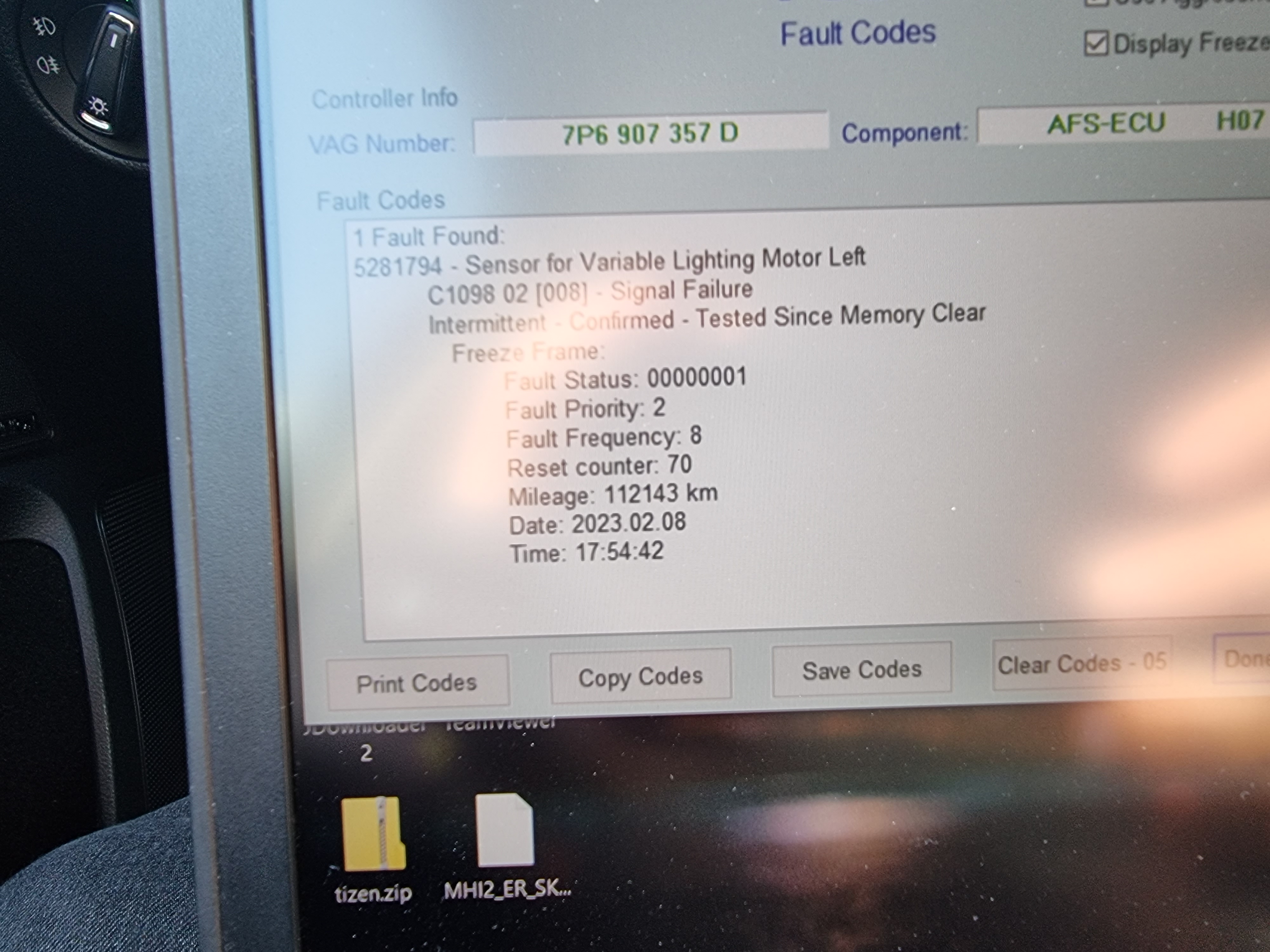

  1. @gnuttisch any update? did the error moved to the other side?
  2. 🤣 Mine in the morning complained and in the evening, all good 😑. How long did it take? Any photos during the process? Let me know if the error moves to the other side.
  3. Thanks for the info! I will give it a try with swapping the modules... One more thing. I will post it here, to not create another topic. So, I did a full scan and some other errors showed up: Address 01: Engine (J623-CJXA) Labels:. 06K-907-425-V1.clb Part No SW: 3G0 906 259 B HW: 06K 907 425 B Component: 2.0l R4 TFSI H13 0002 Revision: --H13--- Coding: 0A1D00322476010B3000 Shop #: WSC 33361 790 00063 ASAM Dataset: EV_ECM20TFS0203G0906259B 001003 ROD: EV_ECM20TFS0203G0906259B.rod VCID: 2B55B2AB420539D346-807E 2 Faults Found: 15446 - Blocking Valve for Coolant (N82) P1889 00 [032] - Open or Short to Ground Intermittent - Not Confirmed - Tested Since Memory Clear Freeze Frame: Fault Status: 00000001 Fault Priority: 2 Fault Frequency: 3 Mileage: 112163 km Date: 2023.02.09 Time: 16:45:02 Engine RPM: 1115.00 /min Normed load value: 31.4 % Vehicle speed: 0 km/h Coolant temperature: 40 °C Intake air temperature: 17 °C Ambient air pressure: 1030 mbar Voltage terminal 30: 14.726 V Unlearning counter according OBD: 33 Engine: operating status: IS STATE_LS_SAE[1]: CL T_AST_SAE: 33 s MAP_MES_SAE: 50 kPa Lambda probe voltage: bank 1: probe 1 (broadband probe): 1.938 V FAC_TPS_1_SAE: 15.625000 % FUP_H_SAE: 4800.0 kPa 15209 - Oil Pressure Regulating Valve P164E 00 [109] - Electrical Malfunction Confirmed - Tested Since Memory Clear Freeze Frame: Fault Status: 00000001 Fault Priority: 2 Fault Frequency: 1 Mileage: 111466 km Date: 2023.01.10 Time: 11:06:15 Engine RPM: 775.25 /min Normed load value: 16.1 % Vehicle speed: 0 km/h Coolant temperature: 100 °C Intake air temperature: 40 °C Ambient air pressure: 1000 mbar Voltage terminal 30: 13.320 V Unlearning counter according OBD: 40 Engine oil temperature: 96.0 °C Time since engine start: 695.1 s T_ES: 0 min MAP_MES_SAE: 29 kPa Engine: operating status: IS T_AST_SAE: 0 s ECU_STATE: SYN_ENG_IGK_ON Address 47: Sound System (J525) Labels:| 3Q0-035-466.clb Part No SW: 3Q0 035 466 A HW: 3Q0 035 466 A Component: MIB2_amp_P_SK H02 0250 Revision: 00000001 Serial number: SKZ8Z1GAS01RXWG Coding: 0384010000AA002FAA0000000000 Shop #: WSC 73430 790 00063 ASAM Dataset: EV_AMPMst16C5Gen2ALPI 001001 ROD: EV_AMPMst16C5Gen2ALPI.rod VCID: 2D51BCB37C1137E358-8078 1 Fault Found: 1559 - Cooling Fan for Housing B126B 01 [008] - Electrical Failure Intermittent - Confirmed - Tested Since Memory Clear Freeze Frame: Fault Status: 00000001 Fault Priority: 6 Fault Frequency: 5 Reset counter: 74 Mileage: 111722 km Date: 2023.01.19 Time: 18:37:01 Voltage terminal 30: 14.4 V Also, I have some oil residue near the oil cap, but it's not from it (I think, because I've bought a new one, replaced it, and cleaned the area). Any ideas? 🙈 Thank you for the help!

  5. I was hoping it was only a cable or something that is not wired how it should be...(because of the signal failure) To take the AFS modules out, I have to remove the bumper and the headlight, right? 😔
