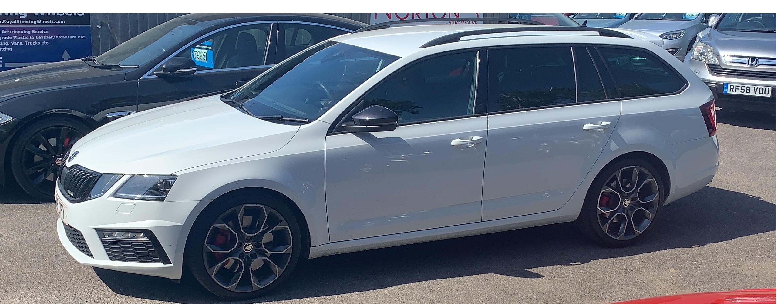

  8. Hello! Picked up a used white 2019 VRS estate (dsg + black pack) this week after hunting for a while and looking at various estates for a family car. Considered all sorts before settling on this, been (mostly) impressed so far. Have found a bit of a central locking issue which from searching sounds reasonably common on VW group cars so looks like it will be booked in to the dealer soon already (thankfully the car is still under warranty). Will start a seperate thread on the problem. Anyway heres a pic
