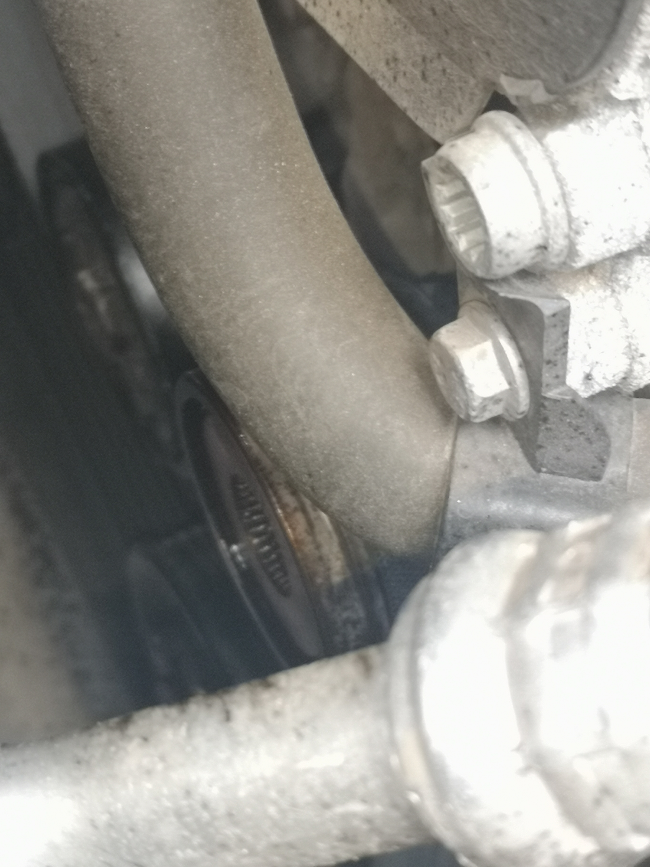

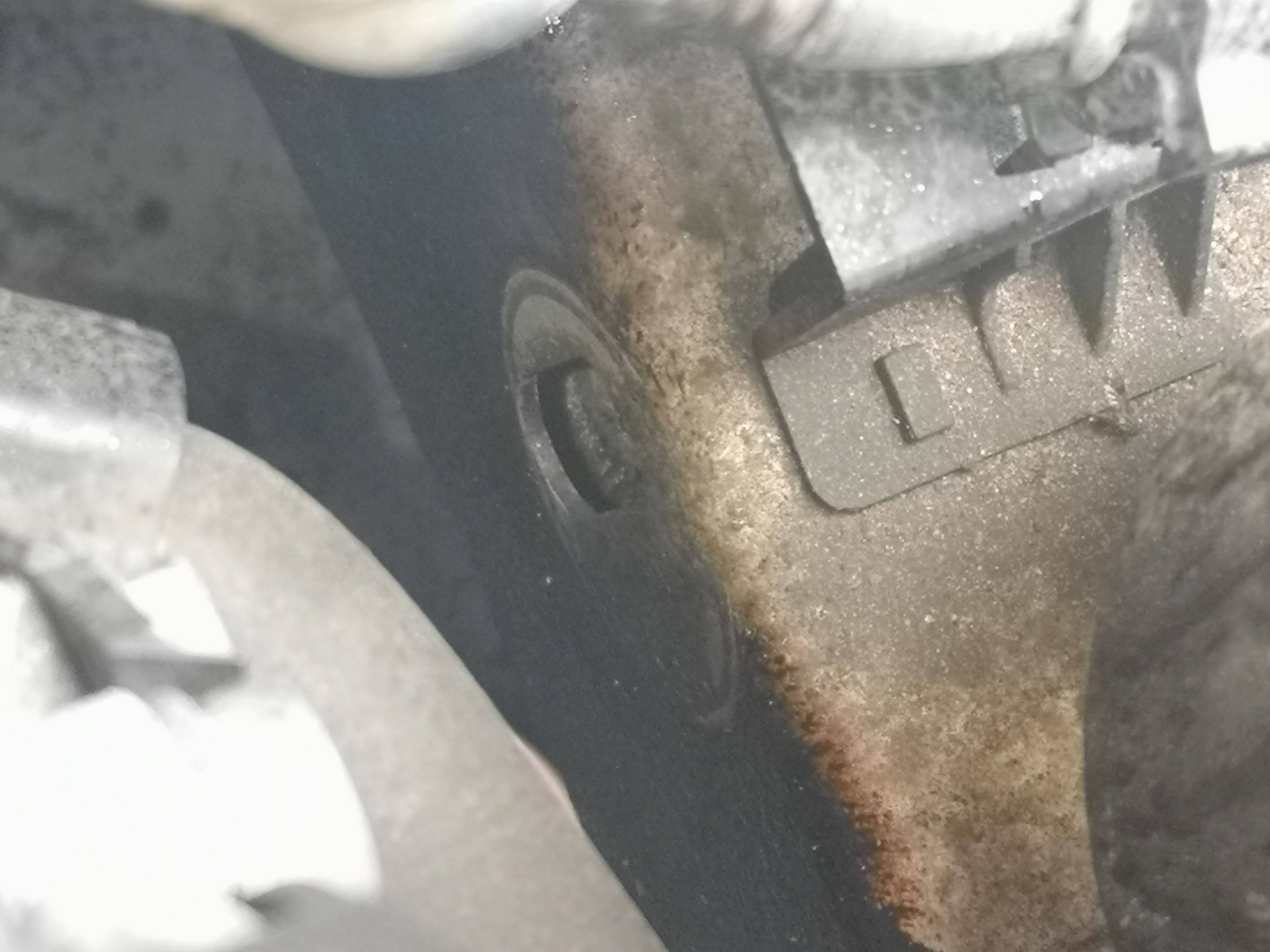

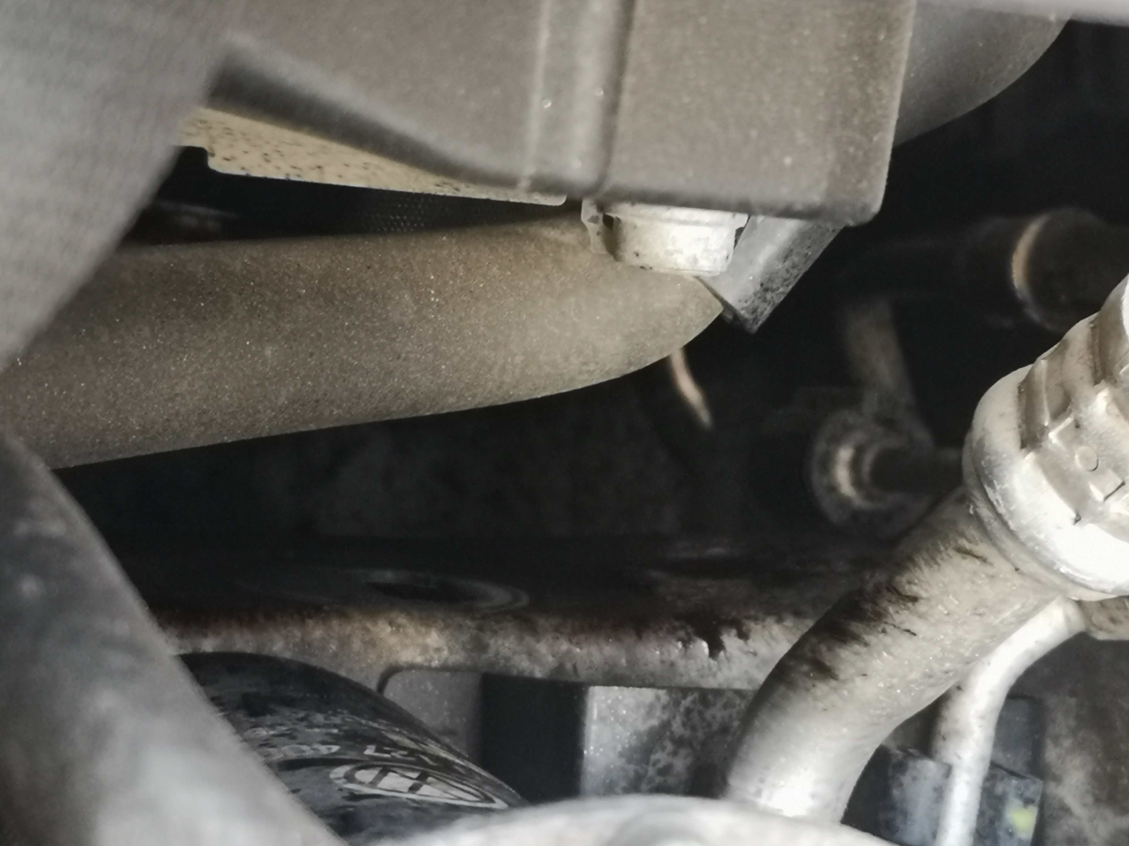

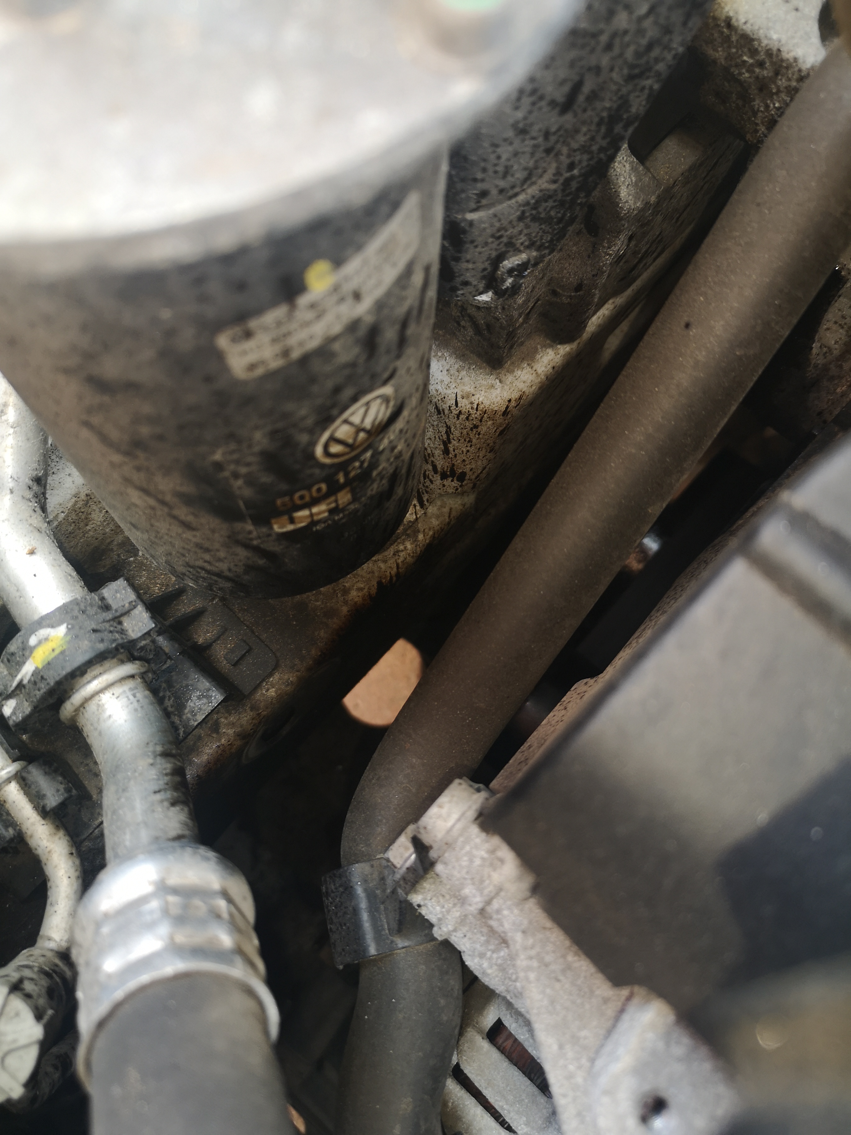

  3. Wife called me whilst driving to report the above, pulled over and nothing obvious to her and was driveable so she drove it home. Brakes and pads were fine, took it for a drive myself and felt fine however upon lifting the bonnet there is a lot of oil spray around the serpentine belt area with an (almost comical) outline of a circle directly opposite the alternator pulley. The EML is on, but it was on before and the code was for Glow Plug Cylinder 4 fault which I was going to swap out tomorrow. No additional codes thrown since this. Looks like something has gone pop and sprayed oil/grease down there onto the belt which has then chucked it everywhere but couldn't find a single source for it. The oil/grease itself has a reddish/brown tinge to it rather than black. Called local Skoda garage and they cant guarantee to even see it until the 24th but said leave it with them next week sometime and they'll try and squeeze it in, of course this happens <3 months after the warranty expires!
