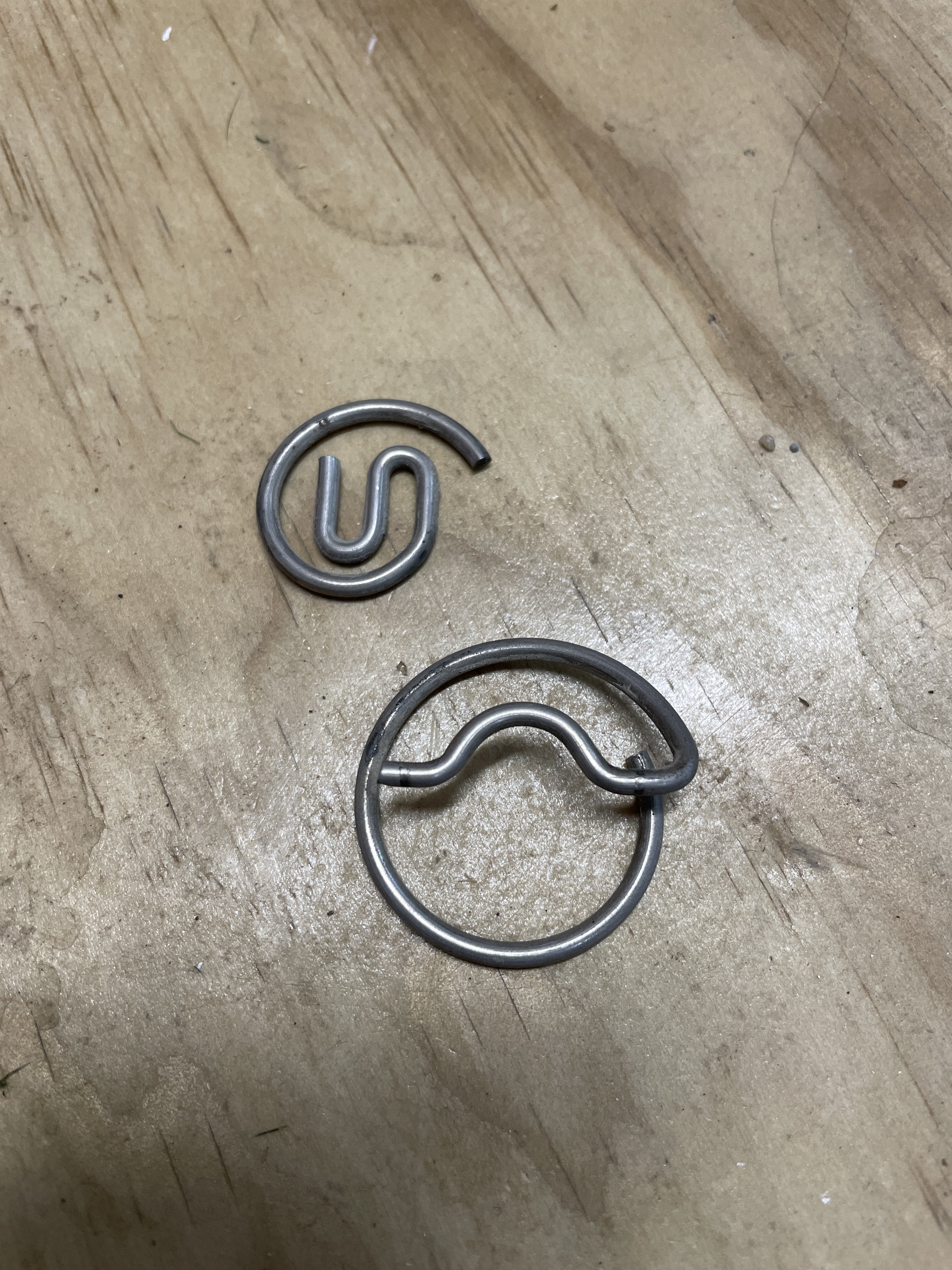

  4. Well I found the problem with the exhaust flaps at least (see attached image). The actuator spring is broken, which obviously explains why it wasn’t working! I can’t find the spring on its own to buy, so I’ll try tack welding it first, and if that fails I’ll buy a replacement actuator from overseas (I’m in NZ and it’s very hard to get parts here). So that helps understand the exhaust flap issue. Whether it’s at all related to the EPC issue who knows…..

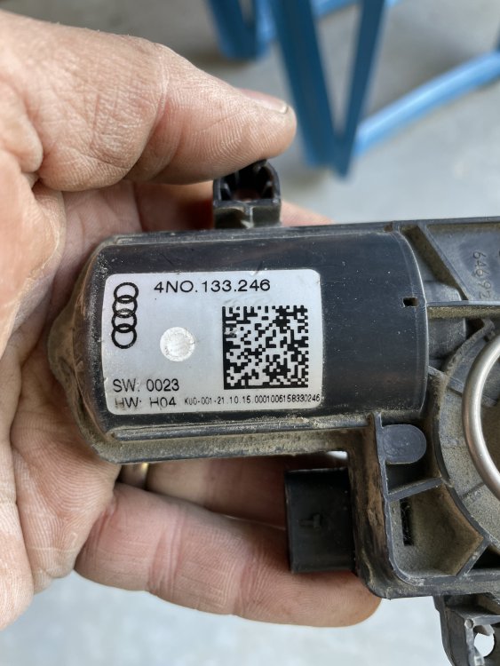

  6. This is the part I need to replace, but I’m struggling to find anywhere

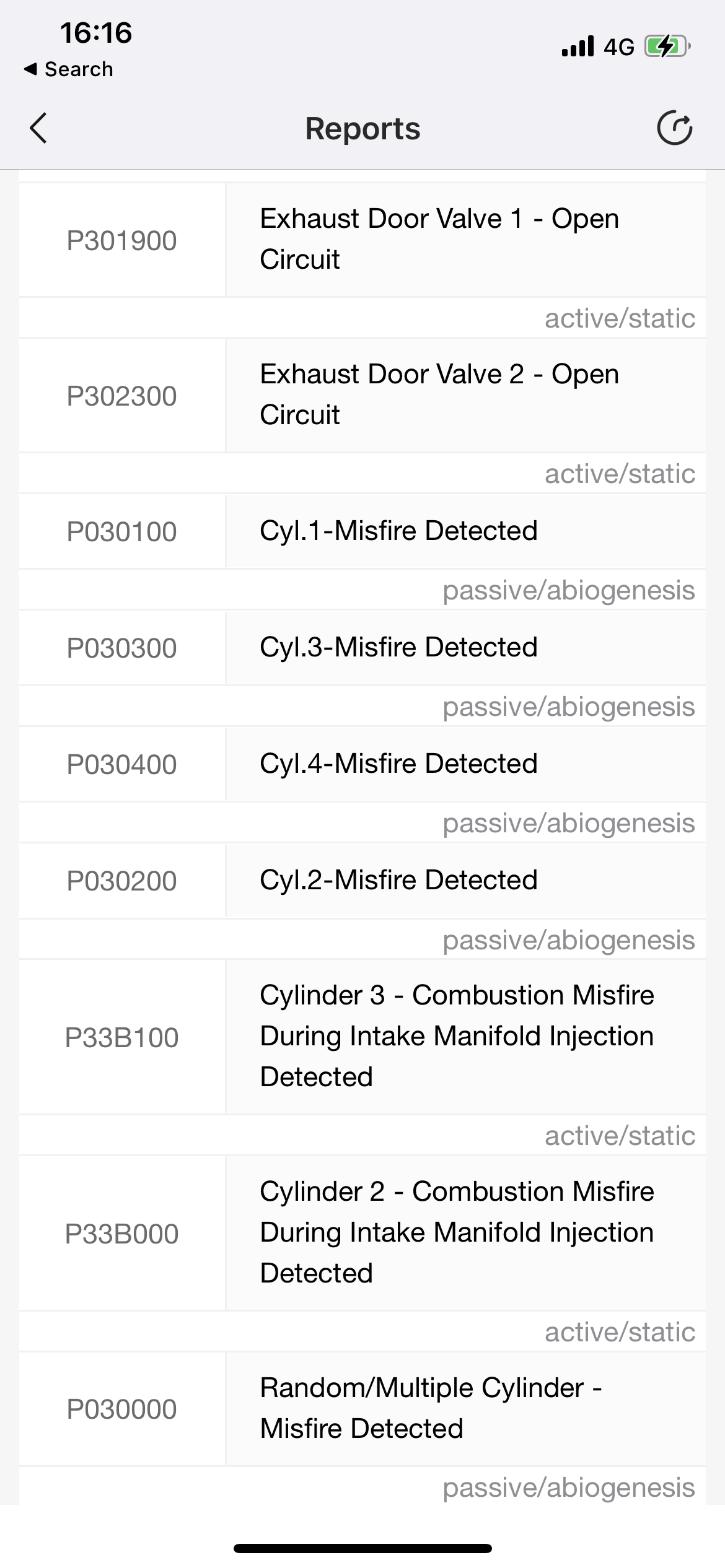

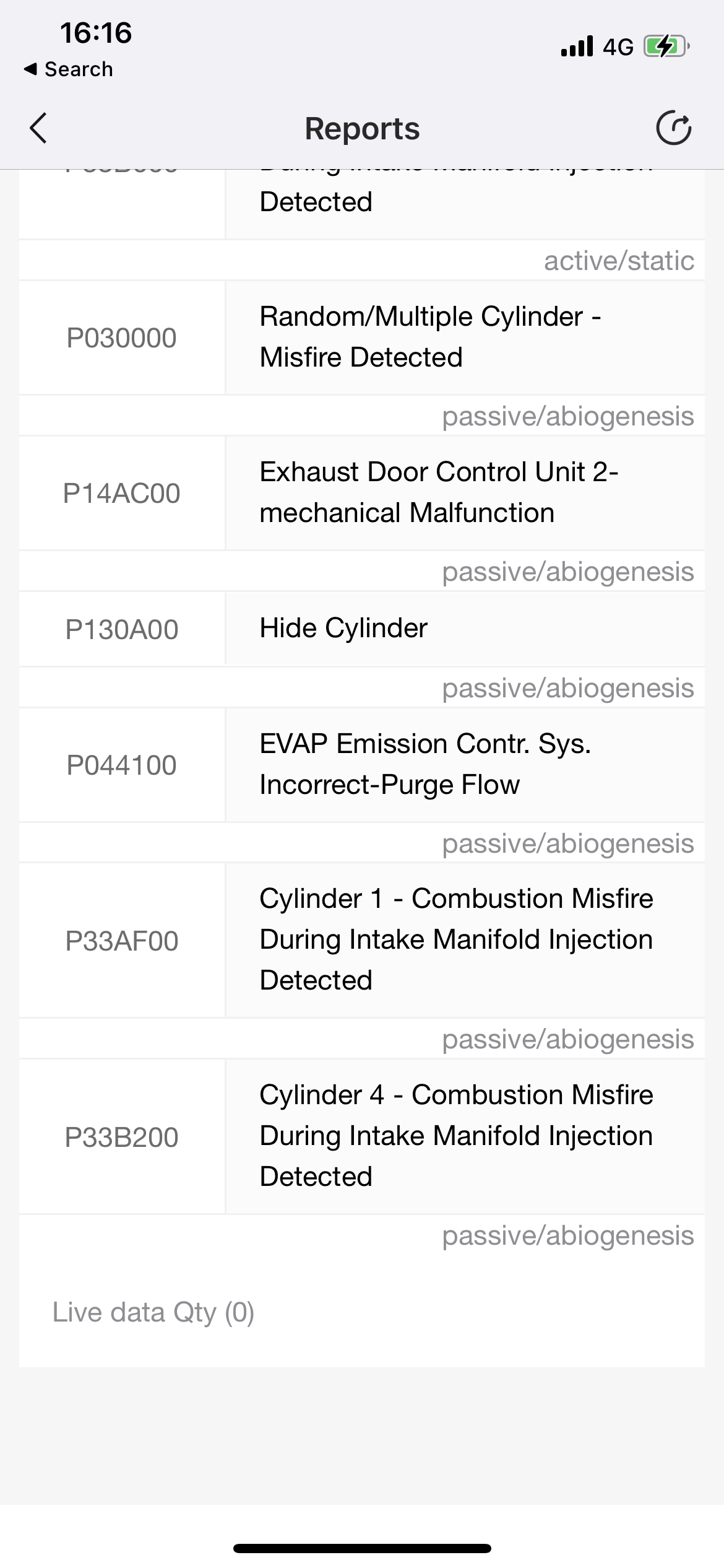

  11. Me again. Still haven’t got any further with this and the local service agent seems stumped. I’ve disconnected the connectors on both of the exhaust flaps and they are now permanently in the open position. It throws an error code about an open circuit but at least both flaps are always in the same position now. To be clear, I think this is entirely related to the EPC issues though. I’m still getting the same problem, whereby when I put the car in Sport Mode, the EPC light comes on and it starts running rough. Turn engine off, then back on again and it’s fine. Have attached screenshot of the fault codes. Nobody seems to know what to do next. Have new coils and new plugs already.
