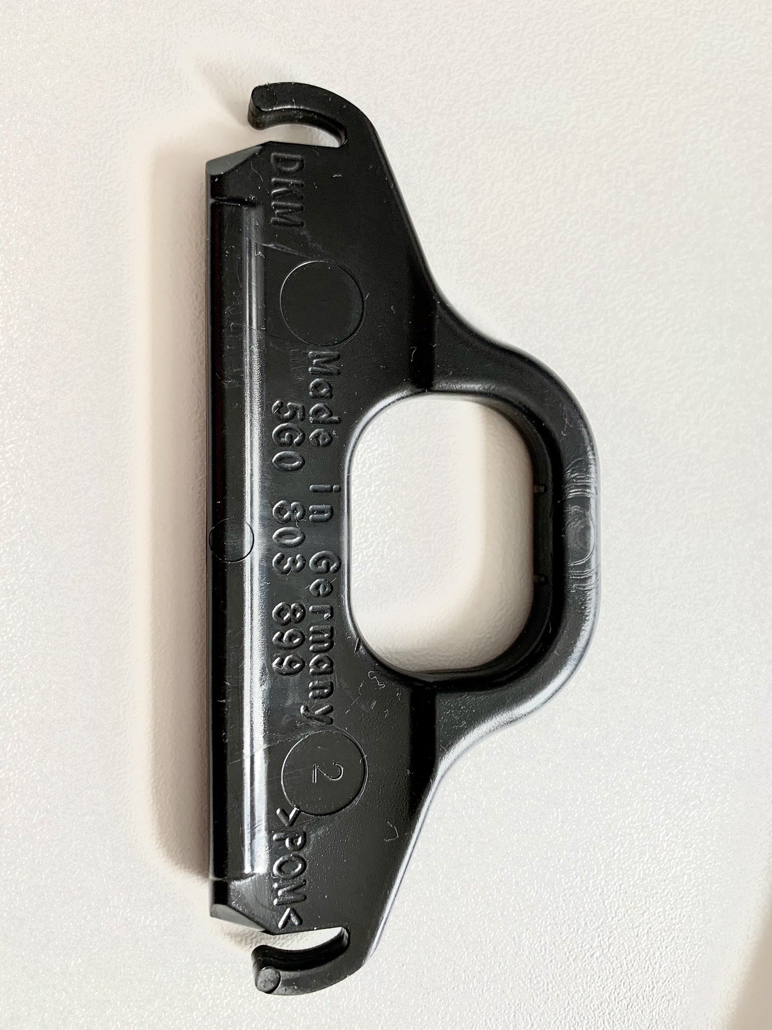

Any ideas what this is?
Found this on the floor of my 2017 Octavia Estate a while back. Googled the number but not able to locate it. Its wider than a seatbelt and quite heavy plastic.
Mk3 octy

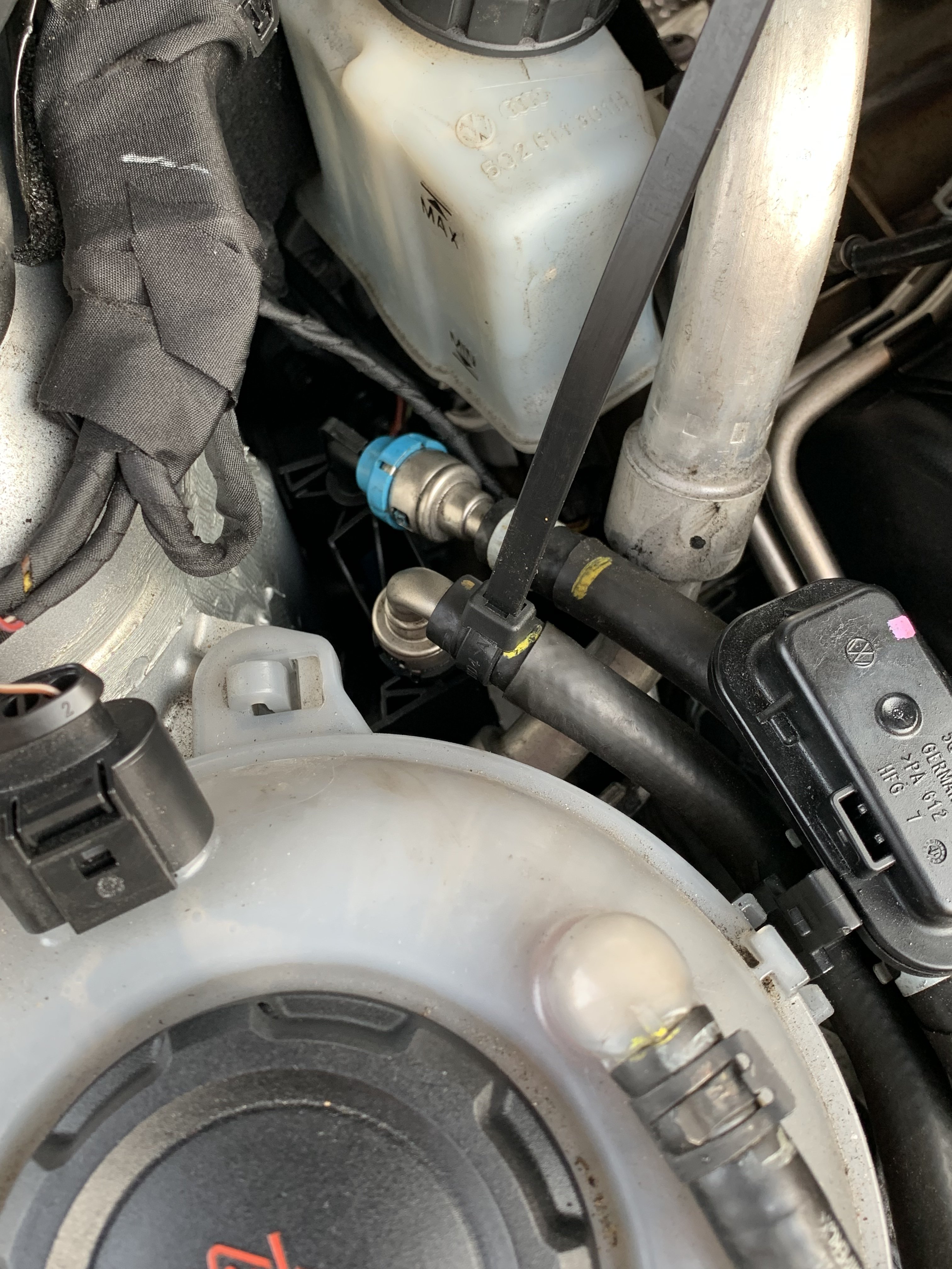

Can anyone think why the fuel pipe clip here would have been removed?
I can see the logic in this , but the service and gearbox service were both done a few months ago. I can see me asking if they left a pipe clip off a fuel pipe on a car they worked on a few months ago would be answered.... Its really to make sure I know that when it goes for next service to look at the same pipe. I wont be going back to Arnold Clark in Manchester as I am not in the area any more, but have one more service with the group paid for on a plan. No fuel treatment on the invoice.
The tail was left on as it’s a temporary repair and the metal one that would have been on is a pair of pliers to remove. The pipe next to it is fine and not rusty
There was no clip on the pipe that now has a cable tie, that was put there by the Green Flag mechanic. The normal pipe clip is a pair of pliers and pull the pipe off so it was removed for some reason and not replaced. I’m just trying to see if it’s normal to remove for service (fuel filter) or replace DSG auto box fluid.
Driving back from the midlands over the weekend, got off the dual carriageway and a really strong smell of diesel. pulled over and the pipe with a tie wrap on was off and there was fuel everywhere. Car has been in for service and then had a gearbox oil change, the pipe clamp was missing and the pipe worked it’s way off. Tie wrap was temp fix by local garage who came out for green flag. I know it’s my responsibility to check the car, but can’t really think why this pipe would have been removed ? any suggestions
