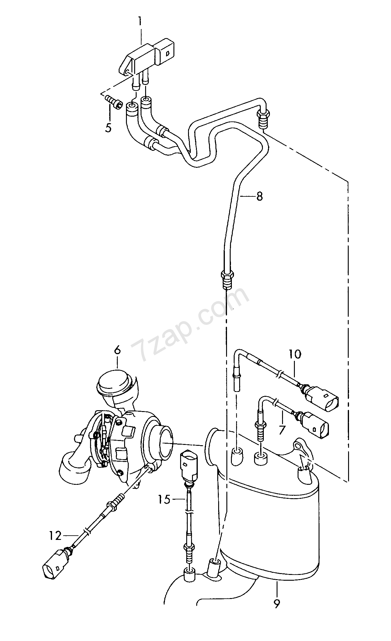

Number 15 is the one you need to replace. I’ve found out the hard way and already replaced 2 sensors 🤦🏻♂️. If you look between the turbo through the gap you can see it just about at the back middle and the connector is located in gap of the air box and engine, brown plug.

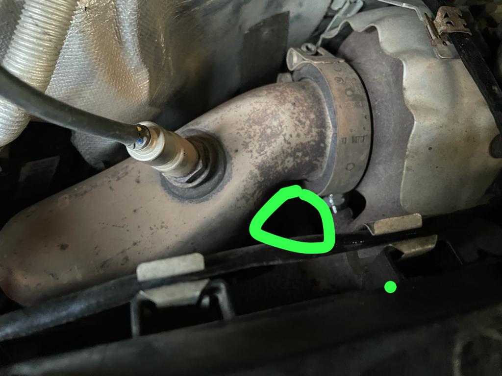

I’ve got a funny feeling the one that’s been causing the issue is buried down the back and I can even see where the plug is disconnect. I’ve got a feeling have to take off the belly pan and go from underneath as you can just about see it through the gap

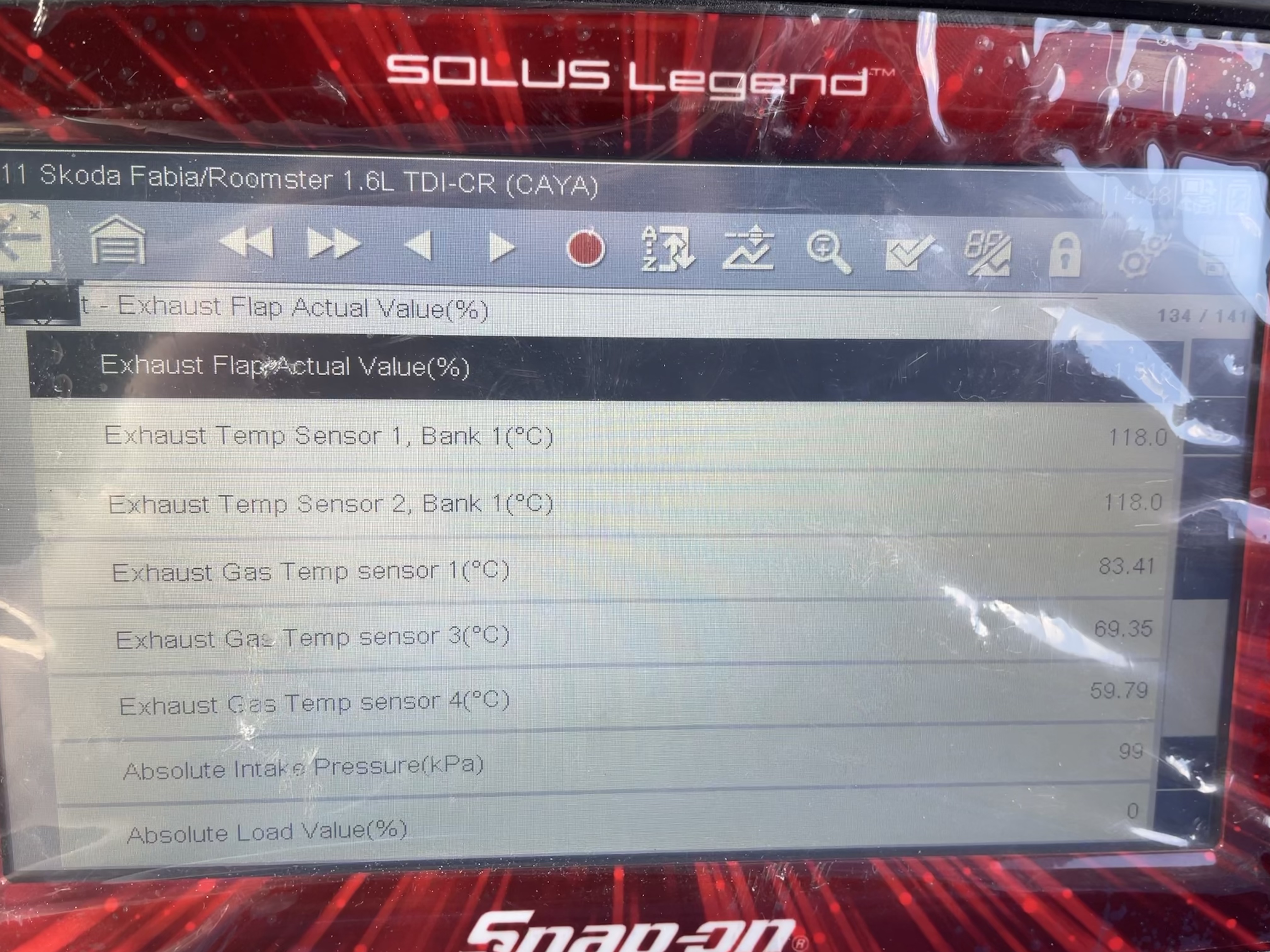

I went for a drive, plugged in diagnostic computer. Did a temp reading and the senosors was all reading fine. Nothing wasn’t showing out of the ordinary

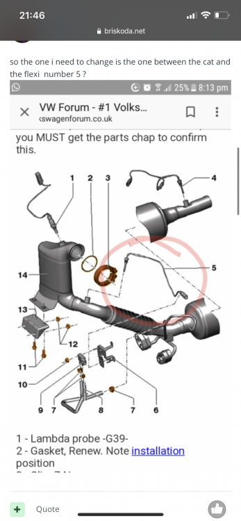

This is the only diagram I came across. This one was saying that the bank 1 sensor 3 is (number 5). Obviously is the light comes back on again then that one will be getting replaced next

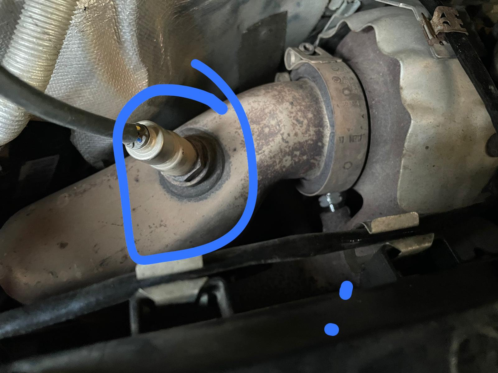

I’ve been looking for diagrams and that to see where they are. But since I’ve replaced the lambda sensor it’s been fine. I had a look when I was changing the sensor, the other sensor which I thought it could be is further down the back of the engine. You can just about see it and looks difficult to change from the top side. So where the first sensor I replaced. Look down the gap and you can see another sensor further down. Maybe it could be that one
