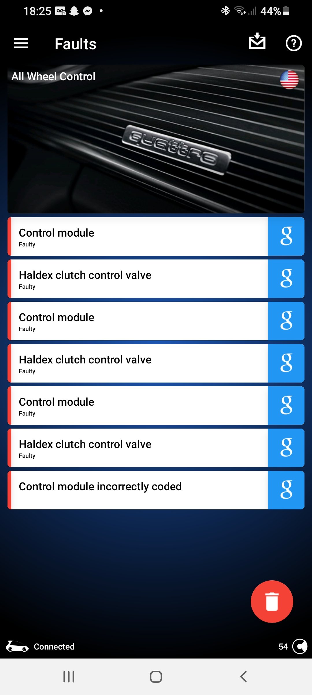

  1. Hi everyone, hoping someone can help, customer of mine has 2009 octavia scout 2.0tdi living in ireland but car originally from scotland so has had a rough life and suffering from alot of corrosion and rut underneath. Customer asked me to check the 4wheel drive as he felt it had stopped working. Their are no warning lights on dash, after scanning 4wheel drive CM these faults are present, Codes: 02248, 00003, 16347, 01044(picture attached also(obdeleven) ) Looking at faults would i be on right track saying haldex control module has failed
